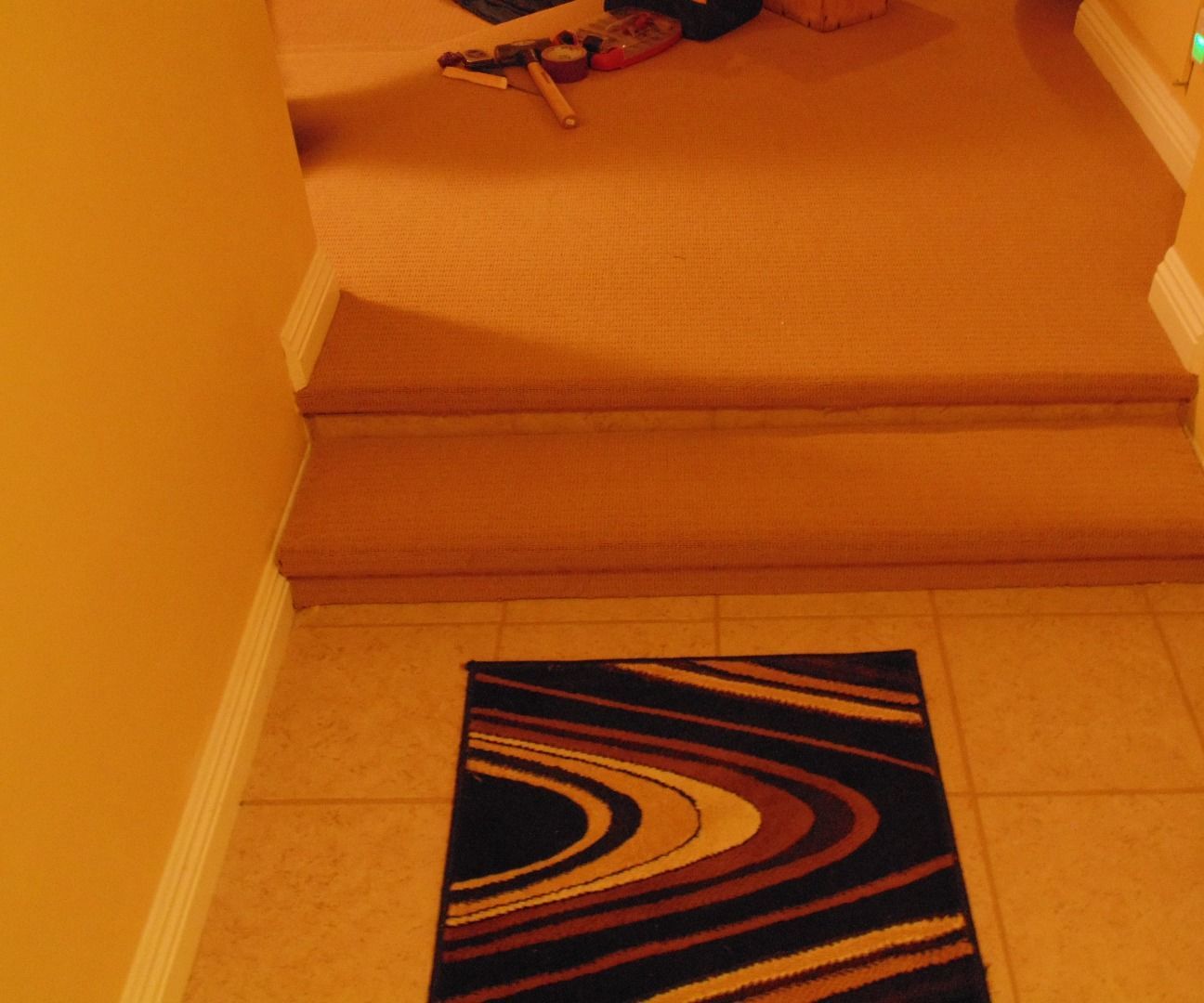

For basic dimensions and specifications, I first met with the client to discuss the project she had requested. Once there I took measurments in her house of her stair heights in her pool and her interior staircase. We then discussed various existing commercial solutions (EZ-Step, Pilot Step) and why they would not work for her and what she wanted for the end product. The dimensions in the end came out to be 9"wide by 12"long by 6" tall.
