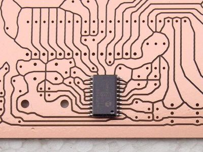

When using a CNC to produce Printed Circuits Boards, it is not always necessary to carve tracks and remove extra copper as with a photographic method.
Just separate each signal and make tracks as large as possible is faster and easier especially if your CNC is not 0.1mm accurate.
This method is also called 'Voronoïd', from the so named mathematician.

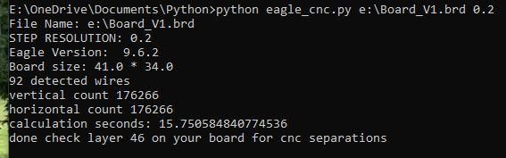

  • python eagle_cnc.py <board path> <STEP>
  • example : python eagle_cnc.py e:\board_v1.brd 0.1
What STEP means ?
STEP is the size of the grid used to make calculations (in mm or mil depending on the unit you choose for your board).
The thiner is the grid the better result you will have, but the longer the script will take to make calculation. For complex circuit, it can take few minutes, so be patient.
The script will modify the xml file containing your board (*.brd) adding dots on layer 46.

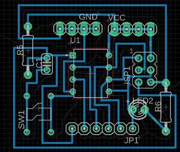

Step 3: Example

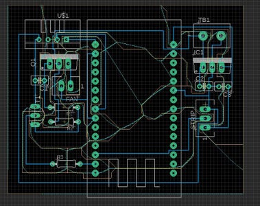

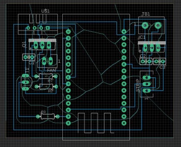

I've designed a simple board with an NodeMcu module, DHT11, connector etc ...
After applying my script, I can see my 'dot helpers' on the layer 46. Then I will use the layer 255 (routoute) do draw tracks seperations (see picture attached).
-> use a width = 0, this will help you for the cam processing

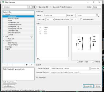

  1. Export the TOP COPPER layer

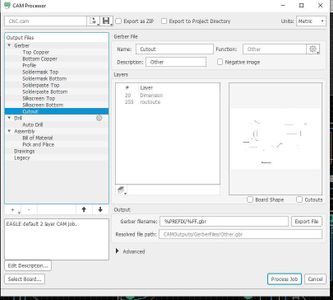

  2. Export layer 20 (dimension) and layer 255 (routoute)

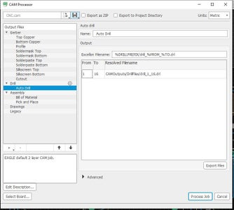

  3. Export drill file
