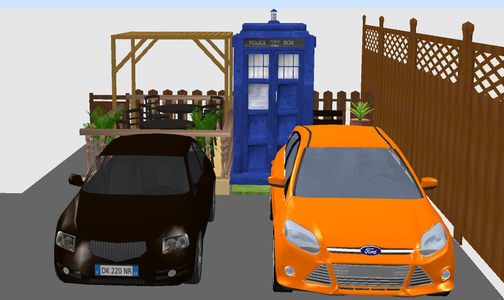

  21. Sweet Home 3D for planning

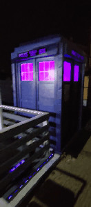

While waiting for the paint to dry over night, I decided to get to work on the roof lantern. Keeping costs low, after looking around to see what was available in my budget, I found a pair of cheap solar powered garden lanterns from an online retailer which, although not authentic to the original phone box, I thought looked the part with the right period style.
I took the light apart and gave the housing a light sanding, washed and dried, and sprayed the parts with a plastic primer. When dried, like the box I applied the two coats of Royal and one coat of Iris blue.
When dried, I replaced the original 3v warm white LED with a brighter 12v cool white LED and added some length of electrical wire bypassing the solar panel and power switch.
I reassembled the lantern, then screwed in a metal base plate to the bottom of the lantern housing so I could screw it to the roof.
SIDE NOTE: I mentioned above that I ended up having the lantern shine a blue light. I did this by removing the top of the lantern housing then cut and inserted some blue lighting gels (filter card) around the inside of the clear plastic lens cover, then replaced the top to give it the blue light.

Step 11: Final Hardware and Lighting Assembly.
With the call box shed almost complete, there were a few wore jobs left to do.
Electrics: I drilled a hole to a slightly larger diameter size to an electrical extension lead cable I was going to use, just above the base through the left hand lower side panel wall. I removed the extension lead plug, fed it through the hole, screwed the extension sockets to the back wall just under the shelf, tidied up the cable with some wire management clips, re-attached the plug and plugged it into my decking socket, then finally added a blob of clear silicon sealant to the drilled hole to waterproof it.
Lights: I converted an old solar light to run off a mains adapter, similar to what I did with the lantern, by taking apart the light, removing the rechargeable battery and connecting/insulating some electrical wire directly to the LED light panel, then re-assembled the light. I screwed the light to the inside of the roof, joined the light cable to the lantern cable, then joined them to the power adapter cable. I neatly traced the wires, set the correct voltage on the variable voltage power adapter and plugged the lights adapter into a Wi-Fi smart plug then into the extension lead socket. Finally using the smart plug app, I set a timer to switch the lights on at sunset and turn off at midnight.
Just for a bit of fun, I also purchased a cheap and cheerful mains powered mini disco light ball that slowly rotates with a choice of lighting pattens which looks pretty cool at night and mainly used during festive holidays and special occasions. I simply connected this to another smart plug socket like the main lights.
SIDE NOTE: I just wanted to mention that I was pleased I painted the inside of the call box silk white because I was very pleased with the end result when I first saw it lit up at night for the first time. The signs were clear and visible, and the windows gave a nice “active” look making for a nice garden light feature. One thing I may do it to add some 10mm black vinyl adhesive striping on the inside of the window panelling effect simply because when the call box is light at night, the white outside panelling looks a bit washed out as the light shines through that a bit too. So adding the inside black stripes should help visually define the panelling much better.
Tool Hooks: I used seven spring loaded garden tool hooks on the right hand side wall panel batten (that seals the lower and upper wall panel joins), evenly spaced to store my garden rakes, spades, brooms etc.
Door Locks: Instead of installing a Yale type key lock much like what the original call boxes used, I opted for a simple lockable latch fitted to the outside of the doors. And just to help identify what key belonged to the lock, I attached on key to a tiny little call box “TARDIS” key ring just for the fun of it. I also installed upper and lower latches to the inside of the left door so this door would stay closed when I only needed access through one door.
Door Handles: Throughout my research, I never figured out exactly what style door handles were used on the original call boxes, but evidently as different boxes varied a little in style aspects, it’s feasible to say that the door handles may had been different too. So I found a pair of chrome plated door handles that had an early 20th century look, and fitted one handle to the outside and the other to the inside of the right hand door.
Door Signs: I originally looked at making my own, but decided to treat myself and purchased the two door signs as they were inexpensive, the correct sizes and looked just like the original signage used from what I’ve seen in historic photos. The larger ”Police Telephone” sign was metal, so I drilled some small holes in each corner and screwed it onto the left door. With the round “St Johns Ambulance” sign which had adhesive tape applied to the back, I cut a same size circle out of some PVC sheet, screwed it onto the right door, then attached the sign… which marked the end of the actual Early 20th Century British Police Public Call Box Garden Tool Shed build.
