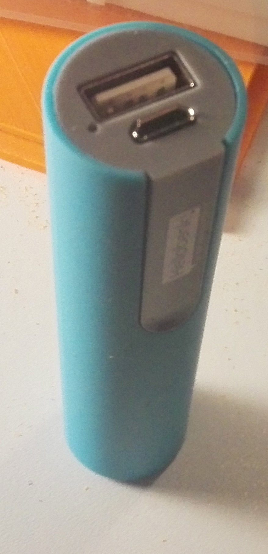

Step 6: Power
Now it's time to get some external power into our Arduino and circuit. For this part, I used a powerbank. I found it usefull to use something that can be re-powered.
To make this work, you'll need 2 USB cables and a switch, so you can turn your project off. This way, it won't use up the power of the powerbank the whole time.
The first USB cable I've just made shorter, so it will fit in my case. I've reconnected the black and red wires using a screw block. Tis USB cable will be used to power up the powerbank, and will be connected to the micro-USB of the powerbank. The other side of the cable will be used to plug into your computer or a power point to power up the project (the powerbank actually).
The second USB cable, we'll use to get power to our circuit. We'll add the switch to this one. Go ahead and cut the USB cable to the desired length, And connect the black cables with each other. The red cables, you each need to connect with one side of the switch. This cable will be connected with the normal-sized USB port of the powerbank on one end, and with the Arduino Micro on the other end. If you are using an Arduino Uno, you'll have to do this another way.
Afterwards, I secured the connections using some hot glue.

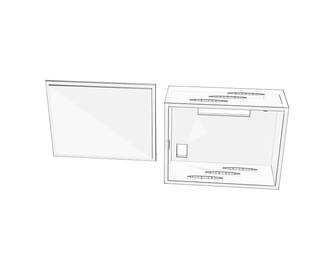

Step 7: Make a Case
Next, you can draw a case to your likings. I made my case using a 3D printer, but you can also make a wooden case using a lasercutter.
If you want to 3D print your case and you haven't got any skills in 3D drawing, I recommend using Tinkercad. It's opensource, online, and extremely easy to use. They also have a ton of tutorials you can follow.
I've also provided the file for my case, which you can get to the proper format using the program 'Cura'. Note: the lid on my case is too big and won't fit, so you'll have to re-draw that one. Also the opening for the micro is a little bit too small. I personally fixed these problems using a small drill and some sanding paper, because I didn't have time to re-print everything.
Step 8: Put Everything Together
It's tricky to get everything in this 'small' case. I did it by putting the microphone through the round hole first. Then I put my LCD through the big hole, and my toggle switch through the other hole. Then I put the USB cable through, and fitted the rest in.
Next, I put on the lid and tadaah!
