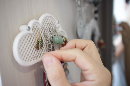

Step 2: Cura Hack: Using Infills to Create a Mesh
How do you model a mesh with all the teeny tiny holes in it? Well, you don't! Basically I used the 'infill' function of my slicing software (Cura) to create the mesh for me.
The principle is this: create a solid flat shape and export it to a slicing software such as Cura.
Cloud Model
Basically just draw the desired shape in Sketchup, extrude the border to a thicker height, eg 4mm. This is for rigidity. The centre part of the cloud is also extruded, but only to a thickness of about 1.5mm. This is so that the mesh is thin enough to hook through.
I also tapered the edges and added 2 screw-tabs for installation.
Print settings:
Walls: 10 shells - this will create a 4mm thick solid border if you use a 0.4m nozzle
Top and Bottom: 0 shells - this exposes the infill created by Cura
Infill: diamond pattern, 15% - This creates the diagonal mesh pattern shown above. You could also use can also use hexagon infills, and play around with the percentage to get different mesh sizes.
Step 3: Cloud Installation
I printed a few clouds in various sizes, using the same STL. By scaling it uniformly in X and Y directions in Cura, I got different sizes of clouds, without changing the scale of the mesh! Great hack.
I printed simple cylindrical spacers so that the cloud would sit 1.5cm away from the wall. This gives clearance for earring hooks to pop through the mesh.
The whole lot is just screwed on to the wall with 2 screws as shown. The screw placement was designed to be as unobtrusive as possible.

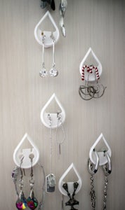

Step 4: Raindrops Keep Fallin'
So the clouds worked great for hook-type earrings, but that left my wife's stud earrings with no home.
Enter the earring raindrop! I created 2 types: Either a single pair or double pair of slots.
These are very lightweight, so just hot-glued them to the wall with a spacer.
Earrings just slot in as one piece from the top, without having to fiddle with the clasp end at all!
