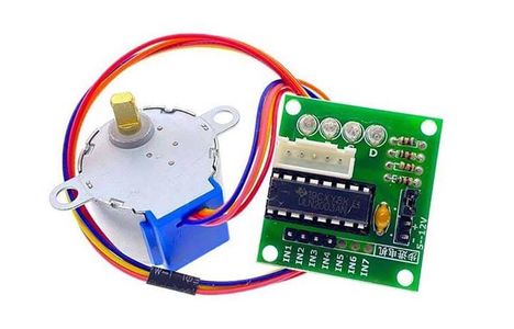

2x stepper motors
2x arduino uno

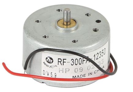

1x mirrorball motor ( AC )

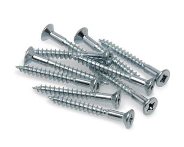

screws

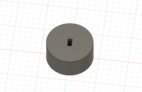

Step 1: 3d Print
https://www.printables.com/model/265248-ratchet-toothpaste-tube-squeezer/files

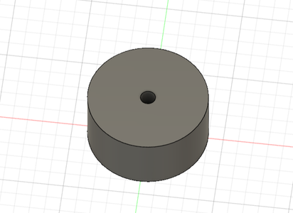

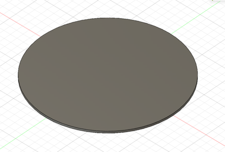

3d print:
  1. 2x toothpaste squeezers
  2. 2 circles that fit onto toothpaste squeezers and motors
  3. 20cmx3mm circle
  4. 1x circle1
  5. 2x switch box

glue small circle onto big flat circle

Step 4: Drill & Screw
drill 3mm hole in the toothpaste squeezers and screw on the frame
screw both the motors on the frame

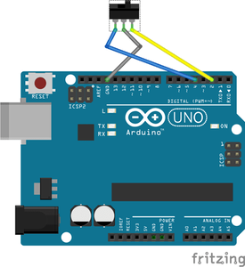

Step 5: Wiring
connect the stepper motors and switches
combine these two on one arduino
Step 6: Coding
this file is the coding for the stepper motor and switch
