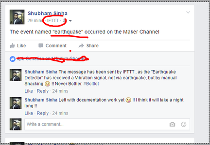

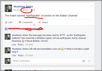

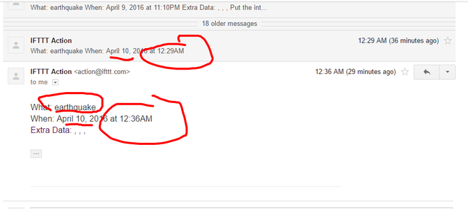

Step 5: Notification After a Fake Eartquake (Manual Vibration)
The picture shows the notifications that we received on facebook and gmail after the manual vibrations detected by vibration detector.
