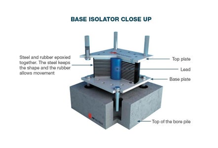

Base isolation systems are very important to ensuring people actually survive an earthquake, even if the building remains intact. Base isolators are placed and connected below the foundation of the building. There are many types of base isolators, however the one I have decided to include in my building are elastomeric bearings which move and stretch with the movement of the tectonic plates to ensure everything above in the building does not move. (example video above)
The video above showcasing how base isolators work, the different types and the consequences of not having them.
I also decide to use a slab foundation for my design as they provide a very stable base for my building.

Step 5: Designing Base Isolators
Using Inventor and an example of a base isolator, I designed a base isolator and converted it to a revit family to put in my model. The colors in the Inventor model correspond to the materials someone would need to build the isolator out of.
