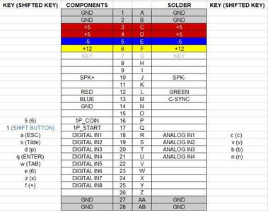

CLASSIC ONE PLAYER CABINET, JOYSTICK + 4 BUTTONS CPO
This is probably the more common case. Arduino emulates a keyboard and send key presses as per attached key map. When a button is pressed, the corresponding keypress will be emulated. "Start" button (jamma fingerboard pin 17) acts as "SHIFT" button: if you press a button while keeping "start" pressed, a different keystroke will be emulated. This is very useful to trigger those functions you do not use while playing, such as menu opening and diving, quick addition of a credit, etc.
The frequency check function is ongoing all the time in the attached sketch. If you have a simple design where out of frequency sync signals are relegated to the PC boot time, you can think at limiting that check for the first few minutes, up to the first detection of a "good" frequency, or set a defined time after which the video amplifier gets enabled. This will reduce the microcontroller load and speed up the whole loop execution.
You can further speed up things by limiting the buttons to those actually used. "Customizable" is the key word here, remember? ;)
