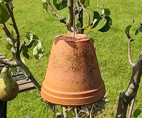

Step 7: Attract Earwigs and Hang the Pot
Now place the earwig pot on the ground in a place where you expect earwigs.
Leave it for a few days and then hang it in a tree.
Earwigs will like to use it, but other insects also find it a nice shelter. In that sense it is also an insect hotel.
The earwigs will now look for lice, mites and eggs of other pests.
