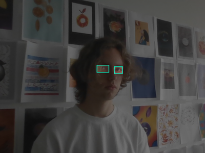

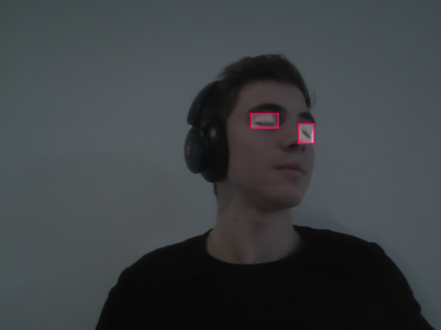

Step 1: Collecting and Labeling Eye Dataset
I collected a dataset of people’s faces using a Python script which asked subject to have opened/closed eyes randomly (for better balancing), managing to capture a variety of angles to cover more edge cases. Eyes in the images were labeled with two classes: opened_eye and closed_eye. I used Roboflow for labeling, as it has a relatively easy-to-use UI.
There are 128 images in total: https://app.roboflow.com/easeup/easeuplabeling/browse

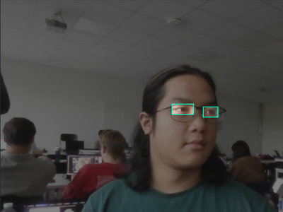

Step 3: Training YOLO Model
First, I trained models directly on Roboflow, but when I realized my dataset was enough for good precision, I wrote a short script for local training and ran it for 200 epochs.
I used brightness augmentation, as it's the most common issue I noticed. To increase model speed, I resized the images to 320×320 pixels—this boosted performance to 17 FPS on a Raspberry Pi, compared to just 5 FPS with the standard 640×640 resolution.
All images were in grayscale to avoid color bias, which is irrelevant for eye detection. I used YOLOv11n for its speed, since the detection task was simple but needed to be fast.

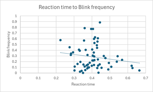

Step 4: Finding Blinks/fatigue Relation
Remember the tiredness data we collected earlier? Now that the detection model is ready, it's possible to extract blinking frequency from each video and correlate it with reaction time.
I wrote a script that counts the number of opened and closed eyes per frame and assigns a label to each frame based on the majority class. It then detects falling edges (when frame x−1 shows open eyes and frame x shows closed eyes) and filters out any that are isolated (i.e., only one closed-eye frame in a row). Finally, it divides the number of valid blinks by the video length to get the blinking frequency.
After collecting this data for each video, I plotted "reaction time" vs. "blinking frequency" and got a scatterplot. While there is a general correlation, a more noticeable pattern emerged: when reaction time is low, blinking frequency becomes inconsistent. However, around 0.3 Hz, this "randomness" starts to disappear. I used this 0.3 Hz threshold as the tiredness cutoff in the later stages.

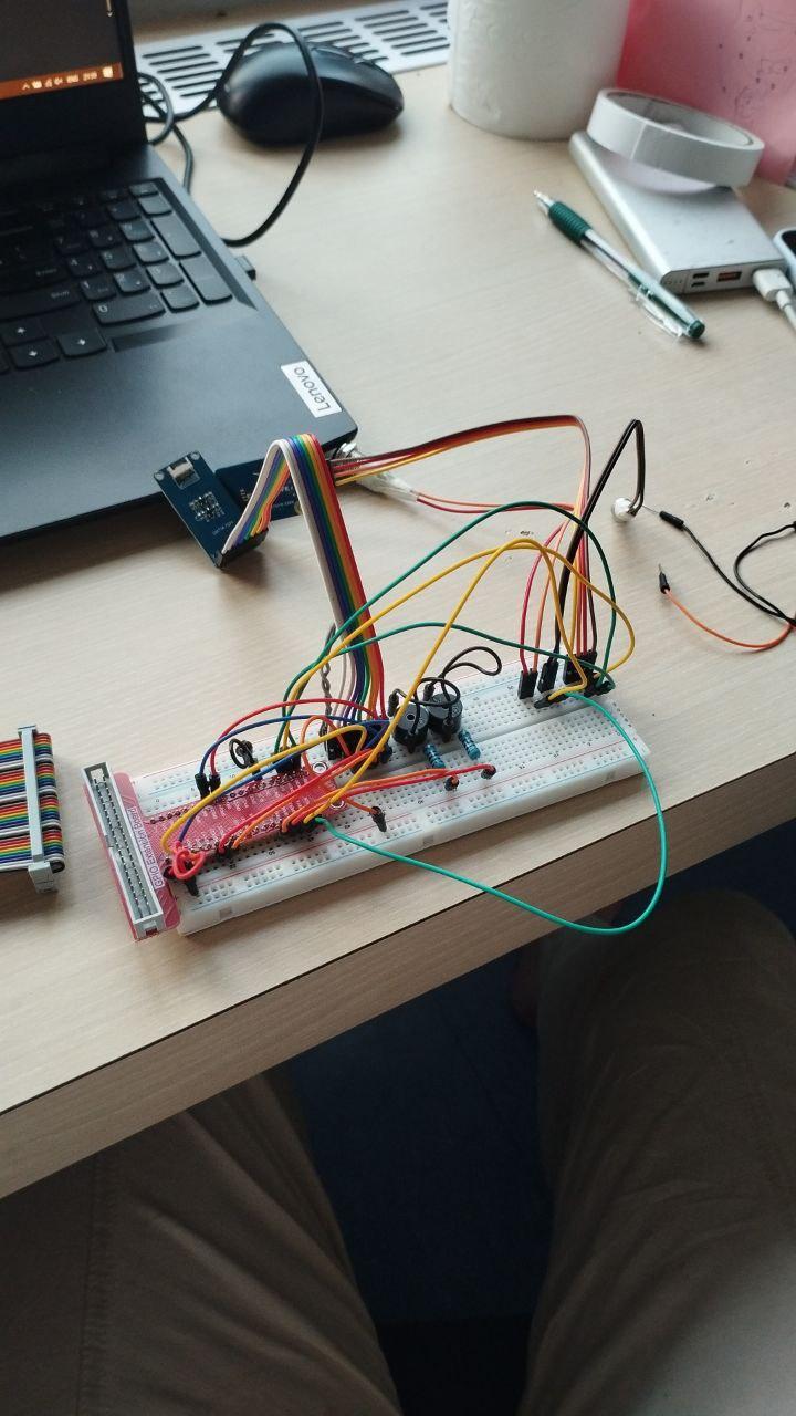

For testing, I built the whole setup on a breadboard first.

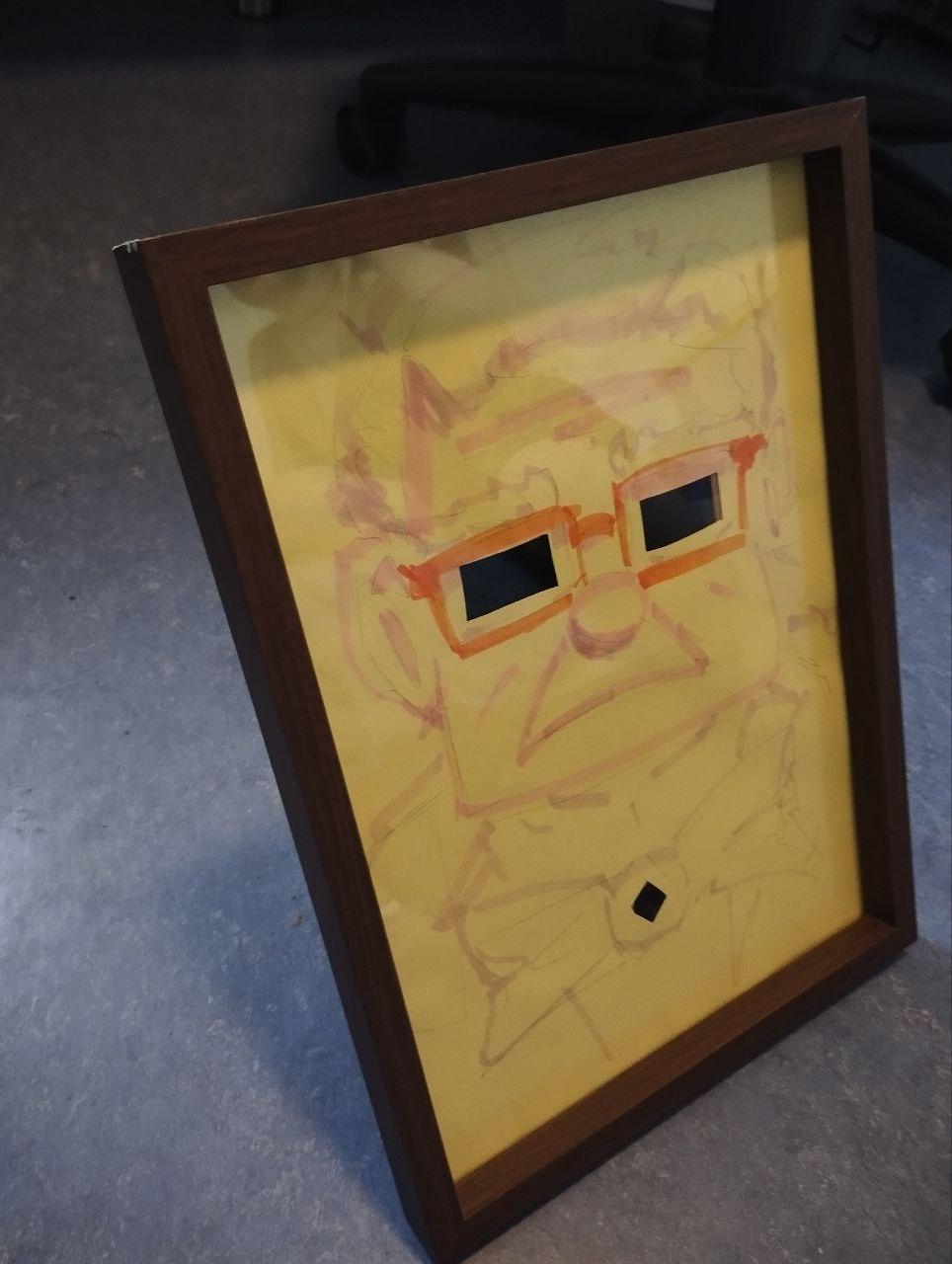

Step 7: Building the Box
For the casing, I used a simple laser-cut triangular box, combining it with a picture frame for the design. I made three holes in the frame - two for the LCDs and one for the camera. The back wall isn’t glued - it can be opened.
