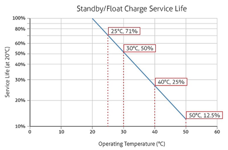

As you might know, Lipo battery as well as LiIon are great, they provide a lot of power, they can have big capacities and they're also small for how much energy they contain (think about she smartphone's one) but...
When you are not going to use it it's better to store them in a normal temperature room (not too cold like a garage and not too hot like near a radiator).
Then, to let the battery provide all of its ampere-hours for as long as possible, you have to keep it with the battery at 50%.
