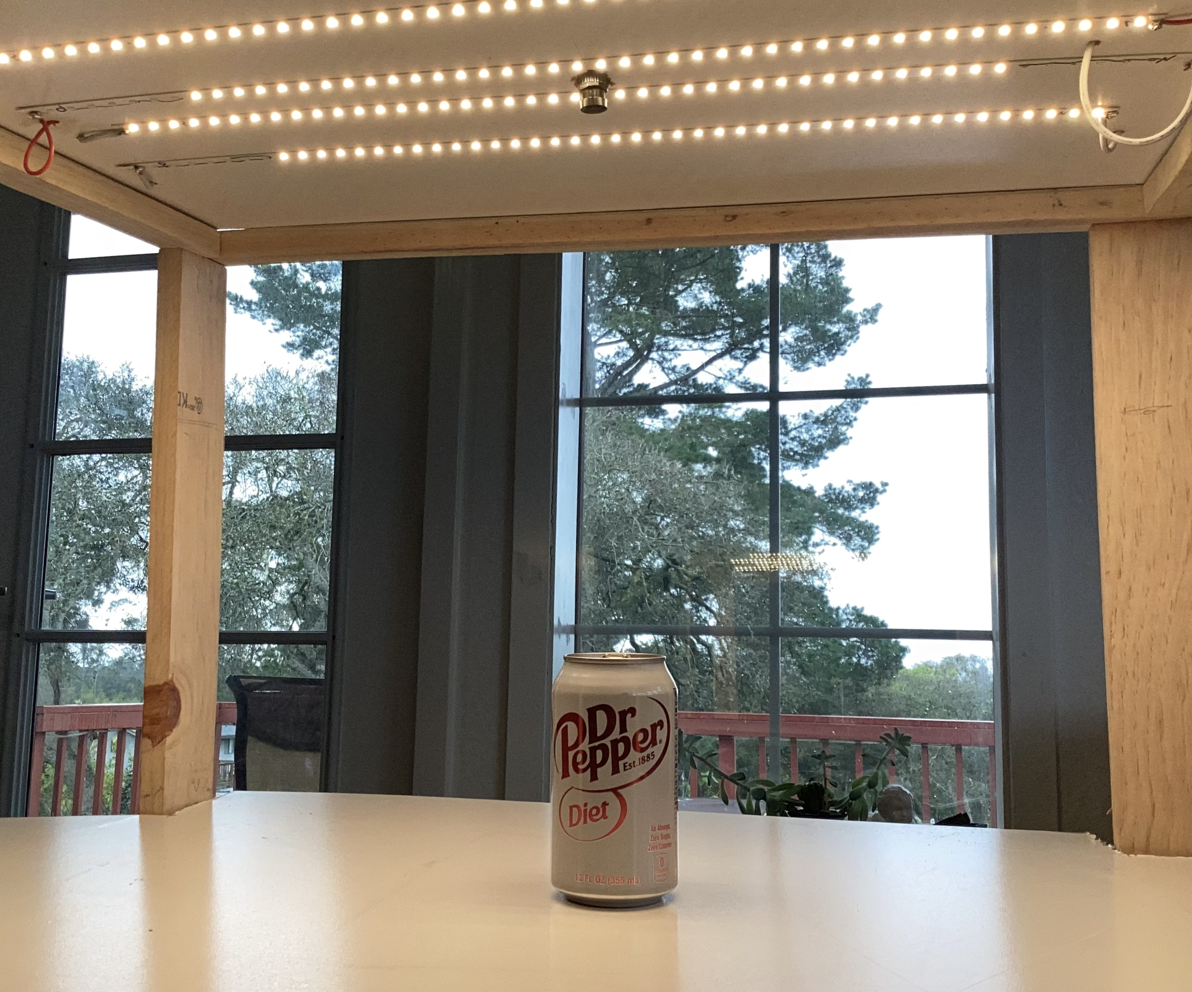

Step 2: Building
Before we start coding, we need to make a wooden box to place the plastics and cans or whatever your objects are on top of as well as a place for the camera and all the other components.
Here is the schematic of the design with measurements in inches, all labeled:
