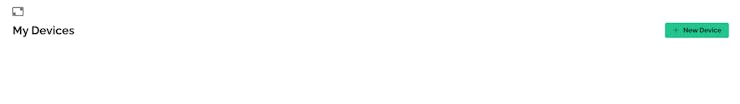

  • Create a Blynk account at blynk.io
  • Create a new device on your dashboard as follows:

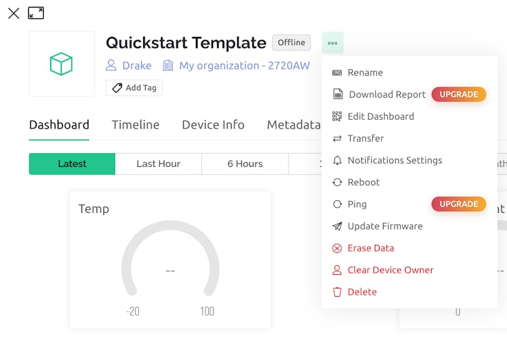

  • You can select Template > Quickstart Template
  • Save the information they give you, you will need the Auth Key in your MicroPython Code
  • Edit the dashboard from the dropdown

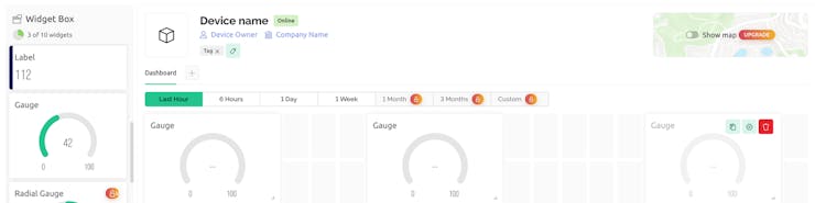

  • Delete the dashboard components and drag and drop three gauges from the Widget Box.
  • Edit the three Widget Boxes respectively with titles Temperature, Humidity, and Pressure. You can create a new Datastream for each one and select a unit and Virtual Pin. I selected virtual pins 7, 8, and 9 respectively for my Gauges. You can alter the max and min values and other properties.
