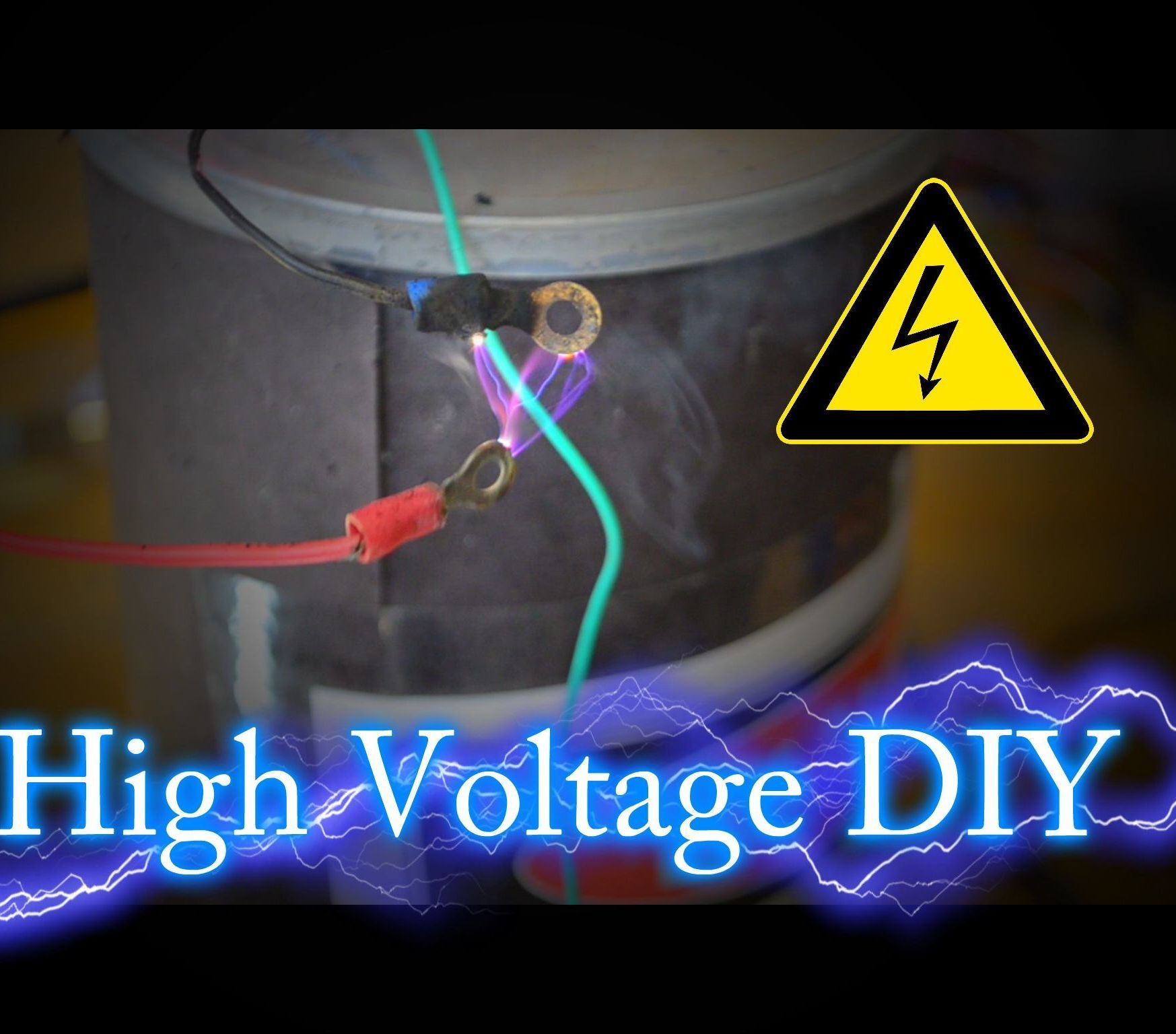

The shiny red wired are the high voltage. The red wire is the positive and the green is the negative. That's all for that, so let's get started!

Refer to the circuit above if you need, put the switch in series with one of the terminals for the 9v battery, next connect the positive side with the boost converter and the negative side with the boost converter, solder connections
Step 8: Finishing Touches
Okay now your circuit is compleat !! Go ahead and tuck the wires into the open credits on the converter, and apply so,e hot glue, position the momentary switch and the flat side of the converter.
Now that you have done that, wrap the project in electrical tape, and your good to go!!
