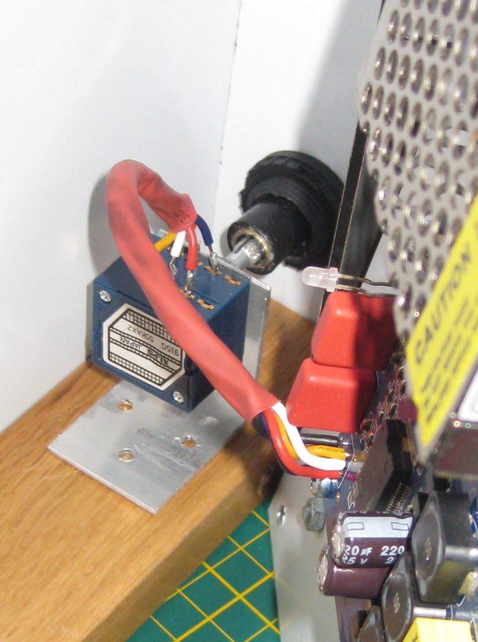

Because the amp PCB had the volume pot on board I had to remove it so I could mount it on the from panel of the enclosure. Unfortunately the pot broke whilst I was desoldering, fortunately I had a spare. it was bigger and as it turned out easier to fit. I soldered lead wires to the new volume pot, soldered wires to the RCA plugs and speaker binding posts, attached wires from the mains plug to the power supply and switches.

Next I cut up the black switch to become a volume knob, I found this particular type of switch didn't come a part.
So using a pen lid and shaping it to fit the inside of the switch and a small volume knob that fitted in the other end of the lid I was able to hot glue the assembly together to give my what I needed.
An aluminum bracket was made for the volume pot and the assemble was screwed into position.
