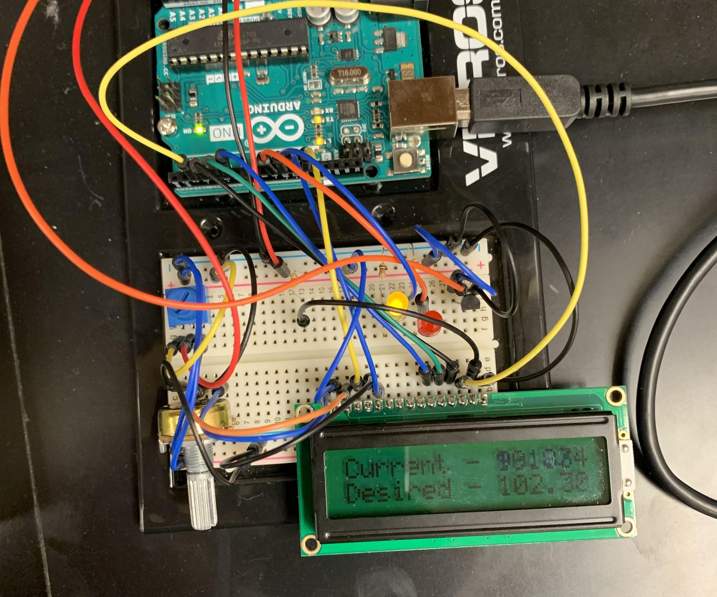

Introduction: Easy Arduino Battery Tester
This is a simple circuit made with a Arduino Uno making a battery tester that returns a battery charge value to the computer.

Step 1: Build the Circuit

Step 2: Write the Code
int value =0; // the "charge" of the battery
void setup() {
Serial.begin(9600);
pinMode(11,OUTPUT);
pinMode(10,OUTPUT);
pinMode(9,OUTPUT); // sets the pins to either output or return values
pinMode(A0,INPUT); }
void loop() {
value=analogRead(A0); //reads the battery value from A0
Serial.println(value); //prints the battery "value" to the computer
if (value>=290) //if the charge is high it turns the light green
digitalWrite(11,HIGH);
digitalWrite(10,LOW);
digitalWrite(9,LOW);
} else if (value>=180 && value<=289) //if the charge is in between the two values it turns on the yellow light
digitalWrite(10,HIGH);
digitalWrite(11,LOW);
} else if (value<=179) //if the charge is low it turns on the red light
digitalWrite(9,HIGH);
