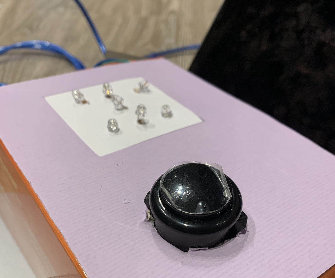

Step 5: Decorating Your "Decision Maker"
To decorate your "Decision Maker," you can choose to download my printouts, or create your own!
My topic is focusing on "What To Eat For Breakfast," if you want to print it our, the document is available below.
Now, you will have to find a box that fits your breadboard and Arduino ( any box that fits your breadboard and Arduino will be fine). Cut your box open and poke some hole on the top of your box so that the photoresistor and the LEDs are able to be seen. Cover the top of your box with some colored paper and glue on the pictures you just printed out. Use crocodile clips to intend your LEDs and photoresistors so that they appear on top of the box. You can also use plastic corrugated fiberboard if needed. Glue your box together after everything is set. Be creative with your decorations!
