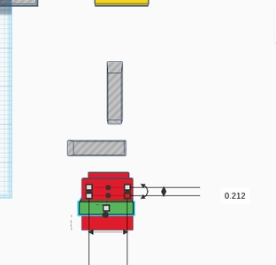

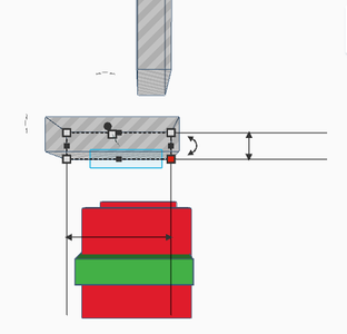

3d printer and my file, make sure your 3d printer is accurate enough, or we have to adjust the width and length of all plugs(like in the picture shown), because most 3d printers actually print the piece a little bigger than the file described.

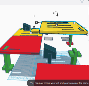

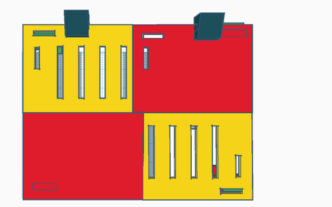

print 2 of each plate(red and yellow), 4 cross structure(green ones) and two block with incline(black ones)
Step 2: Assemble It

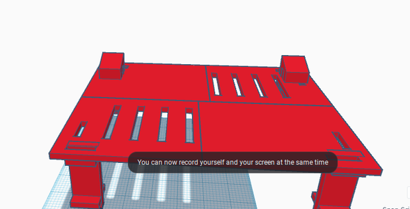

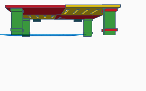

assemble the hollow plate and the solid plate,then plug the two assembled plate together, then plug in the cross and the inclined block, the finished stand should seem like this
