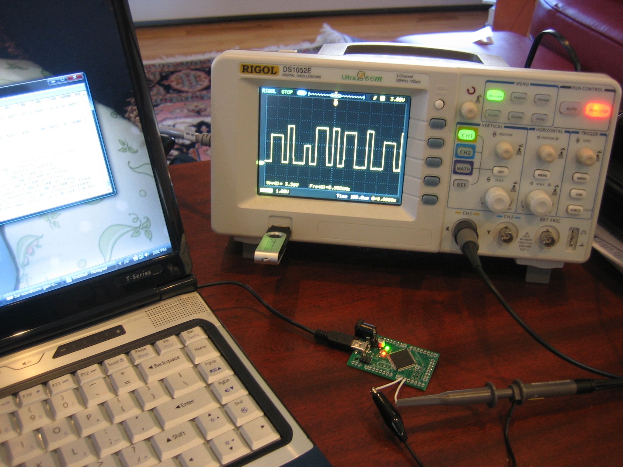

Introduction: Easy Atmel Xmega Sine Wave / Waveform Generator
This is how you can use one of the BostonAndroid.com Xmega evaluation boards ($20) to create a simple adjustable sine waveform generator with 12bit resolution and capable of producing frequencies from 125Hz - 20KHz using the integrated DAC. You can modify the code to produce any arbitrary waveform at up to 1MHz on 2 channels. You need only a PC, an eval board and a suitable Atmel programmer (AVRISP is under $30 new).

To create an adjustable waveform generator we will use a simple resistor voltage divider to be read by the Xmega on board 12bit ADC. This value will then be used to set the frequency of the DAC sine wave frequency but the following formula:
reading = (Vin/1.6V) * 256
freq = (reading * reading) + 1;
By adding an adjustable 3pin Potentiometer to PortA on the XMega-Eval01 we can create this simple voltage divider. You can also feed in your own voltage source between 0-1.6V to do the adjustment instead.
The waveform is output from the DAC with 50 samples per cycle at 12bit resolution from PORTB pin2. Pin1 is setup as ground reference.

Step 8: Use Device!
Connect an Oscilloscope (or freq counter, or high impedance speaker like a headphone speaker) across PORTB pins 1 & 2. You should see a sine wave of 3.3V p-p amplitude. Adjust the potentiometer clockwise to increase frequency from 125-20KHz. Turn counter clockwise to decrease frequency.
