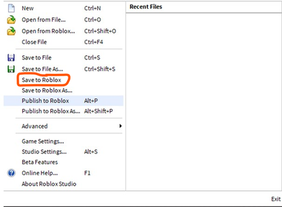

Now you're going to click "File" -- circled in orange
A drop down menu will appear.
Step 3: Setting Up Your Game (Part 3)
Now click "Save to Roblox as..."

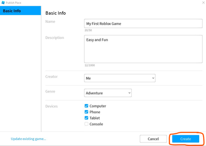

This will pull up a window that says "Basic Info"
Step 4: Setting Up Your Game (Part 4)
Fill out all the info and click create.
Do not select the "Console" box.

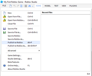

Click "File" in your game again, but this time click "Publish to Roblox" on the drop down menu.
Nothing will appear to happen.

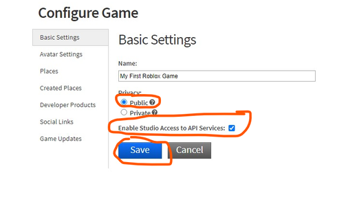

1. Go to Roblox home website: https://www.roblox.com/home
2. Go to "create" -- circled in orange
3. Find the game you made in "My creations" and click the gear with the arrow next to it -- Circled in orange
4. Click "Configure Game" in the drop down menu
This will bring you to a "Configure Game" page
Step 7: Setting Up Your Game (Part 7)
Once you’re there, change settings to public and enable api services, then hit save.
Now you can go back to your game.
Step 8: Saving Your Game
As you work on your game you are going to want to save it so your work isn’t erased.
You can do this by clicking "File", and then clicking “save to Roblox”

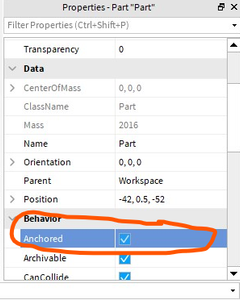

Step 11: Anchoring
Also you want to make sure all the parts you put in your game are anchored which you can do by scrolling down in the properties and selecting anchored.
make sure to do this to ALL of your parts in your game (including tower)

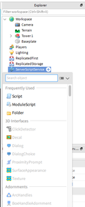

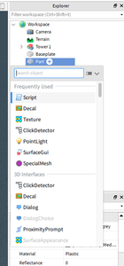

So to make a leaderboard go to "serverscriptservice" in the "explorer" box on the left of your screen. Hover your mouse over "serverscriptservice" and you will see a small + sign.
Click on that plus sign and a drop down menu will come up. Now click "Script" in the menu. And it will lead you to a blank script.

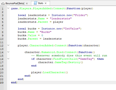

Step 14: Make a Leaderboard (part 2)

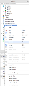

Then rename the script to “Stats” by right clicking on the script.
Step 15: Make a Leaderboard (part 3)
Enter this script into the blank "Stats" script:
game.Players.PlayerAdded:Connect(function(player)
local leaderstats = Instance.new("Folder")
leaderstats.Name = "leaderstats"
leaderstats.Parent = player
local bucks = Instance.new("IntValue")
bucks.Name = "Bucks"
bucks.Value = 0
bucks.Parent = leaderstats
player.CharacterAdded:Connect(function(character)
character.Humanoid.Died:Connect(function()
-- Whenever somebody dies this event will run
if character:FindFirstChild("GameTag") then
character.GameTag:Destroy()
end
player:LoadCharacter()
end)
end)
end)

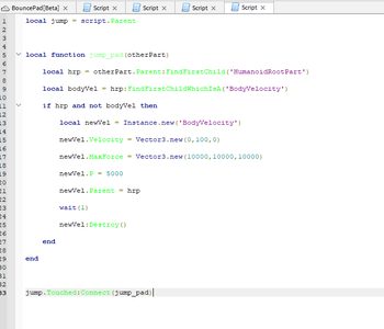

Step 17: Bounce Pads (part 1)
1st add a part at the bottom of your tower, but don’t cover the bottom fully.
Step 18: Bounce Pads (part 2)
Click on the part you added and it will show up as blue in the explorer. Hover your mouse over it and add a script the same way that you did to the "serverscriptservice".
This will take you to a blank script.
Step 19: Bounce Pads (part 3)
Enter this script into the blank script:
local
jump = script.Parent
local function jump_pad(otherPart)
local hrp = otherPart.Parent:FindFirstChild('HumanoidRootPart')
local bodyVel = hrp:FindFirstChildWhichIsA('BodyVelocity')
if hrp and not bodyVel then
local newVel = Instance.new('BodyVelocity')
newVel.Velocity = Vector3.new(0,100,0)
newVel.MaxForce = Vector3.new(10000,10000,10000)
newVel.P = 5000
newVel.Parent = hrp
wait(1)
newVel:Destroy()
end
end
jump.Touched:Connect(jump_pad)

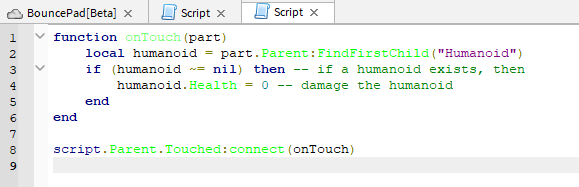

Add a script to this part
Step 27: Obstacles (part 3)
Enter this code:
function onTouch(part)
local humanoid = part.Parent:FindFirstChild("Humanoid")
if (humanoid ~= nil) then -- if a humanoid exists, then
humanoid.Health = 0 -- damage the humanoid
end
end
script.Parent.Touched:connect(onTouch)
Step 28: Obstacles (part 4)
First test to see if the killpad you just made works: just step on it, and if you die it works.

Step 29: Publish Your Game
Now to publish your game, go to file and Select “Publish to Roblox”
