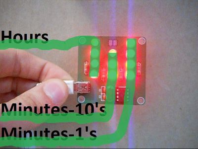

Step 6: Power, Case, Read & Set
As soon as the board is powered, all the LEDs will flash, then the clock will set to 12:00 and start measuring time. After a minute it will read 12:01 and so on.
To set the clock touch the sensor. After 5 seconds the clock will begin to advance time. After the minute ones are cycled through, the minutes tens are cycled and finally the hours. When you remove your finger the advance will stop and the clock will hold the time. Set the hour first, then the minute tens and last the minute ones.
