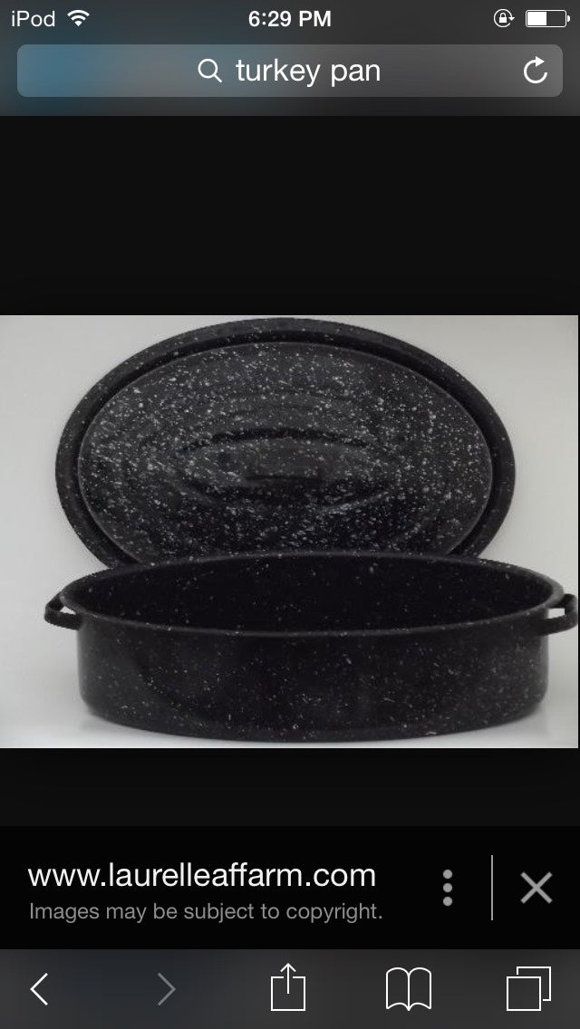

Step 2: Body/hull
I made the body from a turkey pan, a big pan basically
