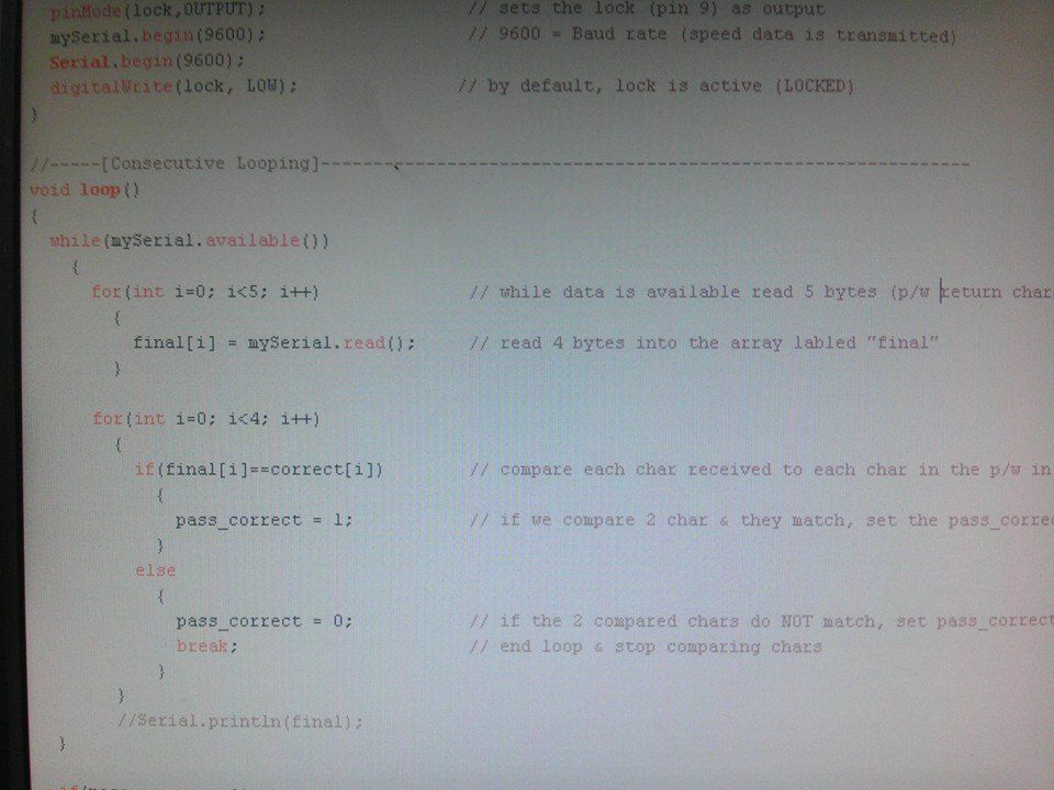

Step 6: The Code
The coding is a little tricky as I said in the intro, but I am a bit of a beginner with the Arduino so it should not be difficult for anyone to understand. Basically the Arduino will check to see if anything is being received through serial. If it is, it will read those chars into an array and from that point verify that what was received matches the password we defined. In my example the password defined is ABCD.
int lock = 9; //pin 9 on Arduino
char final[4]; //Characters the Arduino will receive
char correct[4] = {'A','B','C','D'}; //User-Defined Password
int pass_correct = 0; //Does Password match, 0=false 1=true
void setup()
pinMode(lock, OUTPUT);
Serial.begin(9600);
digitalWrite(lock, HIGH); //By default, lock is active(locked)
void loop()
while(Serial.available())
for(int i=0; i<4; i++) //While data is available read 4 bytes
final[i] = Serial.read(); //Read 4 bytes into the array labled "final"
if(final[i]==correct[i]) //Compare each char received to each car in our password in order
pass_correct = 1; //If we compare two chars and they match, set the pass_correct variable to true(1)
else
pass_correct = 0; //if the two compared chars do NOT match, set pass_correct variable to false(0)
break; //End loop and stop comparing chars
if(pass_correct==1) //If all chars compared match, deactivate(unlock) the lock for 5 seconds
Serial.println("Unlocked");
digitalWrite(lock, LOW);
delay(5000);
Serial.println("Locked");
pass_correct = 0;
else
digitalWrite(lock, HIGH); //Else if there was not a complete match, keep the lock high(locked)
/* FOR TESTING
Serial.print(final[0]);Serial.print(final[1]);Serial.print(final[2]);Serial.print(final[3]);
Serial.print(" | ");
Serial.print(correct[0]);Serial.print(correct[1]);Serial.print(correct[2]);Serial.print(correct[3]);
Serial.print(" ");
Serial.print(pass_correct);
Serial.println("");
delay(500);

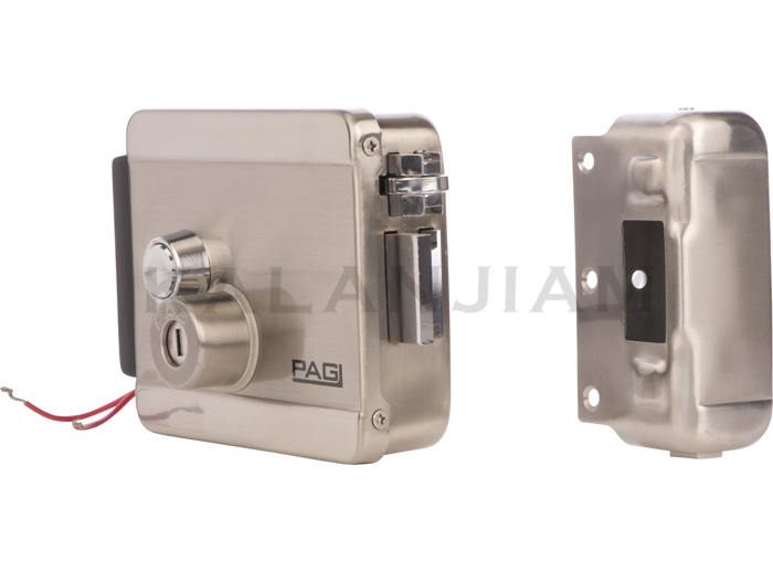

I Need your Help! I am unable to find Electric Door Strike.
I would
like to know instead of Electric Door Strike what can I use as an
alternative... So, Please kindly let me know as soon as possible.
Can I make a circuit using solenoid?
Thanks in advance.
7 years ago
Hello! Friend! Need Help! I am unable to find Electric Door Strike.
I would like to know instead of Electric Door Strike what can I use as an alternative... So, Please kindly let me know as soon as possible.
Thanks in advance.

can u spesify the lock name please
