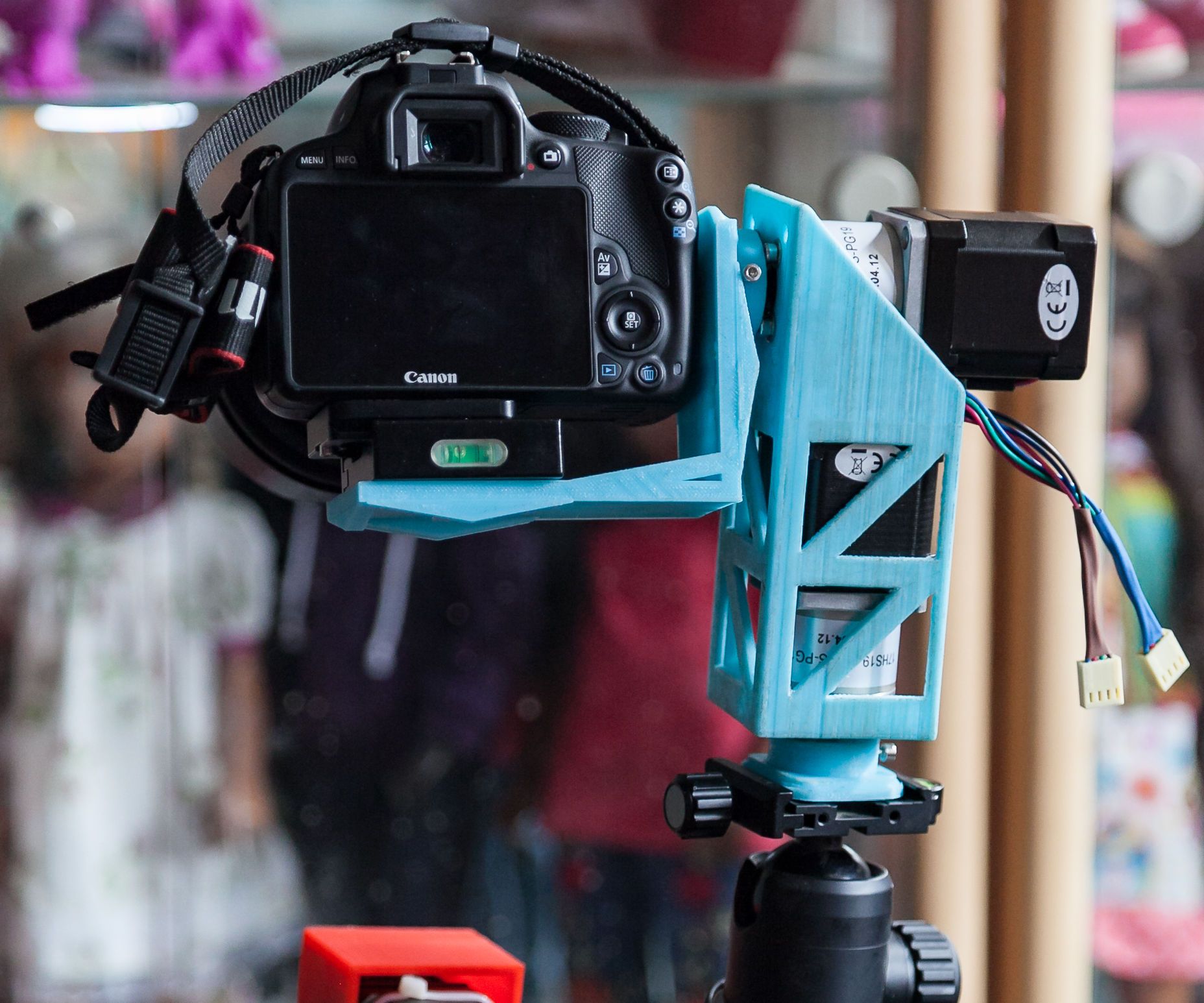

Moving on from my previous time lapse rails I realised that people may not have the skill or experience required to build one of my other time lapse rails. so working with Ustepper (mostly them) we created a kit that would allow anyone capable of building IKEA flat pack furniture an opportunity to build their own motion time lapse rail.
Ultimately my goal remains the same to create a motion time lapse rail that doesn't cost the earth but also offers quality results, I believe I have met all my goals with this time lapse rail ill let the example time lapse speak for the quality and as far as cost is concerned I calculated the cost of the purchased ebay items as £46 and with a quote for £7 for the printed parts and with the cost of the ustepper and egoshield the project comes in at around £130

depending on the type of ball head you are using and how it attaches you may want to attach the head to the bed before proceeding further.
firstly attach the stepper motor and geared tooth to the nema stepper end of the time lapse rail using 4x3mm screws. Next push the plastic part onto the end of the extruded rail. Next remove the bed from the rail and attach one end of the belt to the bottom of the bed. Place the belt around the drive pully and then guage the length of the belt by placing the idler pully just past the end of the rail and wrapping the belt back round this pully and back to the bed (this may require some trial and error to get the correct tension) mark this off and attach the other end of the belt to the bed to create a loop. now slide the other idler end plastic part over the pully and belt and slip the bolt through the idler pully to create its axle.
thats the rail complete, now attach the magnet supplied with the ustepper with super glue to the end of the stepper motor shaft and clip the ustepper and ego shield to the time lapse rail and assembly is complete.
