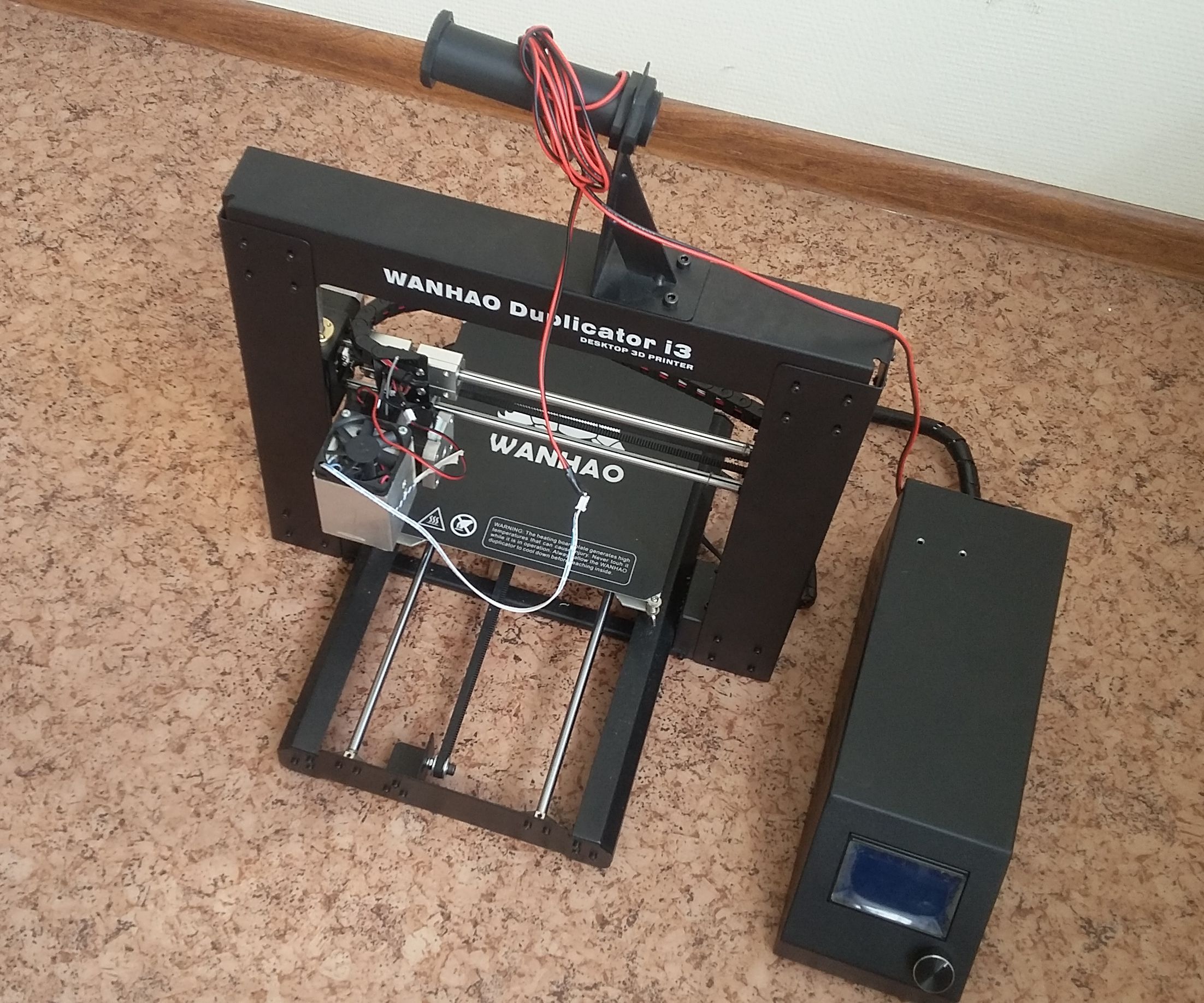

Mold is made of plastic PLA. We printed it with 3D printer WanHao duplicator i3. We offer you several complete 3D models, but you can create own mold of your robot.

3.2.2. Use Cura (download Cura) to convert SelfieBot mold STL files into GCode for 3D printing.
3.2.3 Launch Cura app. and open downloaded STL files one by one pressing the LOAD button in the upper left corner of the model view window untill you will fill the printing area.
3.2.4. You may use your usual 3D printer settings for SelfieBot mold printing. Prefered printing settings for Wanhao Duplicator i3 with Nozzle size of 0.3 mm using PLA plastic in Cura are:
Quality: Layer height (mm) - 0.2 Shell thickness (mm) - 0.9 Retraction is enabled
Fill: Bottom/Top thickness (mm) - 1 Fill Density (%) - 20-35 (any of this values are usual)
Speed and Temperature: Print speed (mm/s) - 30 Printing temperature (C) - 210
Support: Support type - Touching buildplate Platform adhesion type - Raft
Fillament: Diametr (mm) - 1.75 Flow (%) - 100.0
Retraction: Speed (mm/s) - 40.0 Distance (mm) - 1.5
With these recommended settings you will need approximately 400-450 grams of PLA plastic if there would be no oveprints in case of printing process damage.
3.2.5 In a menu FILE press “Save GCode…” on a flash memory device compatipble to your 3D printer (microSD flash memory card for example).
3.2.6 Insert flash memory card in your 3D printer, and print files according to your 3D printer instructions.
