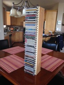

Remove the two spacers. Slide the 1 x 6 pieces against the end of the stop and made a dado cut. Continue using the spacers to reposition the stop and make dado cuts until finished. At the end trim away any partial dado less than 7/16 inch wide. Trim the other side piece to match. (My tower is 27 15/16 inches tall and holds 57 CDs.)

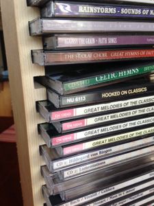

When a CD is removed, nothing supports one side of the CD above it and it falls as shown in the photo. Seldom will I remove two CDs directly next to each other at the same time. When putting a CD back in place, simply insert a corner on one side and slide it laterally to restore the space. See the second photo.
See the third photo. Because the CDs are staggered in the tower, it is very easy to remove any one. Just grasp the staggered corner.
This project required a little more time than I expected. But, I have a CD tower I designed with my needs in mind. And, I did not need to spend time shopping for what I wanted. I can store my CDs in a closet, or I can paint or stain the tower to make it more presentable.
One slight disadvantage to this CD tower is that it holds single CD jewel boxes only. It does not accommodate a double thickness jewel box as it is made presently. I could remove the raised portion between two dados and do that on both sides to make room for a double thickness case.
