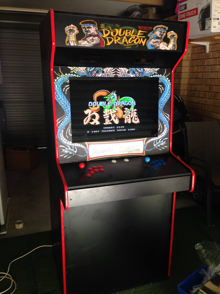

Here are instructions on how to build an upright arcade cabinet. I have built a couple of arcade cabinets and have enjoyed learning how to build them and customize them.
a preview video can be seen here: http://www.youtube.com/watch?v=a-3FZYUdghI
I wrote these instructions to assist those who are not yet comfortable in taking on a project like this singlehandedly. I tried to make it as inexpensive as I could, while making it easy to design and construct one with the minimum required skills. I will not be talking about programming or where to download videogame files from, but I’ll offer references to sites that will.
I believe this is a great first project to pick up because not only do you get something awesome at the end but you get to learn about: electronics, soldering, construction, and designing. Once these skills are picked up, they can be applied to other projects.
I used a jigsaw, router, and drill to build this cabinet so the tool requirement is not out of reach for a beginner.

It should end up looking simular to the example image when finished:

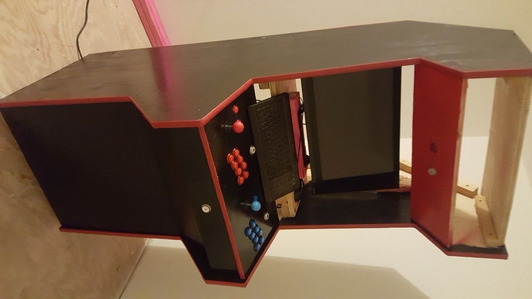

Step 4: Now the Rest of the Pieces
Once the sides are together, now is the time to cut out the remaining parts. Now measure the length of each white line and cut out that length, and then make it by 24" inches.
Look at very top of the cabinet. Measure the length of the white line that was drawn earlier. My length was 11-1/2” inches, so the piece is going to be 11-1/2” inches by 24 inches
There is an example of all the pieces: Make sure you measure every pieces don’t just base it off my drawings.
A few special notes: (Read this before cutting out all the pieces)
• The drop drawer top edge needs to be cut at an angle. To do this, just adjust the angle plate on the jigsaw and cut it just like before. The drop drawer needs to be trimmed a little bit the in 24” inch way so it doesn’t grind and scratch the sides.
• The speaker mount pieces are also at an angle to make a flat face for the marquee to set on. To make the speaker holes you can drill a hole then cut out a circle or you can purchase a saw hole bit and cut out a 2” inch hole.
• The front bottom needs to extend far enough to cover the bottom piece, so the bottom piece end grain does not show.
(this and the control panel are one of the few pieces that extend over the with line.)
• Route the front of the slide drawer and the front of the control panel pieces, and apply t- molding.
• The drawer slide piece needs to be cut to 23” inches instead of 24” to accommodate the drawer slides.
When I cut out these pieces I would cut a long strip that was 24” inches wide across and then slice it up into the right size.
There is an example below of a long strip being cut to several pieces.

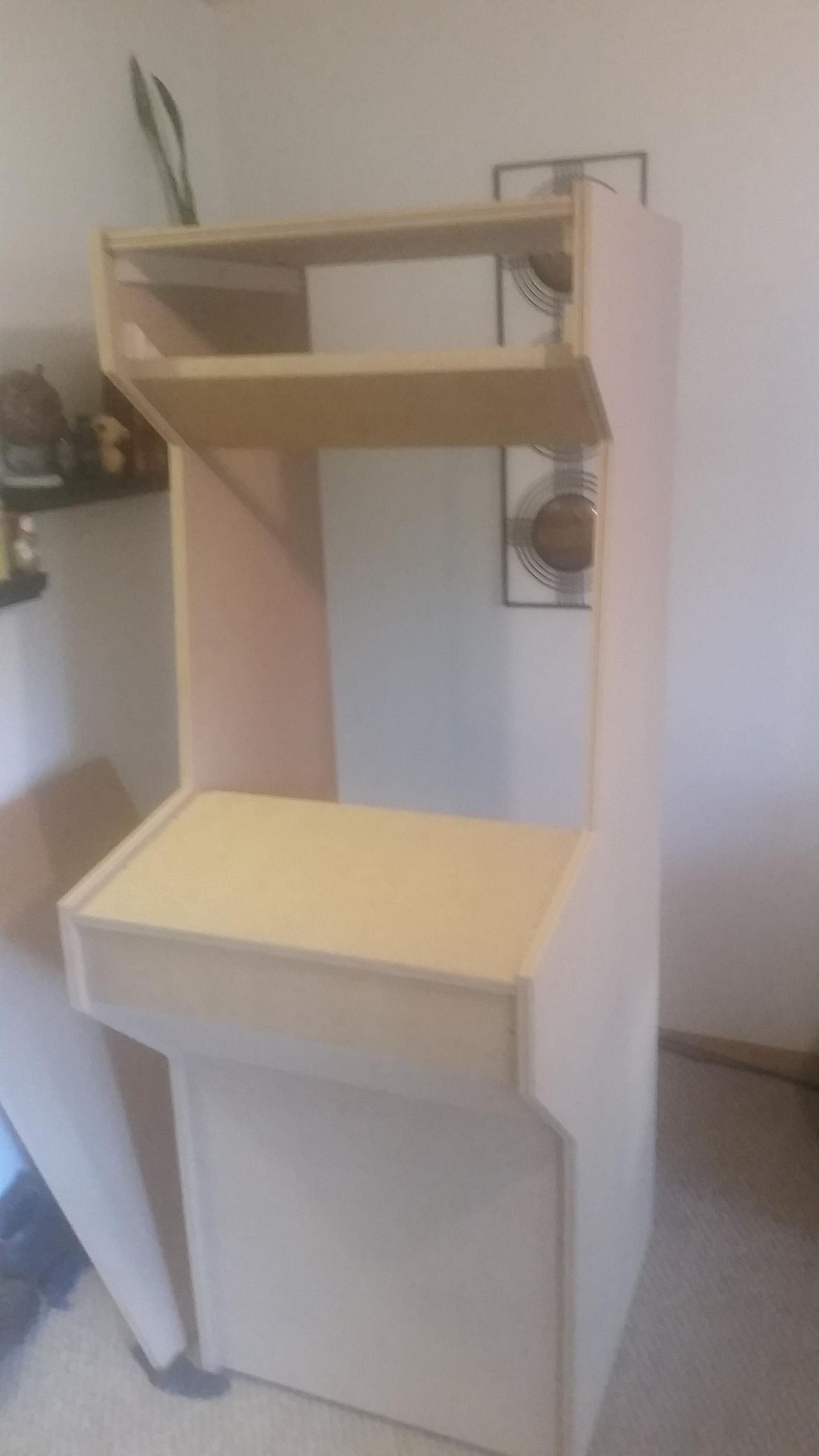

Step 5: Constructing:
Constructing:
Now is the time to screw the pieces onto the sides using the braces. Here are some picture examples:
I placed the screws from the outside going through the mdf into the brace. Make sure you pre-drill. Create a pilot hole for the screws and make sure you don’t counter sink too far, but if you do, just color it in with a sharpie and you can’t tell. Use glue if you feel like you need to, but the screws should be strong enough.
Example of pilot and counter sink is shown:
when one side done add the other side and screw it in. Your cabinet should now start to look like an empty arcade.

Step 11: Get to Gaming:
There is a instructable on how to make your own marquee at: https://www.instructables.com/id/how-to-make-a-vintage-arcade-marquee/ (thanks to slimguy379)
Some other helpful websites:
http://www.hyperspin-fe.com/ , this is the site were i got my frontend
http://arcadecontrols.com/arcade.htm
Now hook up all the cables: plug the computer in, plug in the keyboard and mouse, connect the monitor and plug in the game pads. The arcade should no be able to turn on from the external switch and the computer should recognize and read all the buttons. If you have any more questions email me at: tomj300sr@hotmail.com

Thanks for the reply. I actually finished my cabinet a couple weeks ago and couldn't be happier. Especially for the first big project I've made. I'm no great woodworker so my cuts were a little off (I think I should have used a circular saw instead of a jig saw ok big pieces}, but overall I really had fun building it. The painting part was much easier then I expected. Like really easy. All I did was have a quick sand the MDF, with giving the cut edges more sanding then the sides, then put down a coat of Kilz oil based primer, let it dry, did a light sanding again, repeated then did two coats of black semi gloss latex paint. It took a full day of paint and drying, but it came out great.

Thanks so much for the plans and share. This one was made using your plans modified to fit a large Sony Trinitron tv with a super old dust-collector computer for the internals. Might be making a few more with Raspberry Pi for friends.
5 years ago
