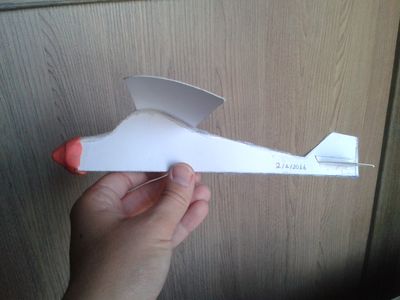

The airplane is now ready, we still have to adjust the location of its center of gravity. As stated before, the CoG should be placed under the wing at the middle of the fuselage. For more scientific approach, check:
https://www.faa.gov/regulations_policies/handbooks...
I didn't use this handbook in this project and everything was improvised, even the plan.
To adjust the CoG location, try to balance the airplane on a ruler. The point at which the airplane is balanced represents its CoG. If the CoG is located behind the wing, add Plasticine (or any other type of modelling clay) to the front of the airplane to shift the CoG to the desired location. On the other hand, if the CoG is in front of the wing (I am not sure if this may happen) add clay to the end of the airplane.
After setting the CoG at its proper location, you can add landing gears and paint your airplane.
Step 6: Fly Your Airplane... Similar Projects...
You can make simpler airplanes using the same procedure. The small airplane in the figures above took 3 hours of work, and the big airplane took about one hour of work, and all are flying (as a glider). I still have to add a motor with a propeller and the control circuit with a battery. Pay attention that the location of the CoG should remain under the wing, even after adding extra weights. Add/remove parts from the clay in order to maintain the location of the CoG.
As can be seen in the second figure above, the wing of the airplane is not 100% symmetric. This produces undesirable turns during flight. To overcome these turns, add aileron or flaps (a small piece of cardboard) on the upper side of the wing as shown in the last figure above. For my airplane, I fly it indoor only and it doesn't need flaps because the flying distance is short.
