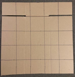

Step 1: The Cutting Pattern

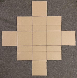

This is the template. There is no need to print it out unless you want to. All the squares are the exact same size. The planter I am making is a 4x4x4 inch cube, but you can make yours any size you want.
Step 2: The Basic Cutout
As you can see, I used a marker to draw a grid on my cardboard matching the template. Every square is 4 inches by 4 inches. I then cut off the excess pieces of cardboard with my box cutter to match the outline of the template. Don't toss those extra pieces just yet, you need one of those squares at the end.
Step 3: Scoring the Cardboard
On the diagram you will have noticed some red dashed lines and some black dashed lines. Where the red dashed lines are you will cut all the way through the cardboard. Where the black dashed lines are you with score the cardboard (cut along the dash without cutting completely through the cardboard). Scoring the cardboard makes it easy to fold.

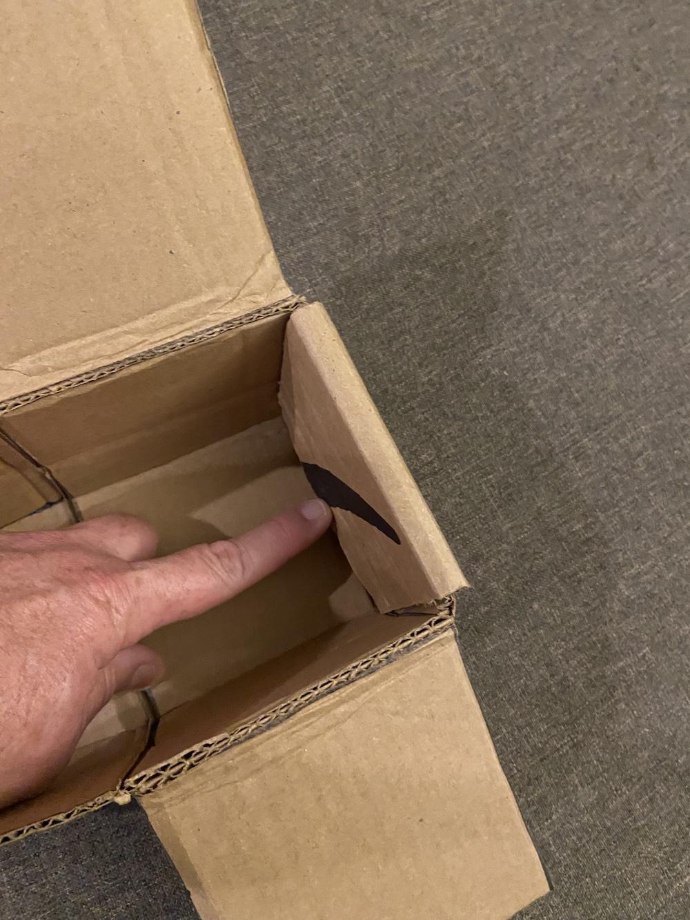

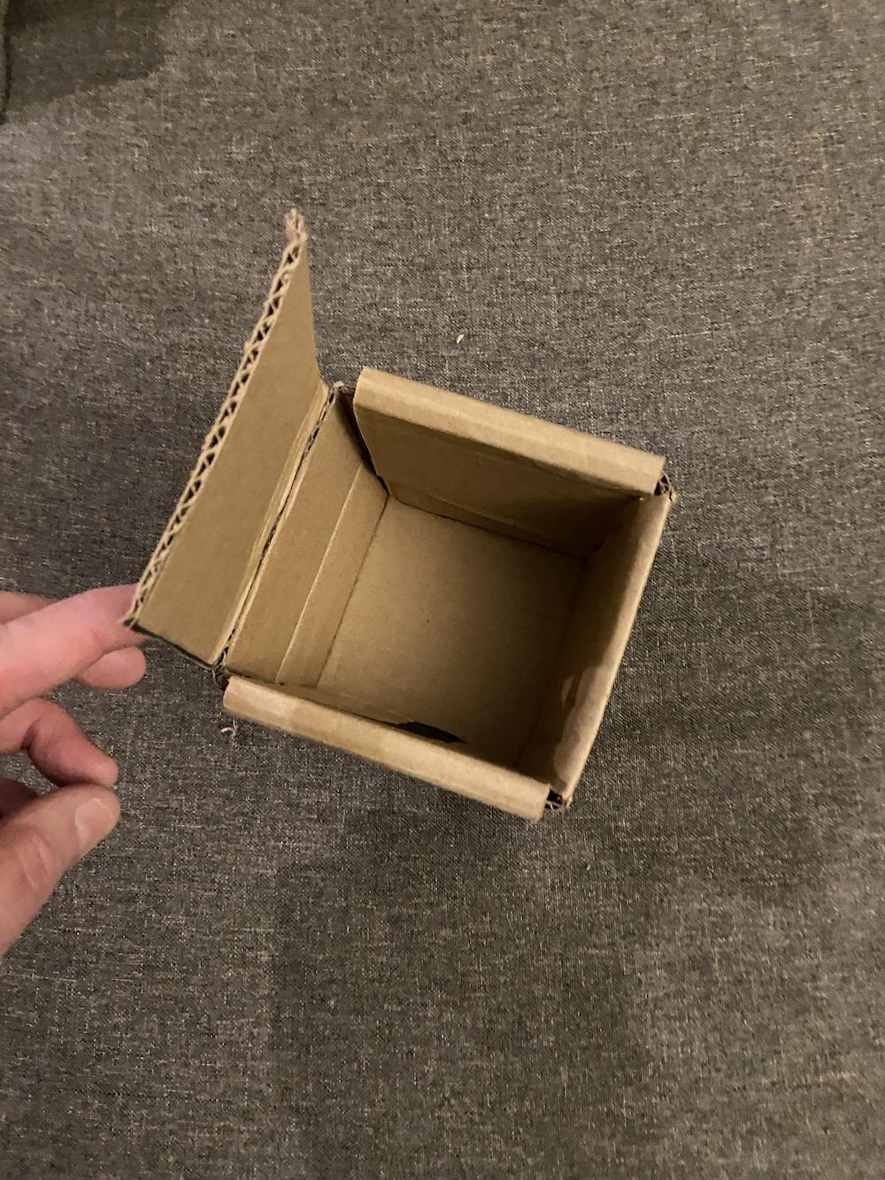

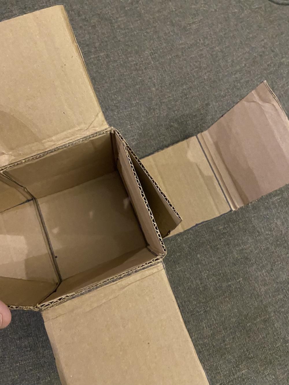

- Lift up the right sides you cut completely through and then fold up the first side.
- Repeat with the opposite side.
- Lastly, tuck in the four outer flaps.

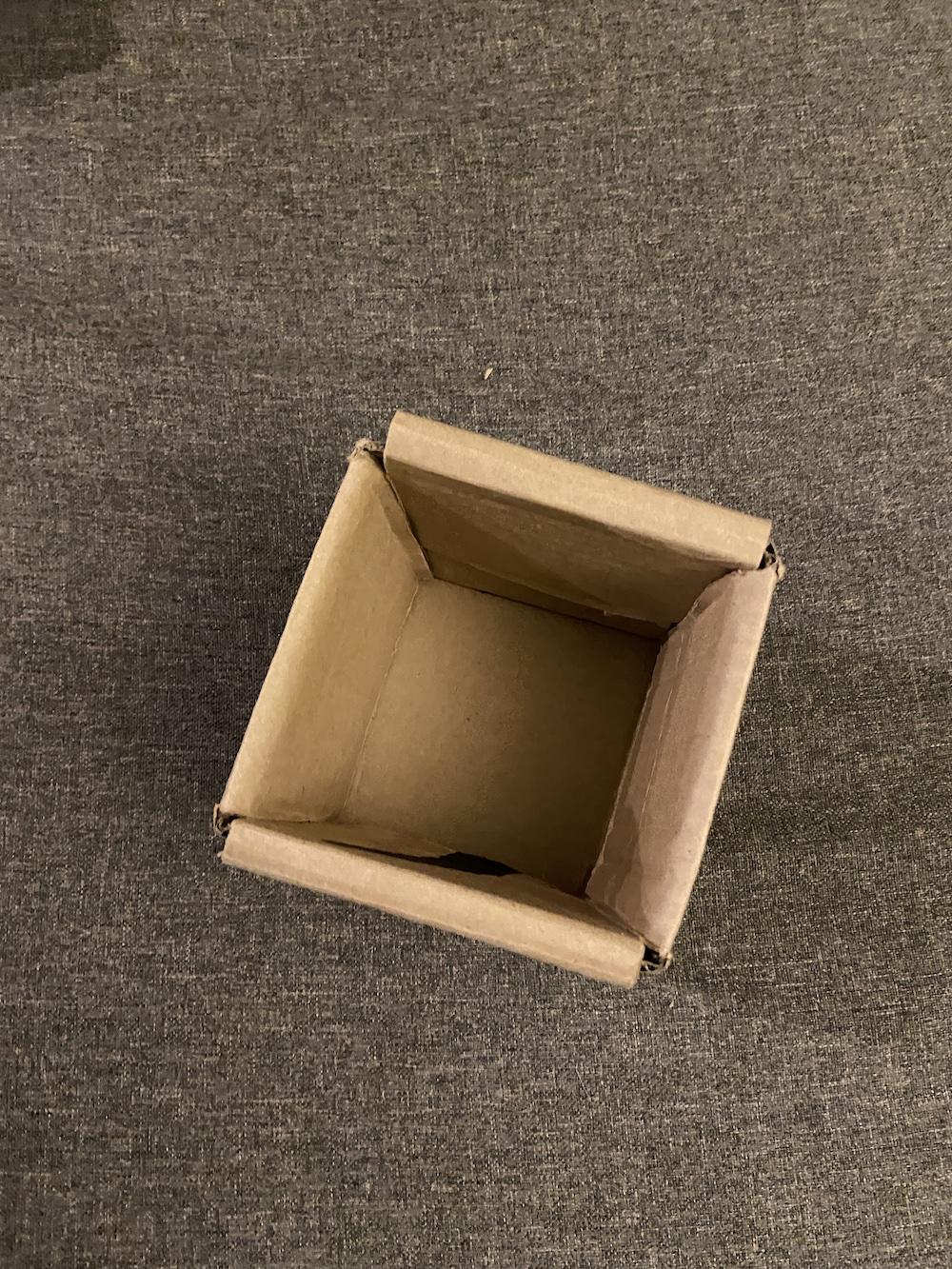

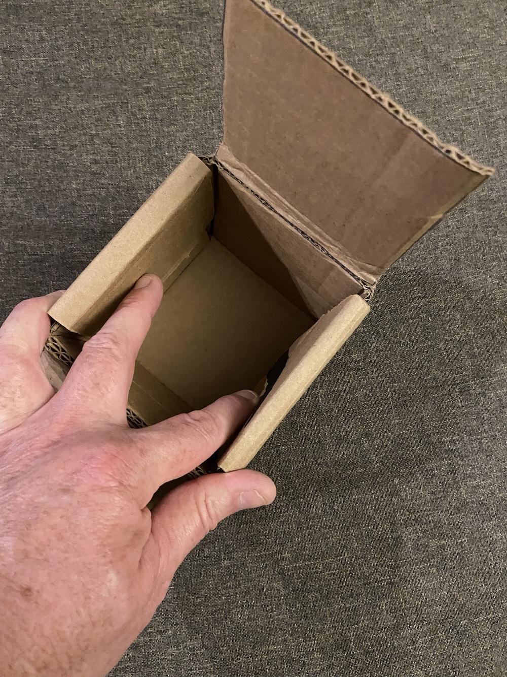

Step 5: Congratulations, It's a Box!
Your planter box should look like the photo above.
You don't need to fill it with soil for it to keep it from unfolding, it stays together on its own. So you can make several in advance and have a bunch ready to go for filling and planting.

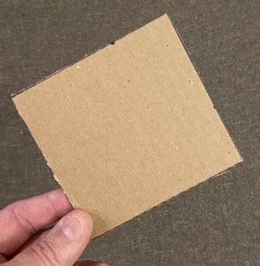

Remember that extra leftover square? You can stuff that into the bottom for extra support on the bottom if you like. Depending on how thick the cardboard is you may or may not need it (usually not).
