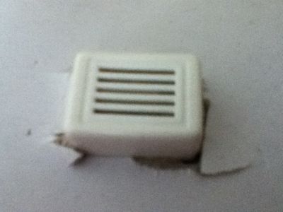

* An electronic buzzer

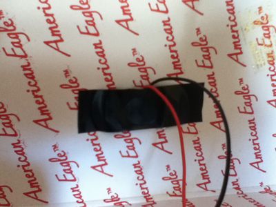

Mark and cut where you would like your buzzer to be, and secure it with a piece of electric tape, as shown in the picture.  I put mine right in the middle so you can hear it really well.  Mark and cut a hole for the wire that you guide through the maze to come through.  Make sure the hole is big enough to give the guide wire a little bit of room so it move around freely.

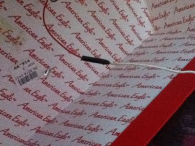

Cut a piece of wire about 1 1/2 feet long and strip off the last 4 inches on one end and about one inch off the other end. This will be the wire that you guide through the maze.  Twist together the positive wire of the buzzer and the short stripped end of the guide wire as shown in the picture.

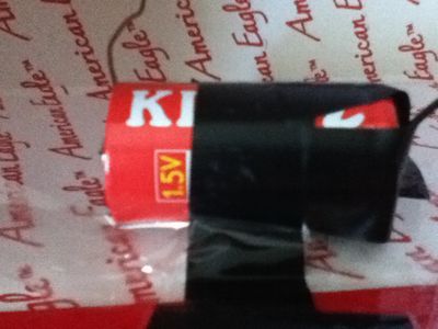

Tape or hot glue the battery to the inside of the box on the side of the longer stripped wire. (look at picture for reference)  Electric tape the negative wire of the buzzer to the negative side of the battery.  Basically, this whole project is just a switch so when the guide wire touches the maze, the current is carried through the buzzer resulting in a loud buzz.

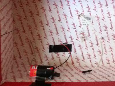

Make sure the long stripped wire is able to reach the battery, and electric tape it onto the positive side of the battery.  Make sure this is a good connection, besause this is critical to the success of the project.  Bend the long end of the guide wire into a circle around the track.  Touch the guide wire against the track, and if you hear a buzz, it works!  If not, you may want to check all of your connections and make sure the battery is fully charged.
