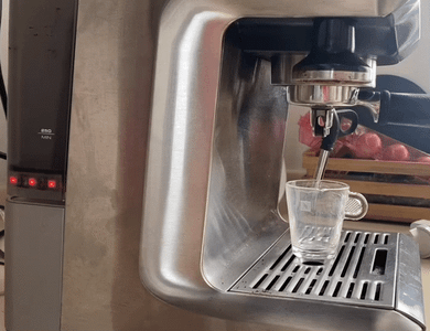

Have you ever been frustrated realizing your expensive coffee machine stopped dispensing coffee in the middle of a perfect coffee brewing ?
Hearing the pump screaming and shaking, begging for water is a heart breaker for me (and thinking of the mechanical impacts made it worse)…
So I decided to create my own easy DIY, non-contact and visual sensor that reminds me to fill up the water tank when the water level gets too low.

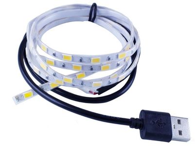

Part 1: USB Led Strip
Ref: any cheap 5V led strip (size and color you like)
Vendor: Aliexpress
Cost: 4$

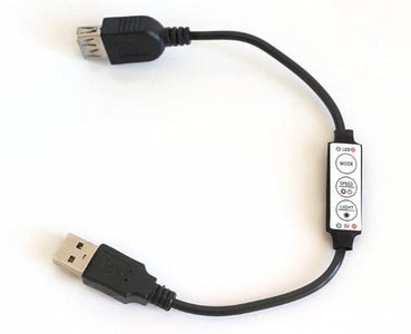

Part 3: Led Controller
Vendor: Aliexpress
Cost: $2
Note: the led controller is optional (but cool blinking & fading effect)

Step 3: Let's Install It!
The idea is to place the led strip under the tank (usually there is a cavity) and use thin wires so you don't have to drill any holes in it!
Then just tape (double sided tape ) the sensor at the lowest level you want to be alerted.
