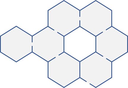

Step 1: Planning
First, you have to plan how you want your led panel to look. You can use one of the above patterns or make your own. Using a 5 meter long LED strip you can make seven to eight pieces and arrange them however you like.
Check if your strip is working correctly before you start the build.
Once you have decided how many pieces you have to make go on to the next step.

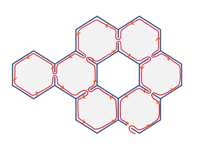

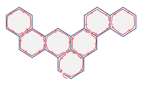

Step 6: Glue in the LED Strip
That's the trickiest part of the build because you have to put the strip in one piece into your panel
First, you got to use a wirecutter to cut out little gaps where the covers are glued together. View the pictures above to figure out where to cut them.
Now you can gradually glue the led strip into the covers. following the red line with the orange arrows. Leave some space between the strip and the edge of the panel so later the back panels fit in easier.
Start by gluing the receiver onto the outside right next to the gap and fold the strip over on the inside. From here follow the red line with the orange arrows until you're back at the beginning.
Cut off the rest of the strip and put a little piece of tape over all of the copper contacts.
If you've made your own design I recommend sketching out the path first.
