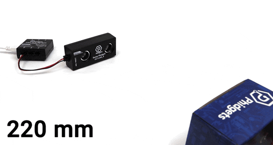

This project will show you how to add distance sensing to your next Python project.
  • VINT Hub
  • Sonar Phidget
Step 1: Connect Your Sonar Phidget
Connect your Sonar Phidget to your VINT Hub with a Phidget Cable.

Step 5: Result
The result is a Python program that can quickly and easily sense Distance.
