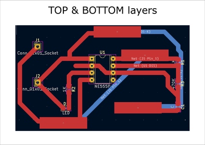

The concept of this project is quite simple, as explained above, the circuit is designed in KiCAD using 2 copper layers. After this first step, I import the 2 layers in Inkscape and I mirror one of them and place same side by side in such a way that if I were to fold between them, they would be stacked exactly as designed in Kicad. I print this image on tracing paper (using a standard inkjet printer) and make myself a screen-printing screen following this previous Instructable of mine. I then deposit through the screen gilding glue and then the copper foil. I solder all the electronic components and then I fold the design. The finishing touch is to place the vias. In PCBs, vias are the conductive elements that connect the different layers together. I did not invent vias for paper PCBs as staples already are vias which I use both as the interlayer layers connectors as well as a way to keep the layers from moving.

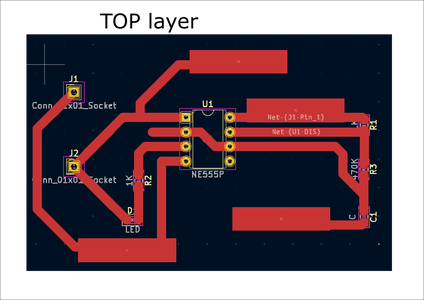

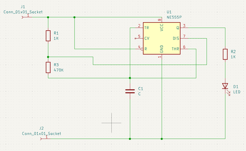

The first step is to design a layout from a schematic, for illustrative purposes, I have chosen here the electronics equivalent of the “hello world”: a N555 based blinky. The schematic is fairly simple and works with a very small number of components (7 components total). I have used “large” SMDs as it makes the assembly easier. Drawing the schematic does not take into consideration or PCB manufacturing process, this arrives in the next step: circuit layout.

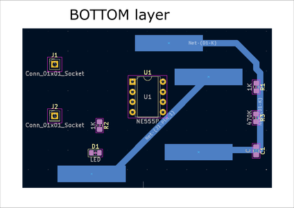

The layout is a bit different in that by using staples as vias, we have to make sure that we plan enough space to place the staples with some margin as working with a stapler is not the most precise way of laying out vias. In this design, I only have 4 vias the areas dedicated to accept the vias are highlighted on the picture above. In my case, as I am also soldering the through-hole N555 as a SMD, I also have to plan some space around the folded out pins of the N555.

  1. Import the 2 layers
  2. Align them horizontally (I have used the vias area to align the 2 layers)
  3. Horizontally mirror one entire layer (I chose to mirror the bottom layer)
  4. Remove unwanted traces (in my case all inter-layer holes). This step is optional, it just makes the design clearer
