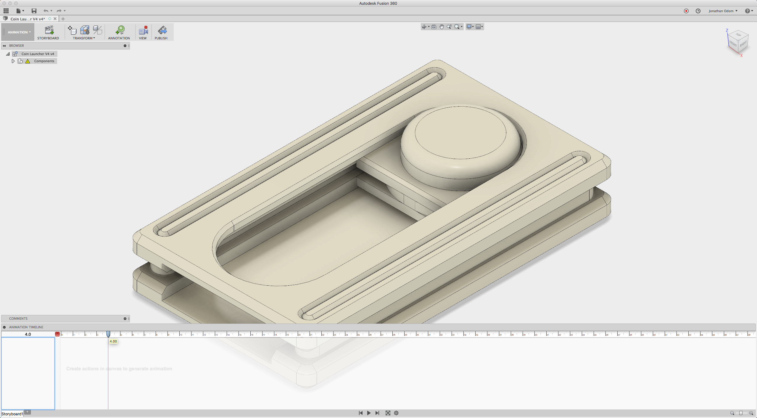

When you have a design open, the Model workspace will be selected by default. Click on MODEL on the left side of the tool bar and select ANIMATION from the list. The toolbar should change and you should see a timeline at the bottom of the canvas.
Step 3: Move the Parts
On the timeline at the bottom, move the vertical line to the right by a few seconds. In the screenshot above it's been moved to 4.0.

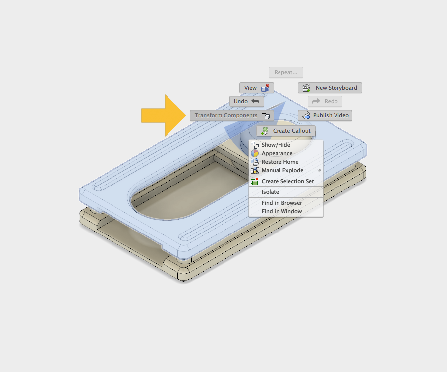

Click on the upper most (or outer most) component, then select Transform Component from the popup menu. The idea is to move things on the outside to the furthest point in the exploded view, then move the inner parts so that they're closer to the center of the drawing. Imaging you're taking your object apart and letting the parts float in the air in sequence.
Drag the arrows on the manipulator and move the part so that it's above the next part to be shown below it. In this case, that's the Coin Cup (button shaped object in the picture above).

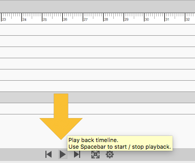

Use the controls at the bottom of the timeline to control the animation so you can see how it moves! You'll probably notice that the camera (view) moves too, you can turn that off if you want, but we'll get into that later.

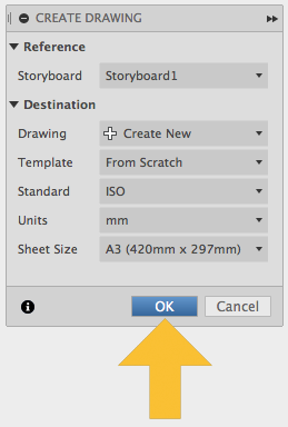

Step 4: Make a Drawing
When you're happy with the final position of everything, Click on File > New Drawing > From Animation.
Click OK.
The default settings are fine, but if you want you can change units, sheet size, or apply a template here.
The new drawing will open and you'll be prompted to place the view on the page. You can change the Scale here to something that will fit on the sheet. The Style is Visible Edges by default, which will give you a black and white line drawing with no hidden edges. Make sure the Orientation matches your animation (Home by default), and click OK.

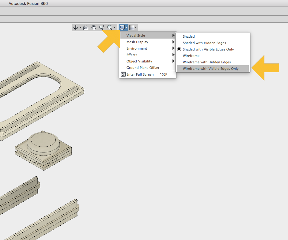

If you want your animation to look like a black and white line drawing, go to View Controls at the top of the Canvas and select Visual Style > Shaded with Visible Edges Only.

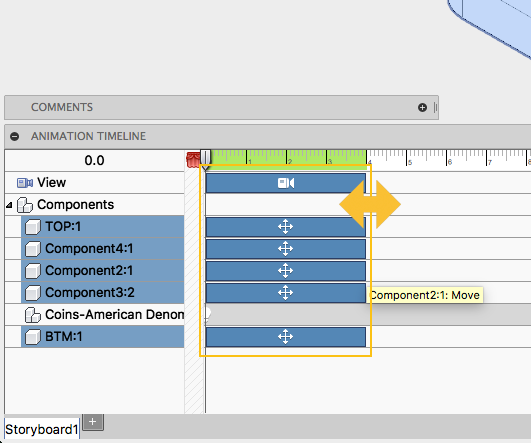

If the animation is too long or too short, select all of the items in the timeline, then shorten our lengthen them with the mouse as shown. If you don't want the camera to move, you can delete the View track at the top of the timeline. Anywhere you place the cursor on the timeline will record the position of the view if you move it. If you don't want the view to be recorded, click the View button in the toolbar at the top of the canvas to turn it off.

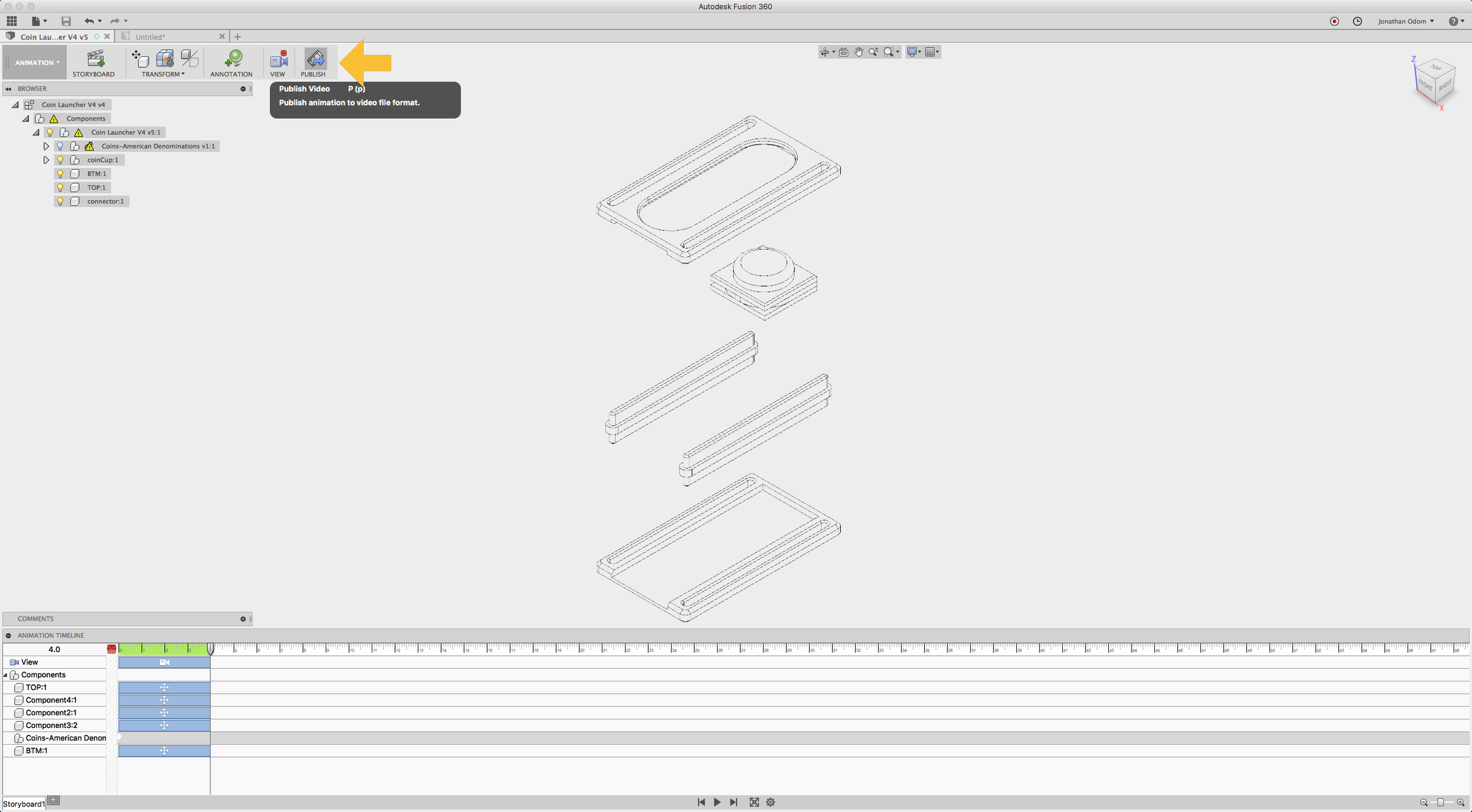

When you're happy with your animation, click Publish in the toolbar.

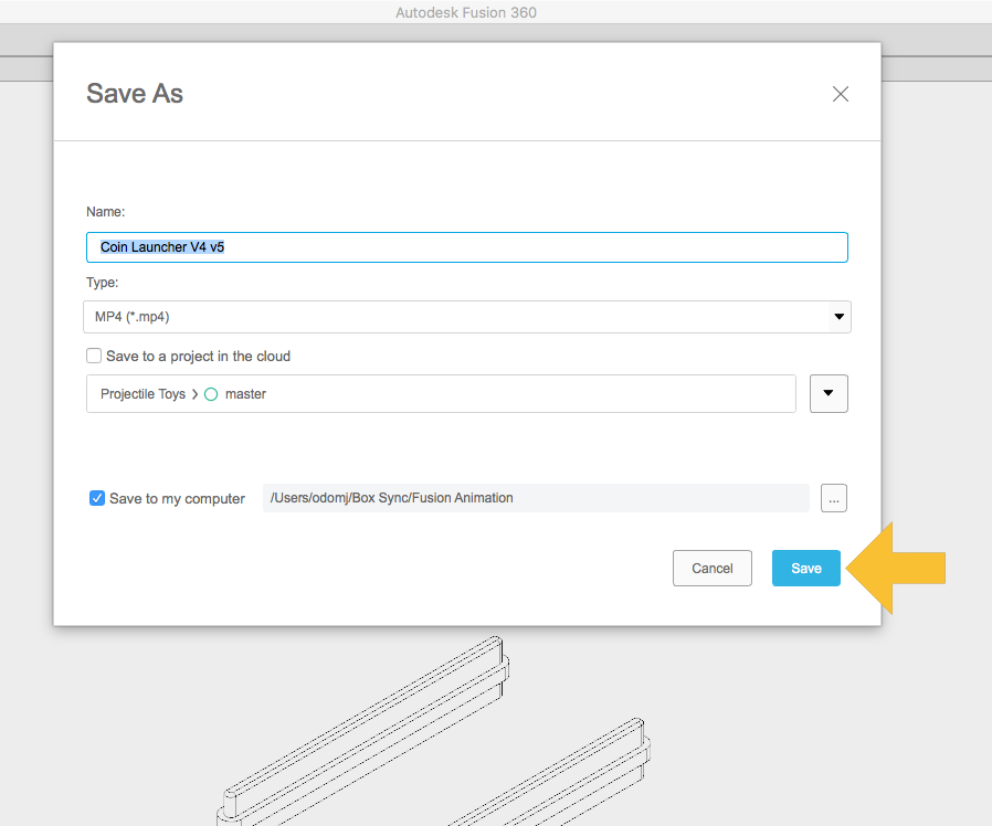

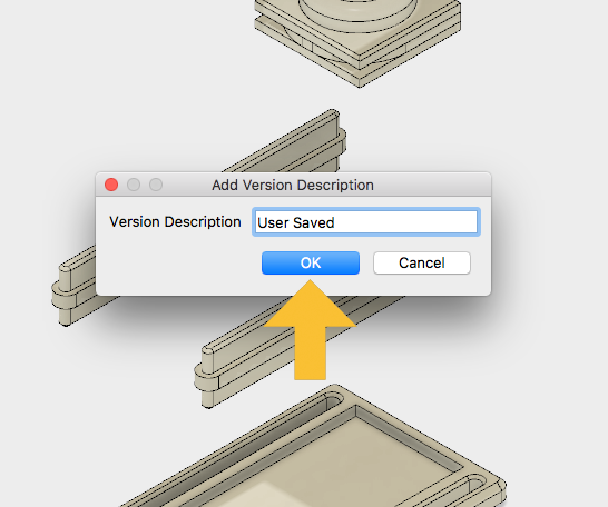

Choose the settings you like in the window that pops up. It's better to go with higher resolution with line drawings because the lines are cleaner and the file size is small since there isn't much color.
Choose a place to save the animation, and that's it!
