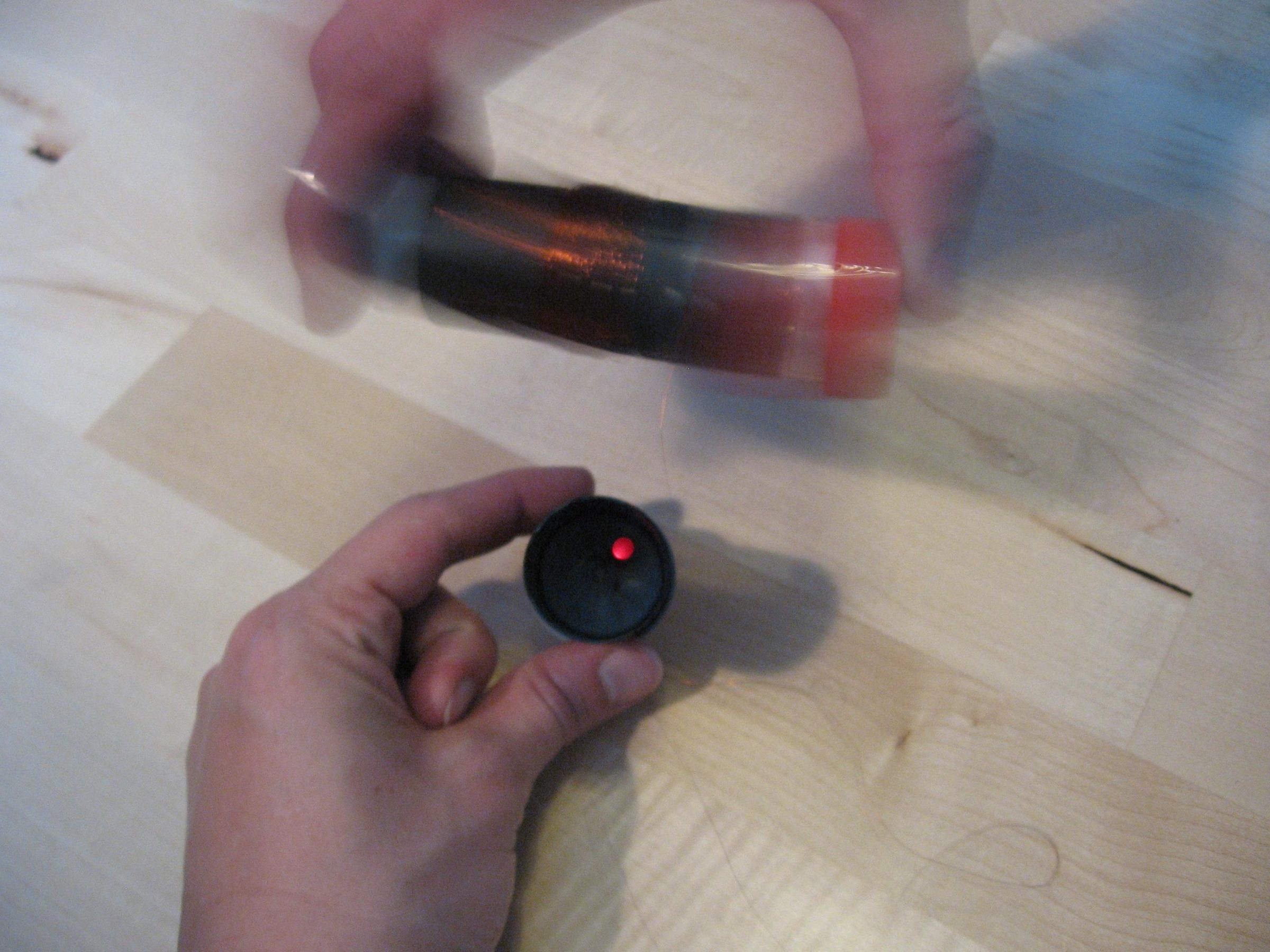

Step 2: Make the Coil
1. Make the wire into a coil using the D sized battery & remove it from the cell.
2.Tie the coil diametrically outwards as shown.
3. Scrape the enamel fully form one side & on the other side only 3 sides as shown.
4. Now the coil is ready.
