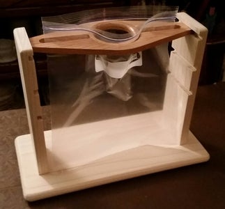

If you ever have to fill plastic bags for freezing or storage you're more than familiar with the problem: you're holding a pot full of stuff in one hand and trying to hold open a very flexible bag to pour the stuff in with the other hand. The thing is, it really takes two hands to hold the bag open properly and if the pot you're pouring from has any weight to it at all it really takes two hands to do the pouring as well. You need four hands. My wife does a lot of freezing and storing stuff - especially in the summer - and if I'm not around to help it often means a lovely mess in the kitchen when she tries to do this by herself. We've come across a few different gadgets designed to hold a bag while you fill it, but they all seemed to be only halfway engineered. Either they weren't particularly stable or they didn't work with a variety of bag sizes or they just didn't work very well at all.
I decided to tackle the problem one day and came up with a prototype for the Easy Fill. It worked better than anything we had ever tried, but there's always room for improvement. When our grandson needed to come up with a school project involving the demonstration of an original idea I suggested we might work together to refine the Easy Fill idea. So the resulting gizmo is a collaboration across the generations.
Some of the neat features of the Easy Fill:
It works with sandwich size, quart and gallon bags.
There are only six pieces made entirely out of wood - no glue, no screws, no nails - just wood.
It collapses completely flat for storage.
It looks nice.
It's easy to make if you have the right tools.
It really does work. Very well.

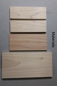

MATERIALS YOU WILL NEED:
One piece of wood 11 5/8 inches by 5 inches and 3/8 inches thick. This should be a harder wood such as oak, hard maple or cherry.
One piece of wood 15 inches by 7 1/8 inches and 3/4 inches thick. Poplar or pine would be fine.
Two pieces of wood 11 inches by 3 1/2 inches and 3/4 inches thick. These can also be something like poplar or pine.

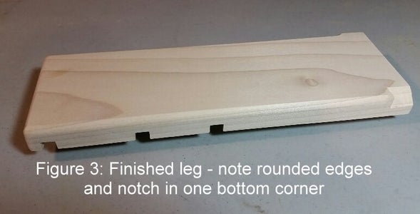

The legs are your 11 by 3 1/2 by 3/4 inch thick pieces
A. Rout the channels: On both of the legs you will use a 3/8" straight bit set to a depth of 3/8" to cut three 3/8" wide and 3/8" deep grooves. Refer to Figure 1 to properly space the grooves.
B. Cut a notch: Cut a 3/8" by 3/8" by 3/4" long notch in the outside left lower corner of each of the legs (Figure 2). This becomes a "key" so that the legs will only fit into the base one way.
C. Round over: Cut or sand the top two corners of the legs to round them off. Then use a 1/4" round over bit to round the outside edge of both legs. Do not round over the last inch at the bottom of the legs. Your legs will look like Figure 3. That's it.

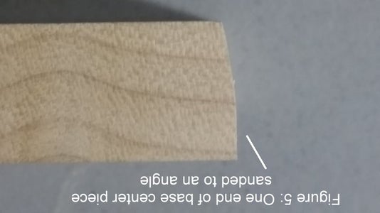

Begin sanding one end of the insert piece, checking often to see if it fits between the legs yet. Sand at an angle so that the bottom of the piece becomes a bit shorter than the top. See Figure 5. You want to get it to the place where a firm push down on it will seat it into place between the legs, causing both legs to be held firmly in place and perpendicular to the base. You should be able to firmly pull up on one of the legs - or knock on the insert piece from the bottom - to take the pieces apart again. Be patient with this step and sand just a little at a time, checking for fit between each sanding. A snug fit here is the key to the whole thing fitting together well. It usually takes me at least half a dozen trips from the sander to the workbench to try my piece out until I get it sanded just enough to make a firm fit.

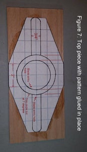

A. Use the Pattern: An easy way to do this entire step is to print out the pattern in Figure 6 and use rubber cement to glue it to your workpiece. The pattern grid is one inch squares, so if you can adjust the size of your printout so that the squares measure exactly one inch you will have a pattern precisely the size you need to make the piece. Since the pattern is more than 11 inches long, I crop it at the ends of the inner slot, which is exactly 10 inches long. This allows it to be printed on a single sheet of paper. Then I center it on the workpiece and fix it in place with rubber cement. I use a pencil and ruler to extend the outer edge lines to the ends of the piece. See Figure 7.

B. Cut the Edges: Cut the 11 5/8 x 5 inch piece of wood to the outside dimensions shown in the pattern.
C. Cut the Inner Circle: Drill a blade entry hole inside the innermost circle and use a scroll saw to cut this circle. The circle of wood you cut out will be discarded.

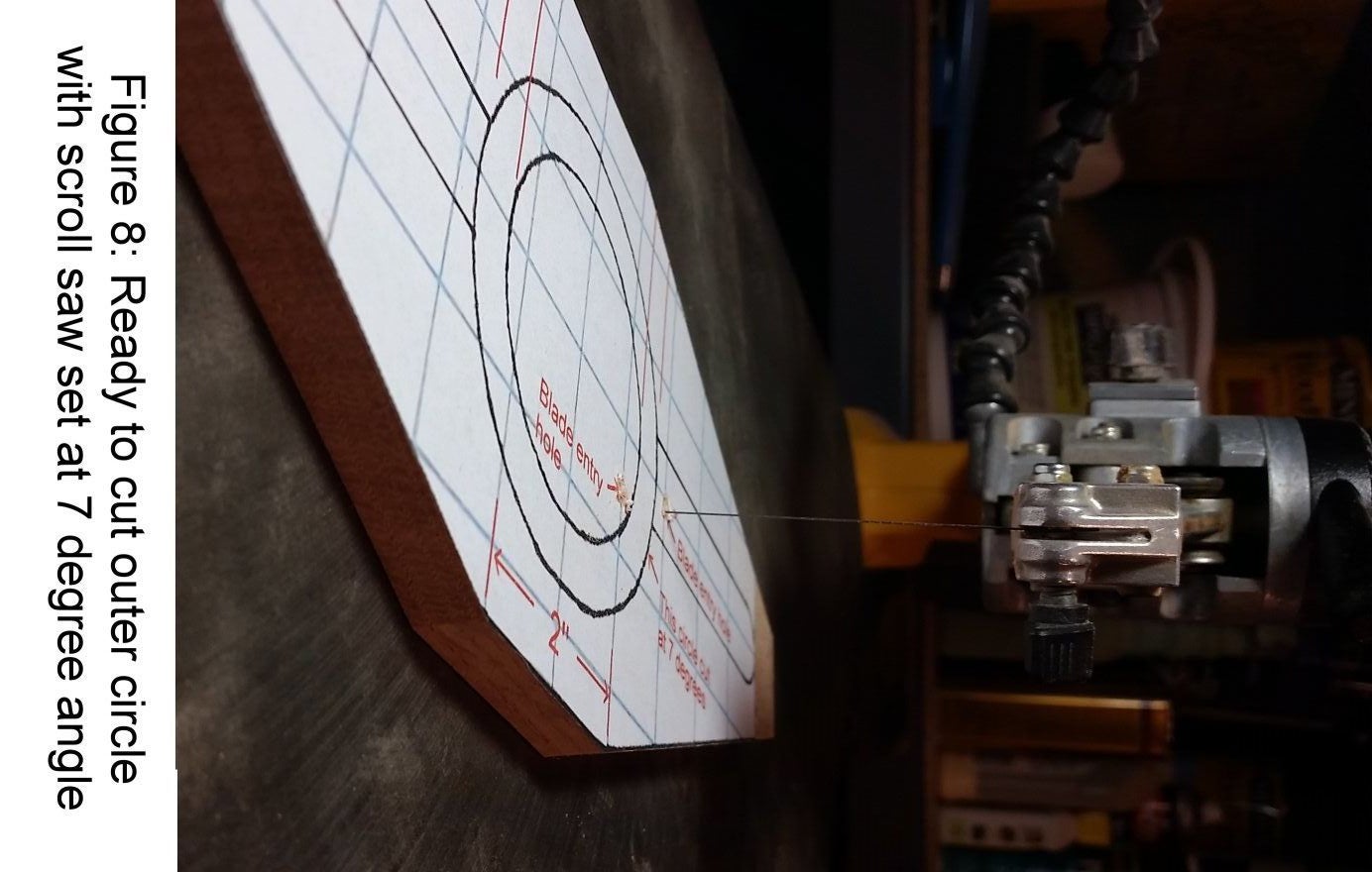

D. Cut the Outer Circle: Drill a blade entry hole in one of the areas extending outward from the outer circle as shown in the pattern. Set your scroll saw to a 7 degree angle and cut around the outer marked circle. See Figure 8. Now you have a ring that has a straight edge around the inside and an angled edge around the outside. Use a 1/4" round over bit to rout the top (widest) inside edge of the ring.
E. Cut the Slot Extensions: Set your scroll saw back to zero degrees and cut out the extensions on either side of the circle.

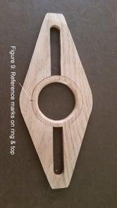

1. Unless you're really, really good with a scroll saw, your circles won't be absolutely round. That's fine, and you can do a bit of sanding on the edges to make them a bit cleaner, but the ring will fit into the circle best if it's lined up with the grain so that you're putting it in oriented the way it was when you cut it out. So check the grain of your ring, lay it into the circle so the grain matches, and make a small line across the top of the ring near the edge and extending across the cut to the edge of the circle (see Figure 9). This way it will be easy to line the ring up for the best fit. You can make this even easier by making this mark before you cut the ring out of the top piece.
