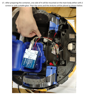

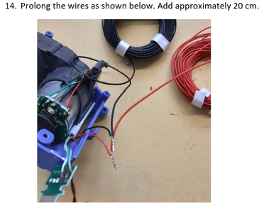

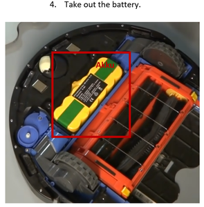

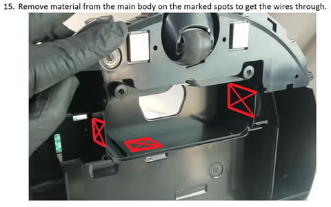

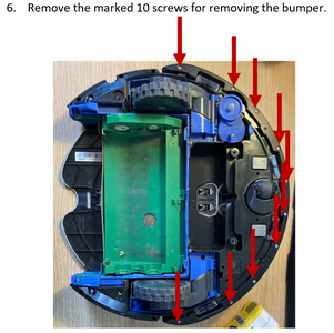

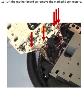

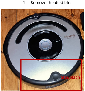

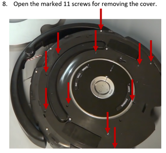

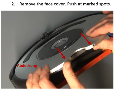

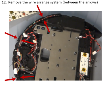

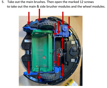

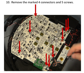

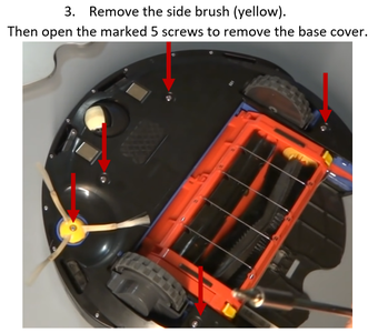

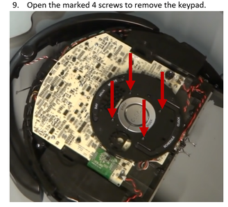

Step 1: Hardware - Prepare Robot
The process of preparing the vacuum cleaner is explained step by step in 17 pictures. Each picture has an explaining text. So please open the pictures to begin with the process.
The assembly of the electronic parts is described in the following step “Hardware-Electronics”.

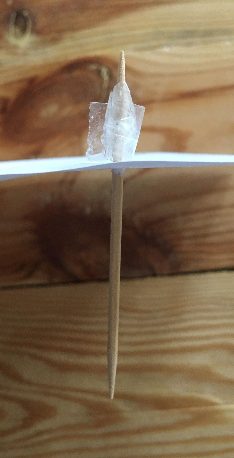

- wrap sellotape around one side of the 8 toothpicks (see image)
- Place the toothpicks in the holes with the sellotape inside the box (see image)

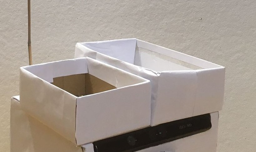

Step 6: Assemble
- Tape the first box to the vacuum cleaner using the input an ventilation holes. If needed add more slits (see image)
- Add the lit and second box combination. (see image: first assembly)
- Add lit with holes
- Add device holders Add bamboo stick and sellotape it inside the second box. (see image: final assembly)

- Place the motorshield on top of the Arduino using the matching connectors. Depending on the model of motorshield purchased, the connectors on/underneath the motorshield come pre installed or have to be soldered on.
- The instructions for setting up the motorshield can be found at the manufacturers website: Install Headers & Terminals
- Attach the four cables from the motors (two from each motor) and a 12v power supply to the connectors on the motorshield
- Attach a USB cable to the Arduino.
- Thread the power supply cable underneath the vacuum to the side and from the outside throught the laptop opening into level 2.
- Thread the USB cable underneath the vacuum to the side so it can later be plugged into the laptop.

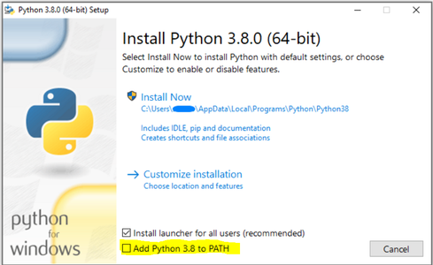

Step 4: Software - Download and Install Python

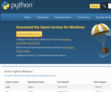

Download Python
Go to https://www.python.org/downloads/ and download the latest Python Version.
Install Python
Start the downloaded Python installer. Make sure you add Python to Path (second picture). Then proceed with the installation. When the installer is done, make sure to disable the path length limitations (third picture).

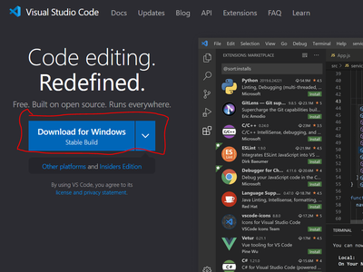

Step 5: Software - Download and Install VS Code
Download VS Code and install it
Go to https://code.visualstudio.com/download, download the latest VS Code Version and install it.
Install VS Code Python Package
Navigate in the VS Code enviroment to extension. Search for the Python extension and install it (second picture).

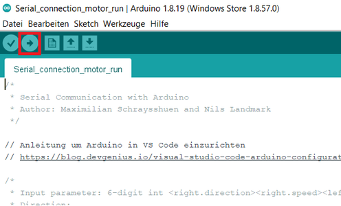

Step 9: Software - Flash the Arduino
Download the Arduino Code
Download the given Arduino code file
Download the Arduino IDE
Go to https://www.arduino.cc/en/software to download the Arduino IDE and install it.
Check Arduino IDE settings
Connect the Arduino via USB to your Computer and open the Arduino IDE. Make sure to set up the right COM port for the flashing. If you struggle with this step you can find help here: https://support.arduino.cc/hc/en-us/articles/4406856349970-Find-the-port-your-board-is-connected-to
Also make sure that you selected the right Arduino board (see picture). We used an Arduino Uno Rev3.
Flash the code
Open the downloaded code in the arduino IDE. Click on the Upload button (second picture) to flash the code to your Arduino.
