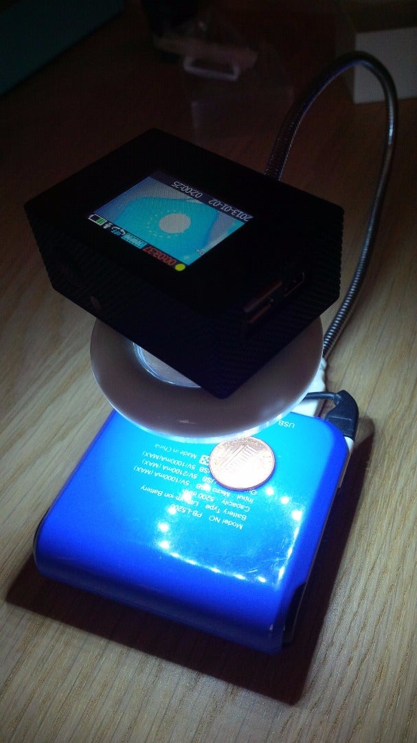

Plug your light into the USB output of the power-bank and turn on your power-bank and light. You should get a bright light and you can now position the light in a way to allow you to balance your camera. If you are worried, use some elastics to attach the camera. Also make sure the camera is over the middle of the ring light where the magnifying glass has the least distortion.

Here I have balanced the camera on the ring-light and created the proper spacing to get the best focus possible. You can see that I've placed a penny to test out the focus. You will have to adjust the zoom factor on your camera and also the vertical spacing by flexing the arm of the ring-light, as there is a narrow focus range. If you are too close or too far, the stage and item you are trying to film will not be in focus.

As you can see in the photos, I've placed a penny on the "stage" made by the power-bank. I can zoom in and focus by moving the ring-light and adjusting the zoom factor on the action camera. The writing on the stage helps with focusing. If you don't have this, just use a piece of paper or dollar bill or other thin object with fine markings so that you can see if things are in focus.
