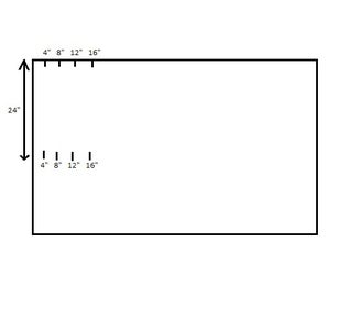

Step 1: Measurements for Drawing the Casket
On the plywood start at the corner measure 16" in from the end.  Make marks at 4", 8", 12" and 16".
Measure 24" down the side and measure and mark 4,8,12, and 16 inches as shown in picture.

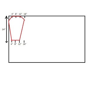

Step 2: Drawing the Casket
Using your yard stick you are going to mark your lines for cutting the casket top.
Start by drawing a line from the 4" mark to the 12" mark on both the top and the bottom.
Next draw a line from the top 4" down to the end of the board, this is approx. a 25 degree angle to make sure it is correct the line will measure 7".
Draw the line from the 12" mark but stop at the 16" inch line. It will be a 7" line just as the other side.
Draw lines from the ends of the angle down to the 4" mark from the left and 12" from the right.
See photo for details (sorry for the bad drawing)
Step 3: Top of the Casket
The drawing shows what your measurements should be.  Measure twice.
then using your circular saw cut out the casket top.

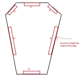

Step 7: Cutting the Furring Strips
Using your circular saw cut the furring strips in 12 pieces
for the casket sides you will cut six 5" pieces
for the top you will cut four 4" pieces and two 9" pieces
You can make the strips longer if you like.  I used materials I had laying around.
Step 8: Attaching the Furring Strips to the Top
Put a bead of glue along the length of  your tow 9" pieces.
Position centered on the 19" sides right on the edge and carefully fasten with staples.
repeat for the four 4" pieces.
see photo for details.

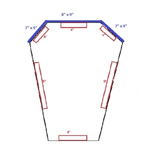

Step 9: Attaching the Sides
put a bead of glue along the side of the top 4" furring strip
position one of the 8" x 9" pieces to the side being sure it lines up staple in place
do the same thing for the angles using the two 7" x 9" pieces
the photo is a top view, the blue lines are the side pieces.
Repeat again for the 19" pieces and the final 8" piece.
