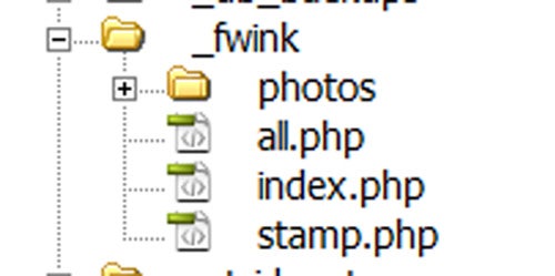

Step 2: Set Up the Folders
OK, lets start with setting up your site.
In the root directory of your site, create a folder named "_fwink" (note the underscore) .
Here is where you will save the three files:
index.php
stamp.php
all.php
You'll create these files in the next three steps.
Inside the _fwink folder, create another folder called "photos".
Here is where all of the photos will be uploaded.
You MUST name all of these files and folders EXACTLY like this, or the code will not work.

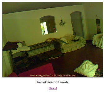

The image attached is a sample of what you'd hope to see when you have the camera set up -- a messy house, lazy animals and no zombies or robbers.
You'll set up the camera later.

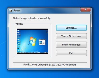

Step 6: Downloading and Setting Up Fwink
The program you'll use to capture and upload photos to your site is called Fwink.
You can download the program for free here: http://www.lundie.ca/fwink/
This program will upload a photo to your server named "webcam.jpg" -- more details on this later.
Install the program and lets get started setting up the photo uploads.
Click the "Settings..." button to set up your uploads.

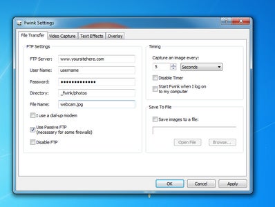

Step 7: Setting Up the Uploads
In the Settings menu, be sure you are on the "File Transfer" tab.
Under FTP Settings:
• In the "FTP Server" area, enter the name of your website. Example: www.yoursitehere.com
• Enter the username you use to acces your server, and the password.
• Set the Directory as shown in the photo:  _fwink/photos
• You may need to check off the "Use Passive FTP" if the upload is not working.
Under Timing:
• Set "Capture an image every:" to 5 seconds.

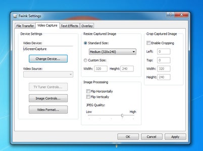

Step 8: Setting Up the Video Capture Tab
Click on the "Video Capture" tab, here is where you will select your webcam.
If your webcam is not plugged in, of course it will not be recognised.
So plug in your cam. You may need to restart the program for it to be recognised.
Under "Video Device", click the "Change Device" button.
A windo will pop up with a list of devices that are recognised by Fwink.
Select the cam you want to use.
At this point, if you have changed your cam, you will need to restart the program.
After you restart Fwink, you should see what your cam is seeing on the main menu.
Get back to Settings, and the Video Capture tab.
Under "Resize Captured Image" select the size of the photo you want to create.
Note that larger images will take longer to upload your server.

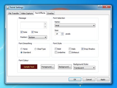

Step 9: Setting Up the Text Effects Tab
Click on the "Text Effects" tab.
This tab is pretty simple to understand.
If you want a time stamp printed on your image, check off the "Date" and "Time" boxes.
Add any of the extra effects you want, I just use the simple date and time.
Click "OK" to save your changes.

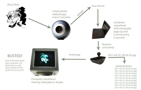

Step 10: What Is Happening Now?
So what is actually happening now?
Every 5 seconds, your webcam is taking a photo, naming it "webcam.jpg" and uploading it to your server.
The web page you have open: http://www.yourwebsite.com/_fwink/stamp.php is checking for "webcam.jpg" in the "photos" folder.
If a "webcam.jpg" is found, it is renamed with the filename "recent.jpg" and also copied to the same folder with the filename as a time stamp -- something like "2011-03-23_09-02-28.jpg"
The cam will continue to upload more photos until you exit out of the program and close the internet window with "stamp.php" running.

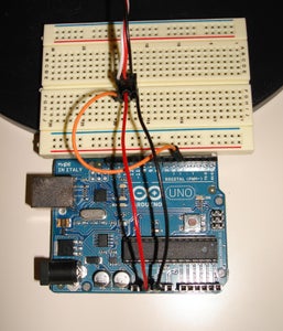

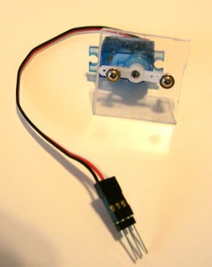

Step 11: Use a Microcontroller to Pan the Camera

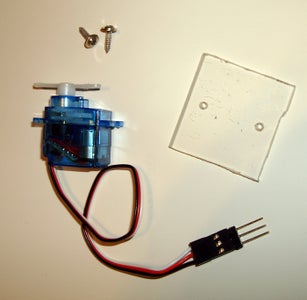

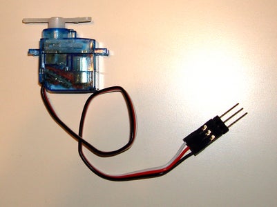

For this, you will need:
• An Arduino or DIY-Duino (make one here)
• Servo motor -- regular (180-degrees) NOT full-rotation
• Webcam
• A stand -- to secure the servo and cam
• Duct tape
• Small piece of plexi-glass
• Simple panning code (I'll give this to you)

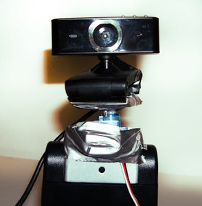

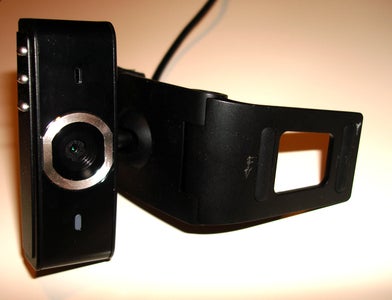

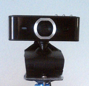

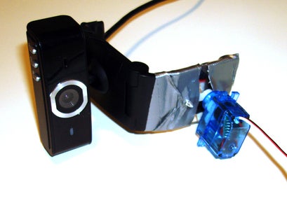

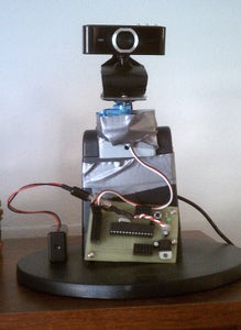

You can see how I set everything up from the photo in step 1, but I will describe it anyway.

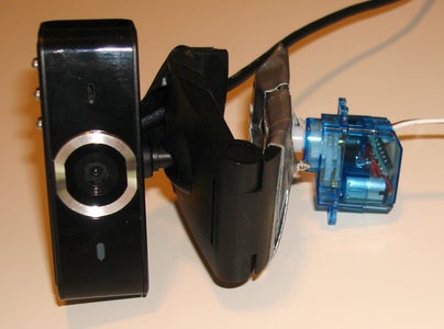

For this project, I didn't want to screw the servo directly to the base of the webcam.
So I cut out a small piece of square plexi-glass with my Dremel and used that.
I drilled holes into the plexi and screwed it to the servo.
Then, I used duct tape to secure the servo to the bottom of the webcam

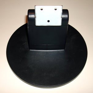

I duct-taped the servo to the stand (which was the base of an old computer monitor).
I also wrapped duct tape around the base to secure the webcam's cord, just so the cord wasn't swinging all over the place when it rotated.

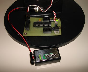

I plugged the output pin of the servo into pin 5 of my DIY-Duino, red to 5V, black to ground.
Then I plugged in a 9-volt battery to give it life.
Note: Servos suck up a lot of power, so a battery isn't going to last long.
A wall plug is you best bet for continuous, all-day power.
Check out the photos for more notes.

Step 12: Upload the Sketch
Here is the sketch to rotate the servo.
It's easily modified so you can make the turning delay, etc. anything you want.
Commented to let you know what's going on.
