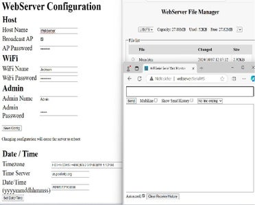

Step 4: File Manager Webpage
The File Manager Webpage is in a file (fileman.htm) and, if enabled in customize.h (#define UseFileManager true) must be on the SD or LittleFS as specified by #define StandardFiles in customize.h. You can call it up in your browser with http://webserver/fileman
To make the webserver fully functional, load the following files to the webserver the first time you use the File Manager.
  1. Main.htm: A sample webpage that is basically just a clock
  2. admin.htm: The admin webpage for changing basic settings
  3. fileman.htm: The file manager webpage which can be used to manage files
  4. SerialWS.htm: The web based Serial Monitor
  5. favicon.ico: A sample icon for the web page
Once fileman.htm has been loaded to the server, you should change embedFileman to false in customize.h because the embedded version is no longer needed now that you have loaded the fileman.htm file onto LittleFS and the embedded version is only taking up program space.
If OTA was enabled, you might take this opportunity to test loading the sketch via OTA instead of using the USB. You should see the webserver as a network port under tools.
The file manager webpage can be used to list, delete, upload and download files and create new directories on/to/from a SD card and/or LittleFS. When uploading, a progress bar is displayed. This webpage contains samples of using websockets with JSON formatted parameters.
The webpage is rather intuitive to use. The files can be sorted by name, date, or size, in ascending or descending order by clicking on the appropriate header in the file listing. The first click will sort using that column in ascending order, the second click in descending order, and the third click will return to the “natural” order (the order the files are found when reading the directory).
To download a file, simply select the desired file using the radio button to the left of the filename and click the Download button.
To delete a file, simply select the desired file and click the Delete button. WARNING: There is no request for confirmation. You click, you lose. (Which is why you might want to put the system files in the area protected from the file manager. See FMblockedPath in the documentation.)
To upload a new file into the displayed directory, first select the file by clicking on the Select File button (my example in the picture is in German and says “Datei auswählen” because the browser uses the international settings of the computer the browser is on). Then, click on the Upload button. There will be a progress bar displayed, but it really only makes graphical sense when uploading larger files.
You can switch between SD and LittleFS (if enabled in customize.h) using the dropdown. You can move between directories using that dropdown. Note that the directory “..” is used to move up one directory level.
You can create a new directory by clicking the New Dir button. A popup will appear where you enter the name of the new directory.

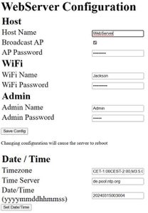

Step 5: The Admin Webpage
The Admin Webpage is in a file (Admin.htm) and must be on the SD or LittleFS as specified by #define StandardFiles in customize.h. You can call it up in your browser with http://webserver/admin. Before using the admin webpage for the first time, make an edit to customize.h and set def_FORCE to false. If you don’t set def_FORCE to false, any changes you make to the configuration using the Admin webpage will be overwritten the next time the server boots.
The admin webpage is used to configure The ESP32 S3 Webserver Project software once the server is up and running. It also provides samples of using websockets with simple string array styled parameters.
You will notice that many options of The ESP32 S3 Webserver Project, such as the use of a SD/MMC card, LittleFS or Telegram cannot be configured from the admin webpage. This is intentional. By configuring those options within customize.h, the respective parts of the software can be included or excluded. By excluding unnecessary parts of the software, more space is available for LittleFS (though the Flash Partition may need to be tweaked).
When configuring your webserver:
Host Name: The name given here forms the address for webpages and OTA (if implemented) as well as for the access point (with AP added to the end). The host name must be 4 to 32 characters long. The first character must be A-Z or a-z.
Broadcast AP: If checked, anyone looking for networks in the area will see this access point. If set to false, the name of this access point will not be listed as an available network and they would have to know the name and type it in in order to attempt to access the access point.
AP Password: Must be between 8 and 16 characters. It must have at least one character from at least three of the following four groups: A-Z, a-z, 0-9 or a special character (such as !, ., +, -, or #).
WiFi Name: Must, of course, match your local WiFi name for this server to access your local WiFi. If blank, no WiFi connection will be made and the webserver will only be available over the access point it provides. Without a WiFi connection, time synchronization and Telegram are, of course, also not available.
WiFi Password: Will be ignored if no WiFi name is provided.
Admin Name: Must be 6 to 16 characters long. The first character must be A-Z or a-z. (Yes, the default of “Admin” violates the rules und therefore MUST be changed. This is intentional!) The same logon and password are used for the file manager and SerialWS web pages if they are implemented.
Admin Password: The rules are the same as for AP Password. (Again, the default value of “Secret” violates the rules and therefore MUST be changed and is intentional!)
Timezone: The time zone defines your local time zone and daylight savings time implementation. The entry must be 4 to 50 characters long. Further rules apply simply because timezones have a specific format of how they are expressed. (NOTE: Don’t blame me for the syntax of the entry. I didn’t invent it! It is an international standard.)
If you live in the Eastern Time zone of the US, your entries might be:
EDT+5:00EST+4:00,M3.2.0/2:00,M11.1.1/2:00 and us.pool.ntp.org
In Germany, our timezone data is CET-1:00CEST-2:00,M3.5.0/2:00,M10.5.0/3:00
That entry is interpreted as:
CET and CEST represent the name of the time zone during daylight savings and standard.
-1:00 and -2:00 are the offsets from this time zone to UTC/Greenwich during daylight savings and standard. M3.5.0/2:00 and M10.5.0/3:00 indicates that time changes in month 3 (March) and 10 (October) on the last (1-4 indicates which occurrence and 5 indicates the last occurrence) Sunday (0, Monday is 1, Saturday is 6) at 2:00 or 3:00 AM (24 hour clock).
Time Server: Must be between 8 and 35 characters long. Of course, in order for time synchronization to work, it has to be a valid internet time server. It is strongly recommended to make this entry a “pool” of time servers (indicated by the presence of “pool” in the server name). If in doubt, pool.ntp.org will always work but may be less accurate than using a server closer to your location. Tip, your WiFi router may even provide a time server of its own!
Date/Time: Must be exactly 14 numeric digits expressing the date and time in yyyymmddhhmmss format. (Year, month, day, hour, minutes, seconds) If a WiFi is available, the date and time will be synchronized to the Time Server periodically so this setting only makes sense if no WiFi is available. If there is no WiFi, this setting will need to be manually made each time the server boots.
