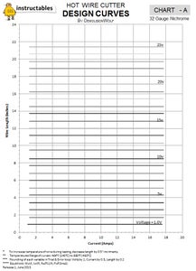

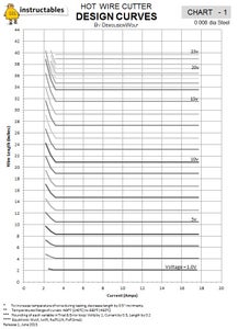

Step 1: How to Design a Hot Wire Cutter (Design Charts Introduction)
Picking your hot wire length, diameter, material, and power source will be a balancing act, but it can be done! I've found that the power source is the biggest head ache, so we will start there with an example.
***** All of the Design Charts are based on a AC to DC wall adapter. Meaning the output is in DC (direct current) not AC.*****

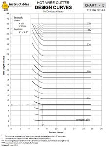

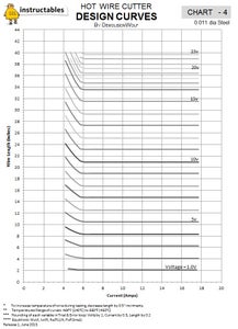

Example - Lets say I have an AC to DC Adapter and it can output 4 Volts and 7 Amps and I want to use a 0.012" diameter guitar string. (Don't worry, I will show you how to find these numbers and decide these numbers later)
Procedure - Looking at the Hot Wire Design Chart - 5 (on this page), I will find the 7 Amps on the x-axis. From here I will move vertically till I find the curve that represents 4 volts (see chart). At this intersection, move horizontal to the y-axis. The value on the y-axis is about 8.2 inches; this is the length of my hot wire. Rounding up or down to 8.0" or to 8.5" is best, because these curves mostly represent an average of allowable lengths which will work with this power source. In fact, you can even round up or down as much as two inches when using the lower voltages on a chart.
Results - Chart-5 is for guitar strings (steel) which have a diameter of 0.012 inches, or in guitar lingo "a 12." So, my final design would be an AC/DC Adapter which can output 4 volts and 7 amps and a 12 guitar string which is 8 or 8.5 inches.

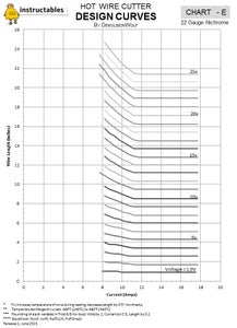

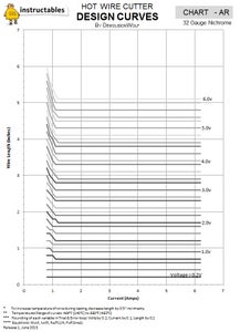

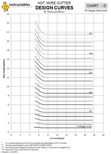

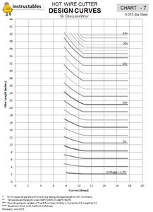

Charts numbered 1-8 are for cutters using guitar strings.
Charts numbered A-E are for cutters using nichrome wire.
Each chart represents a different diameter of wire. In our example above we used Chart-5, because I wanted to use a guitar string with a diameter of 0.012". If I wanted to use 28 gauge nichrome wire, i would use Chart-B.

What if the Volt curve for your adapter isn't on the Chart?
Draw it in. Just stay between the volt curves that sandwich the curve you are going to draw.
What if the amps never intersect the volt curve? (left of curves)
Then the AC adapter you picked doesn't have enough capacity to withstand repeated uses of cutting before it frys-to-death.

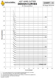

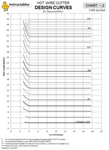

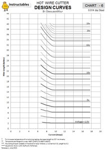

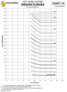

Step 3: Appendix - Steel Wire Charts (Guitar String)
Steel Wire (guitar string) Charts:
Chart 1 - 0.008 diameter wire
Chart 2 - 0.009 dia

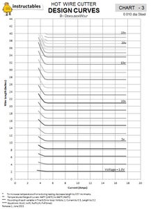

Chart 3 - 0.010 dia
Chart 4 - 0.011 dia
Chart 5 - 0.012 dia
Chart 6 - 0.014 dia
Chart 7 - 0.015 dia
Chart 8 - 0.016 dia

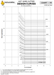

Chart 1R-0.008 dia Lowest possible risk design (least voltage and current required)

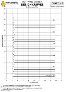

Step 4: Appendix - Nichrome Wire Charts
Nichrome Wire:
Chart A- 32 Gauge
Chart B- 28 Gauge
Chart C- 26 Gauge
Chart D- 24 Gauge
Chart E- 22 Gauge
Chart AR - 32 Gauge (Low risk design. Low voltage and current designs)
