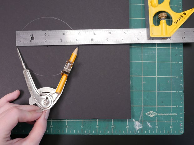

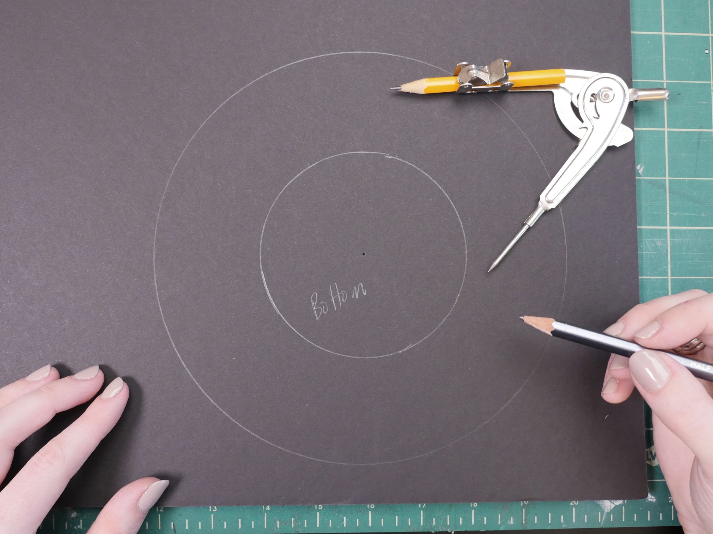

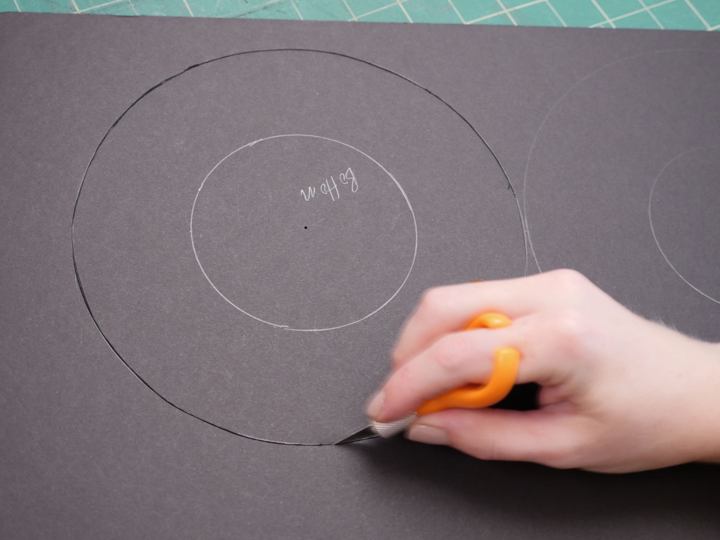

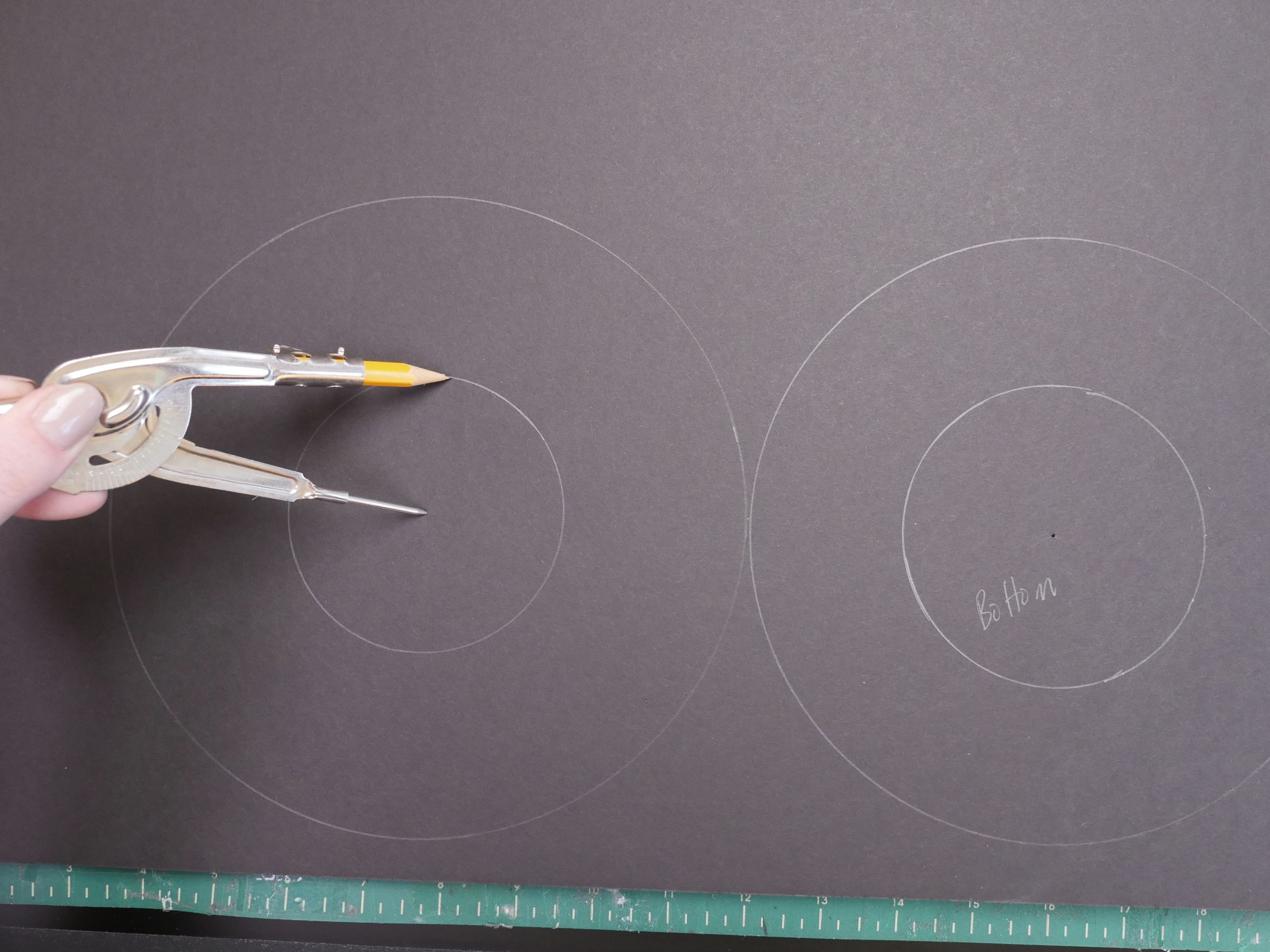

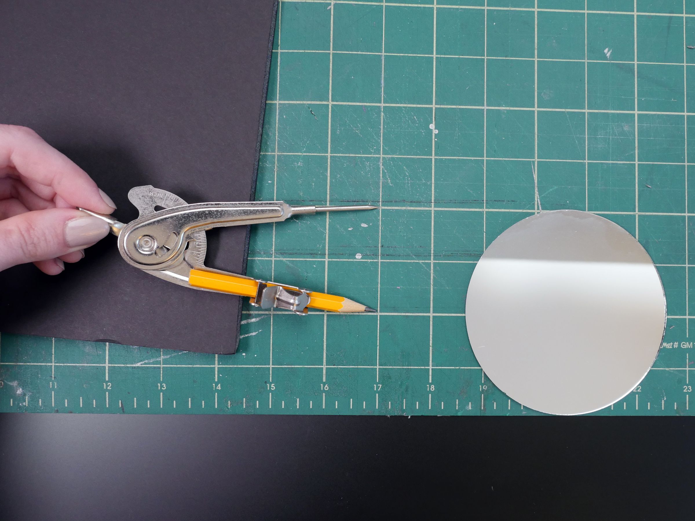

There are two ways to create the shapes you'll be cutting: print out the template, or draw the shapes with a circle-drawing compass. There is no distinct advantage in either, but your skills and tools might sway you one way or the other. The template is available as a tiled PDF for letter-sized paper, which you'll tape together and use a glue stick to adhere it to your foamcore. There's also an untiled version of the template file in case you want to print it on a large format printer or make changes.

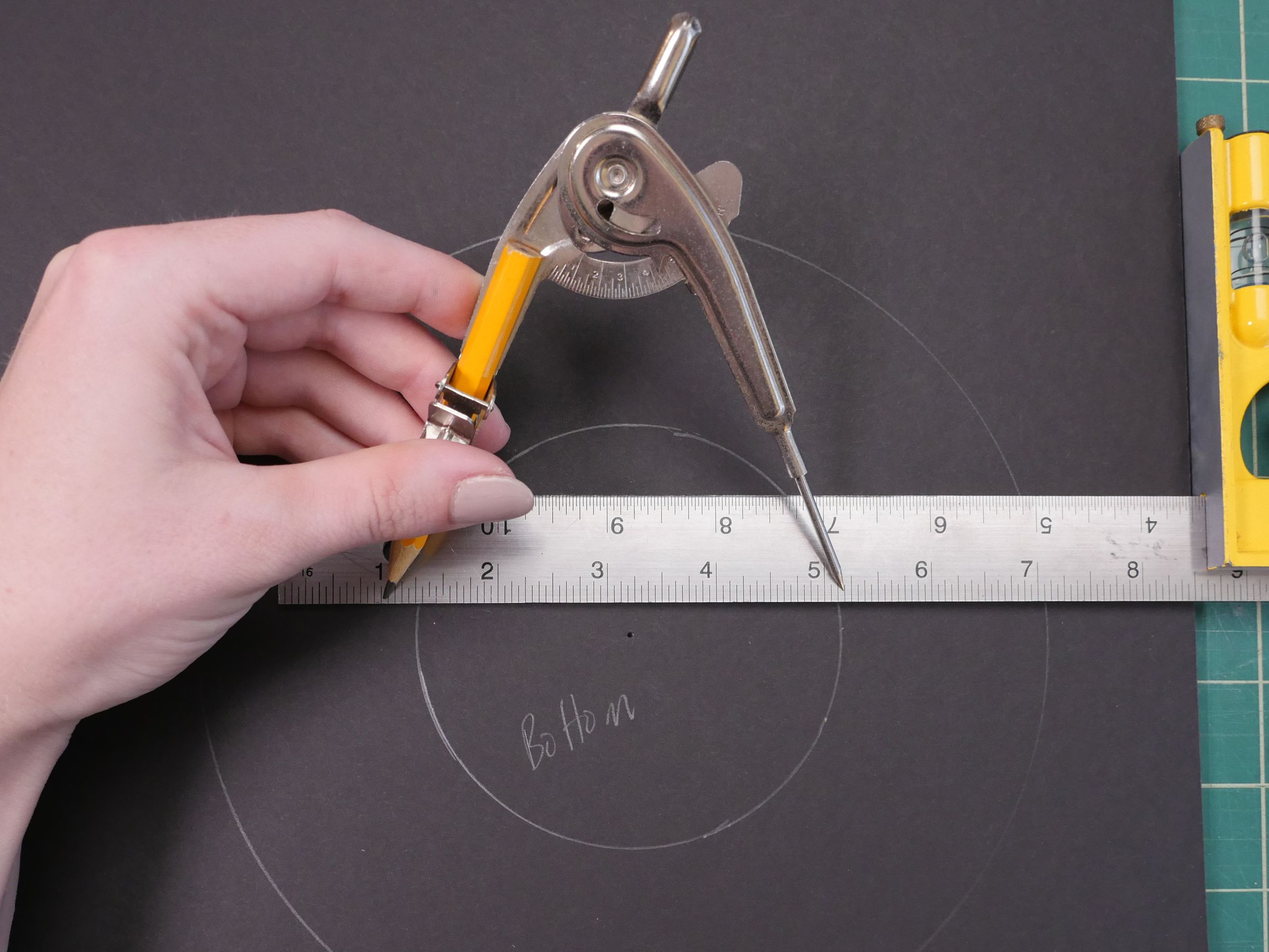

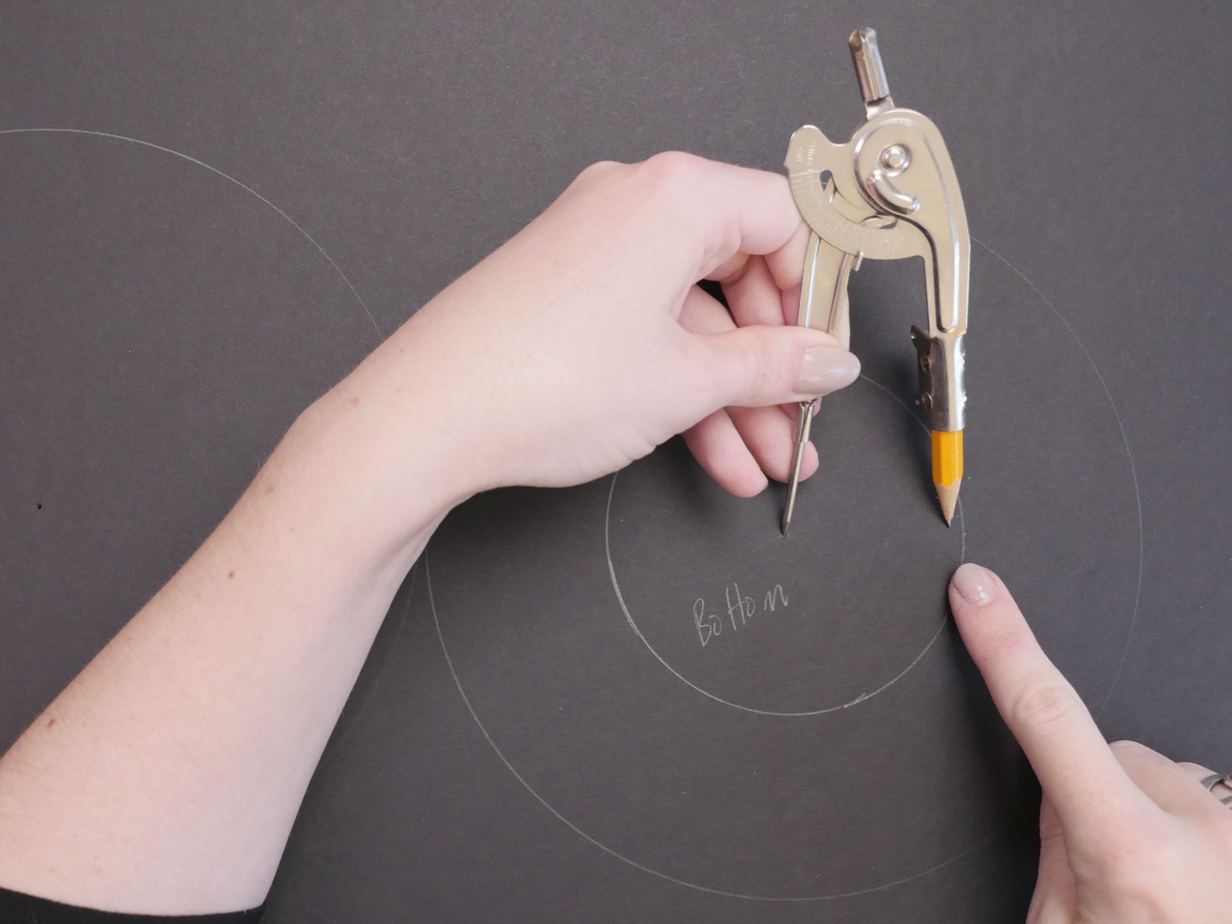

It's really simple to draw the shapes by hand, though, I promise! First draw a circle to match your mirror size by setting the compass to its radius (4" mirror = 2" radius) and drawing a circle on your foamcore at least 5 inches from each edge. Sure, you could just trace the circumference of the mirror, but then you'd have to find and mark the center! The compass makes an indentation at the center point that's handy for making the second concentric circle.

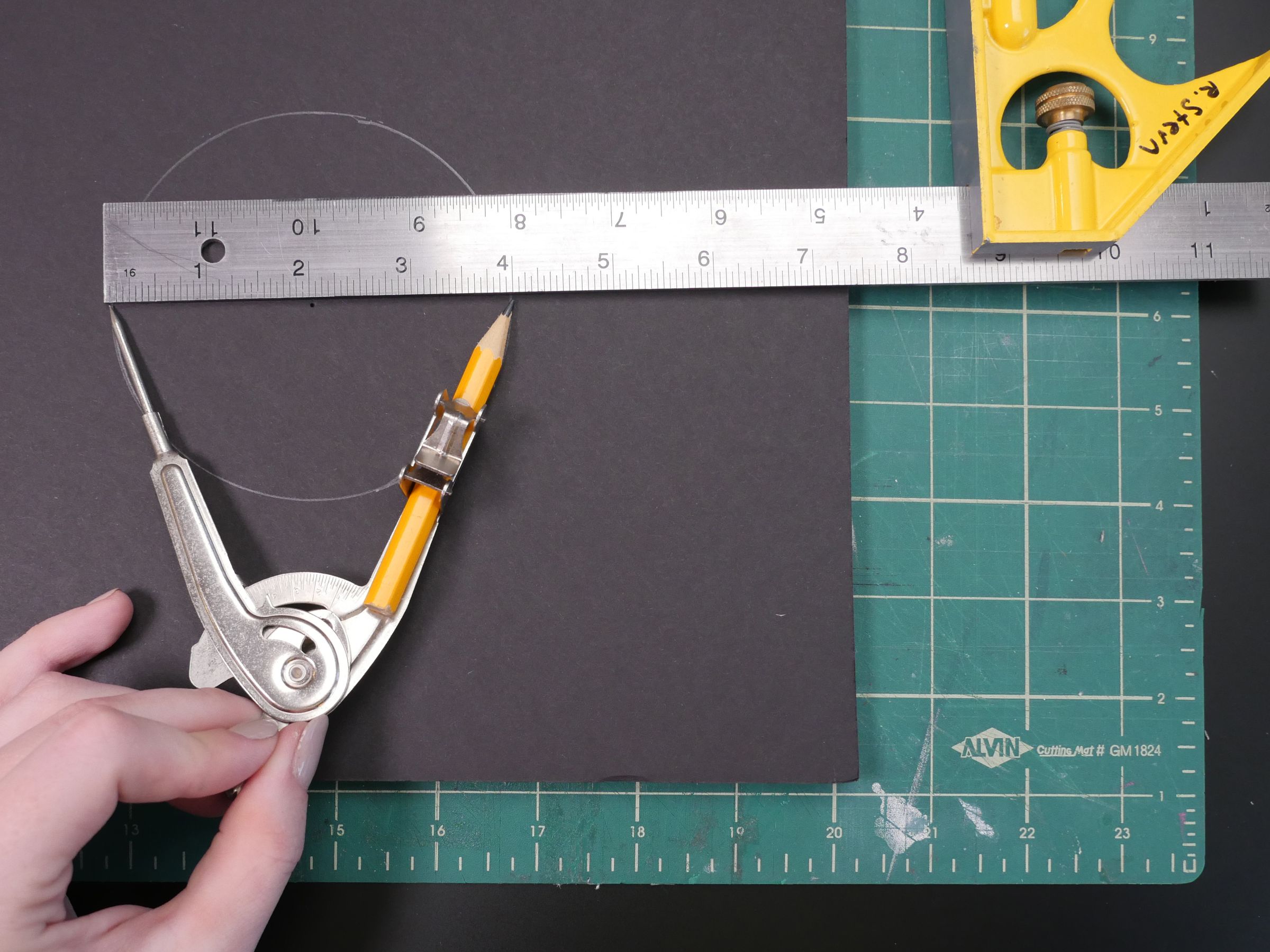

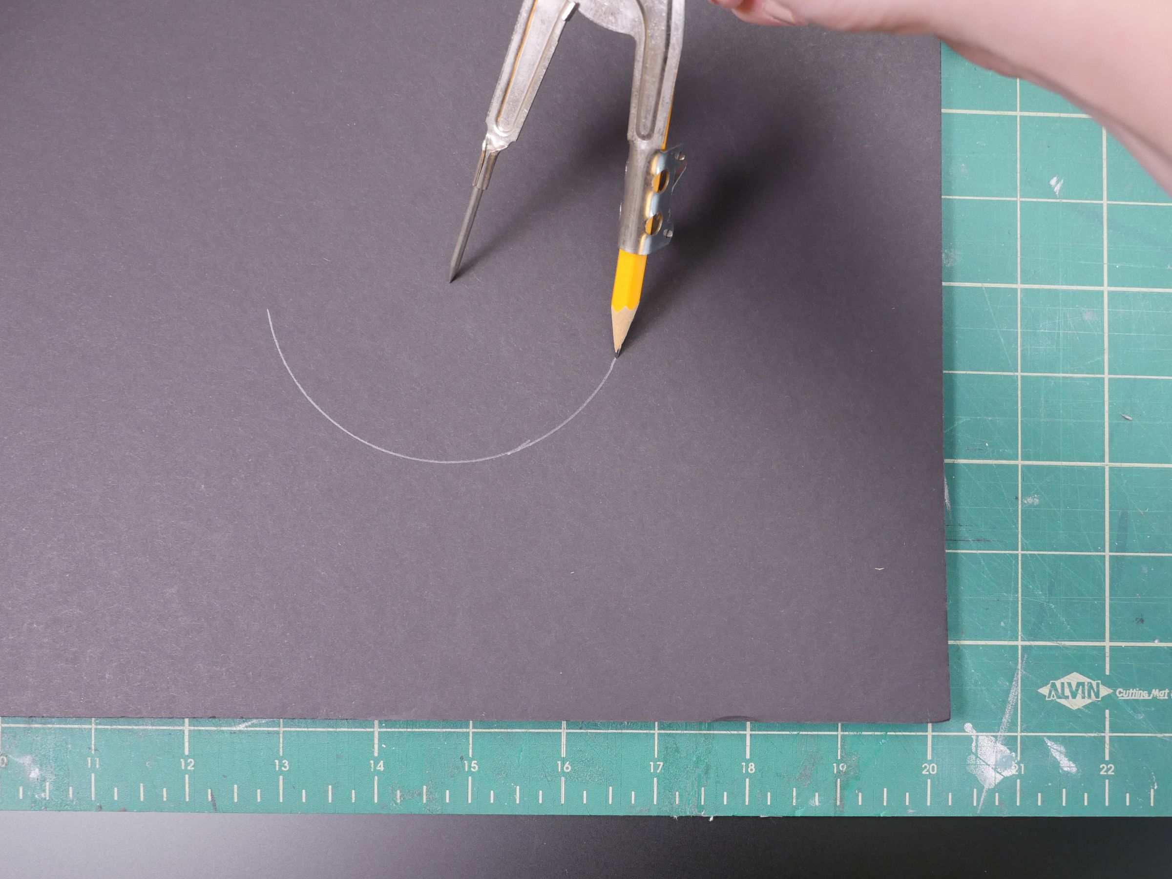

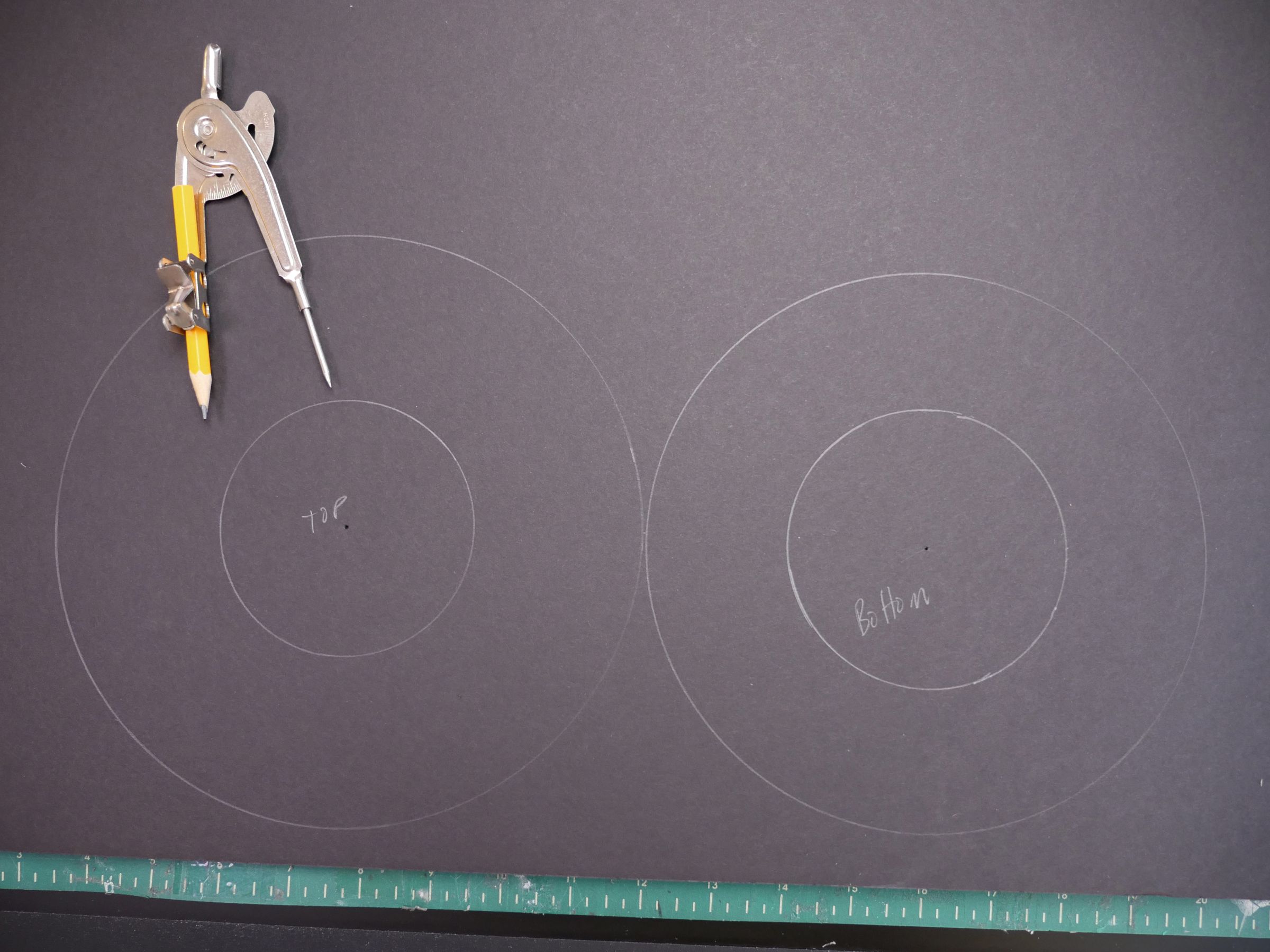

Now widen your compass to 4" and draw out the bigger circle around the first. This is the complete bottom/back of your mirror— label it as such.
The top/front piece needs to be just a bit bigger, so widen your compass to 4 3/16" and draw it out at a safe distance from the bottom piece.
The viewing window should be just slightly smaller than the mirror, though it's not important exactly how much. Set your compass to about 1/8 inch smaller than the mirror radius, and then draw out the circle using the same center point as the larger front/top perimeter.
Label this piece within the smaller circle, which will be cut away in a few moments.

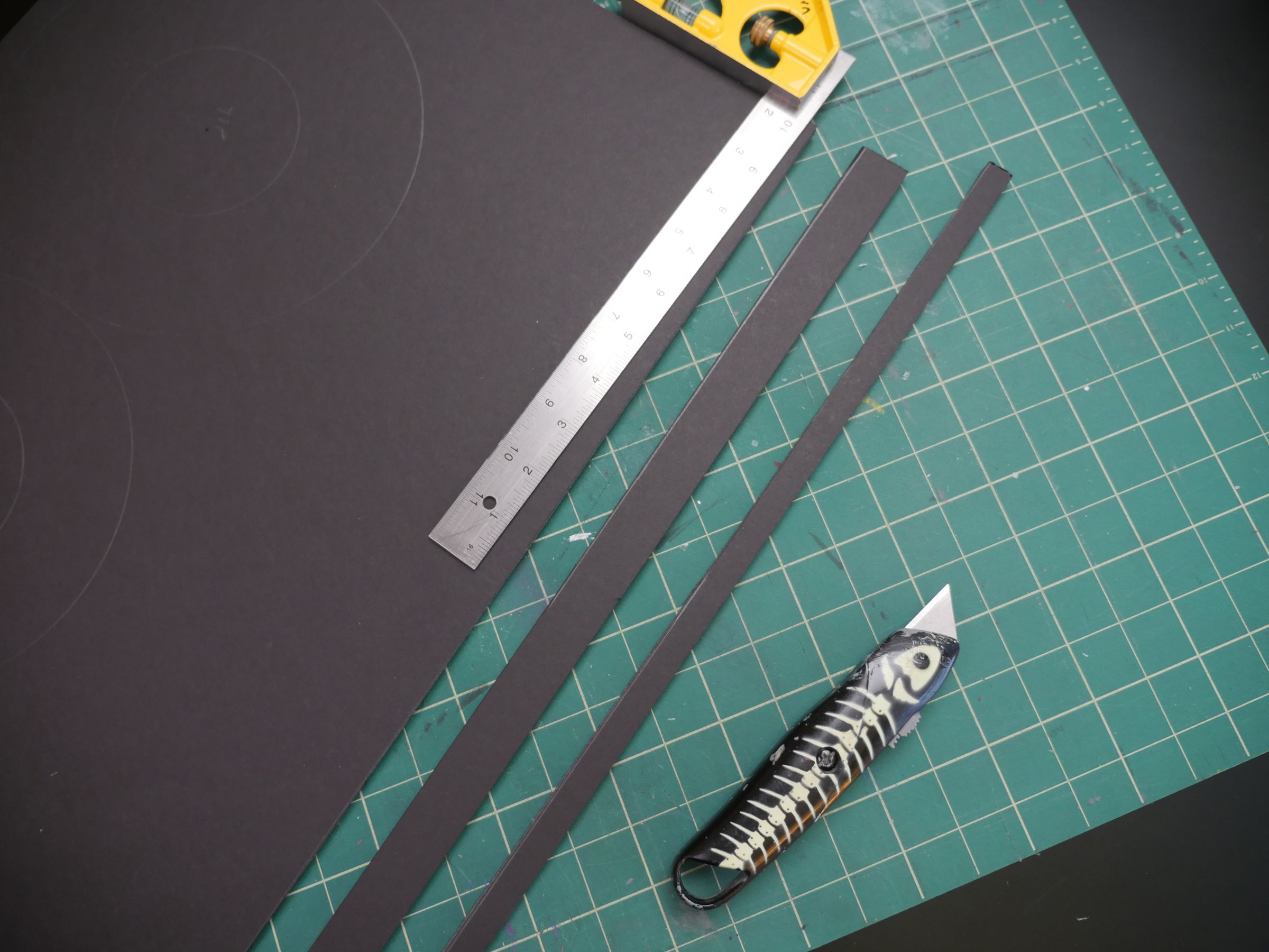

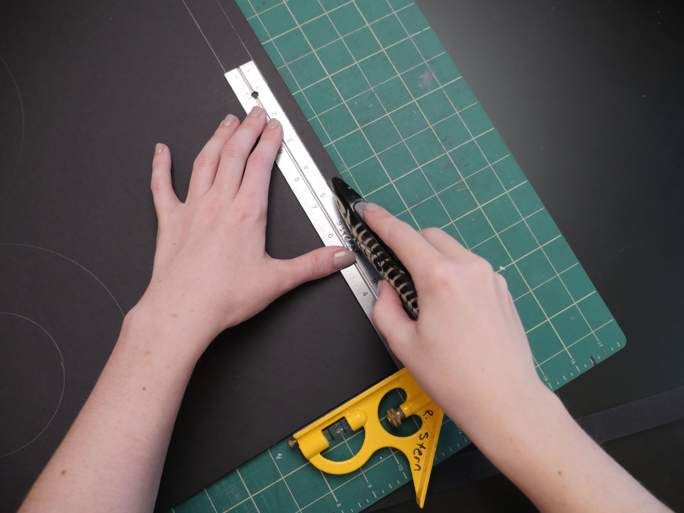

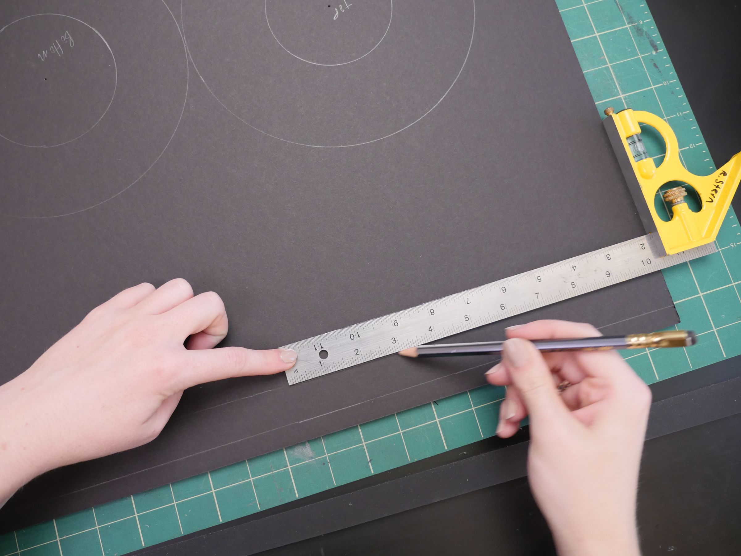

Along one long side of your foamcore, mark and cut one strip at 1/2" wide, and another at 1" wide.
The narrow strip will hug the mirror and support your NeoPixel strip, while the wider one will form the outer wall of the circular frame.

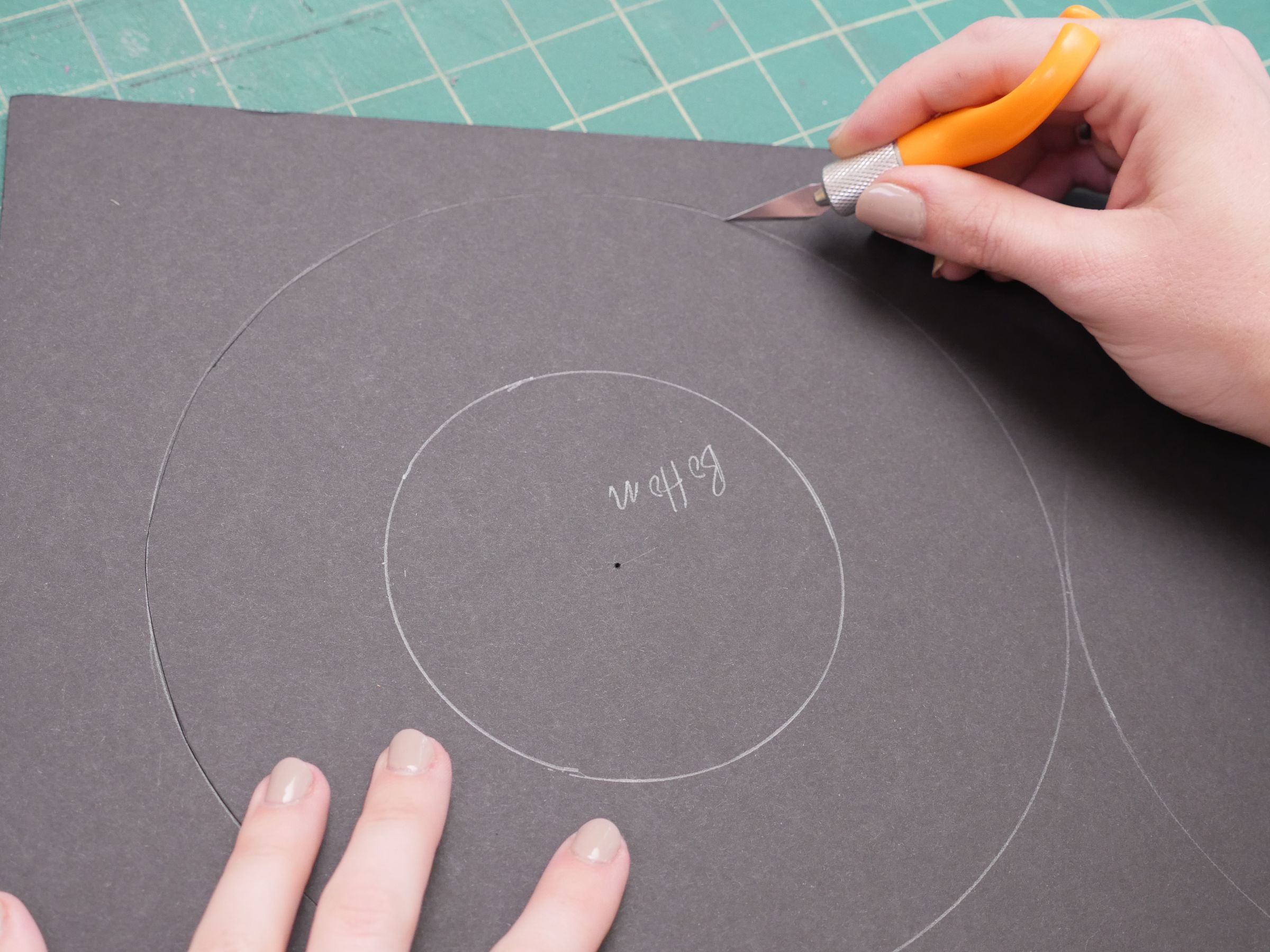

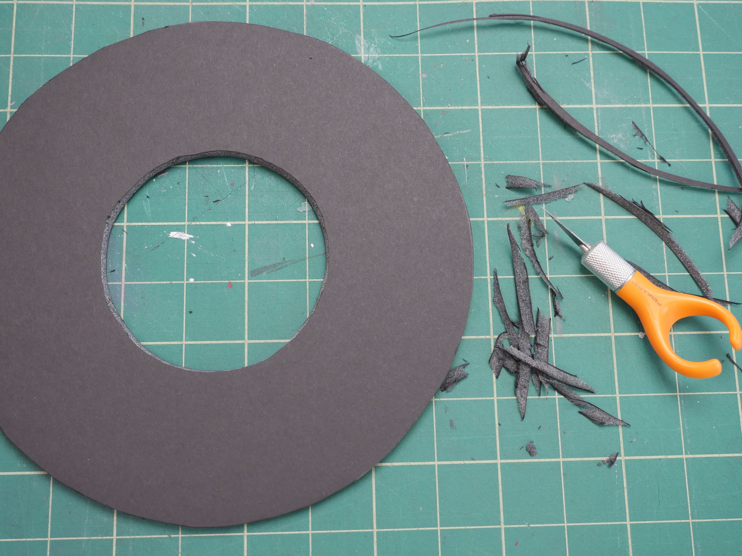

Onto cutting the circles! Some finesse and patience are helpful here. I like to use a smaller craft knife for cutting circles because I feel like I have more control. The particular knife I'm using here takes regular X-acto blades, and I found it in the scrapbooking aisle.
First, lightly drag your knife around the entire circumference of the bottom piece, only piercing the top layer of paper. During this pass you're free to angle the blade however is most comfortable and produces the most precise shape.
Cut around the circle once again, tracing the line you made in the previous pass. This time, pay attention to your blade angle, which should be 90 degrees (straight up and down). Press firmly as you make this cut, and keep your fingers out of the blade path. Pick up your board and check to see if you cut all the way through. Make one more pass with your blade to cut through any remaining spots along the perimeter.

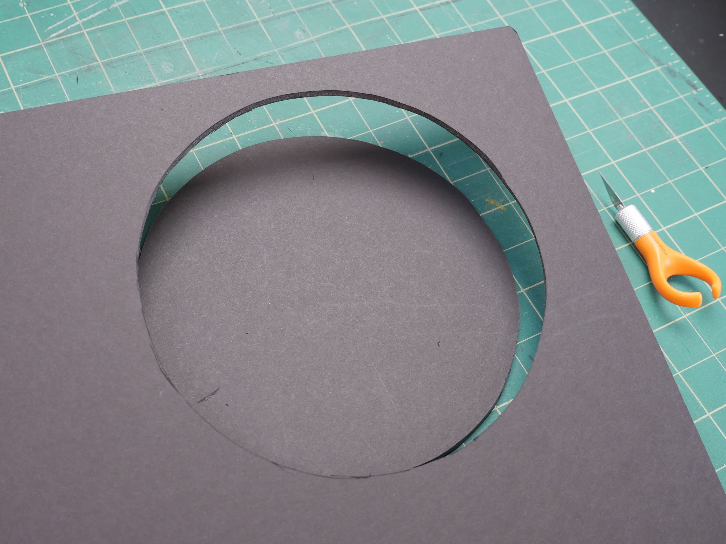

Next up, cut out the top piece, and then cut out its inner circle. This piece is seen more than any other, so give it a little extra cleanup to straighten up any edges that are uneven.

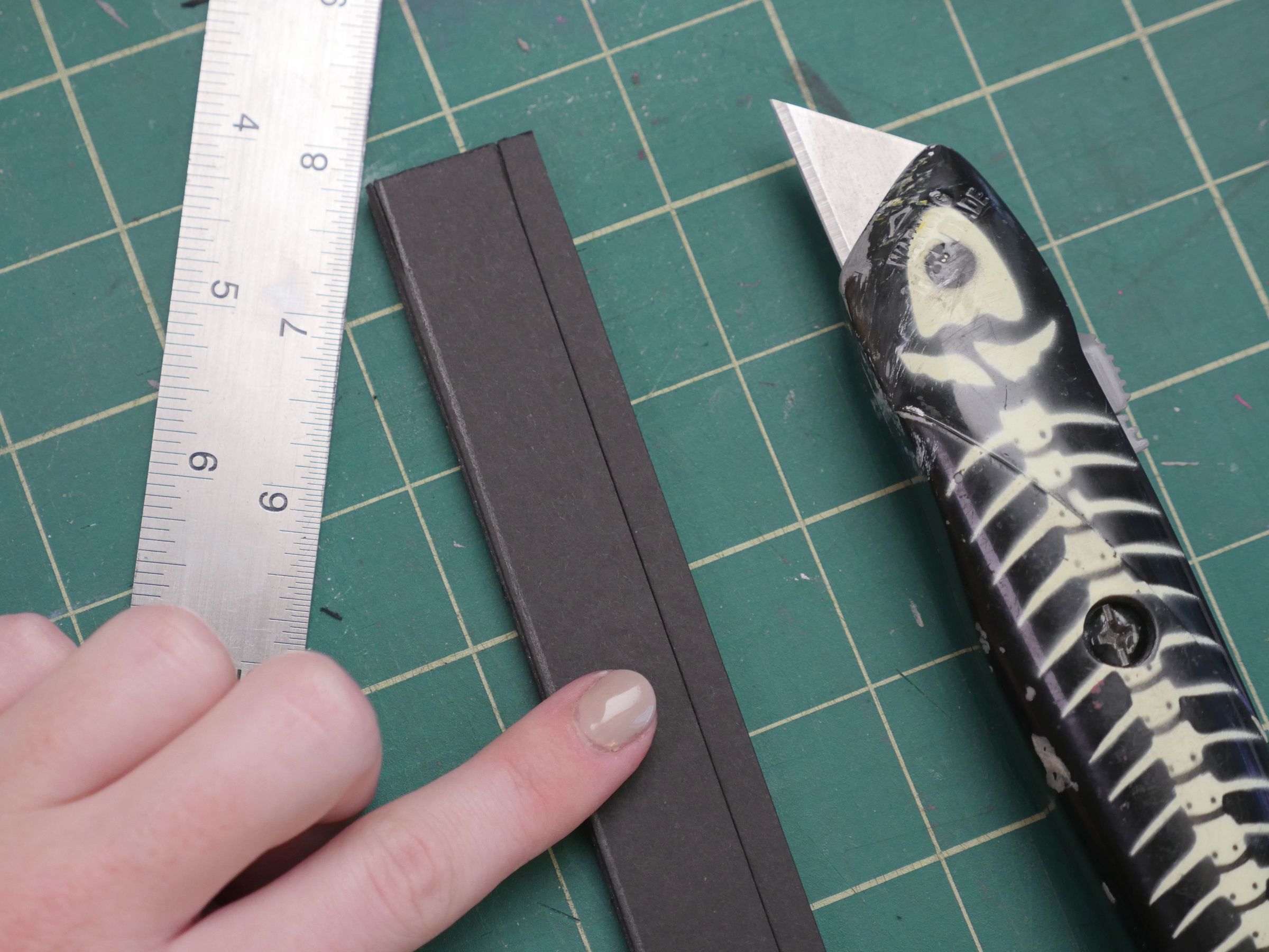

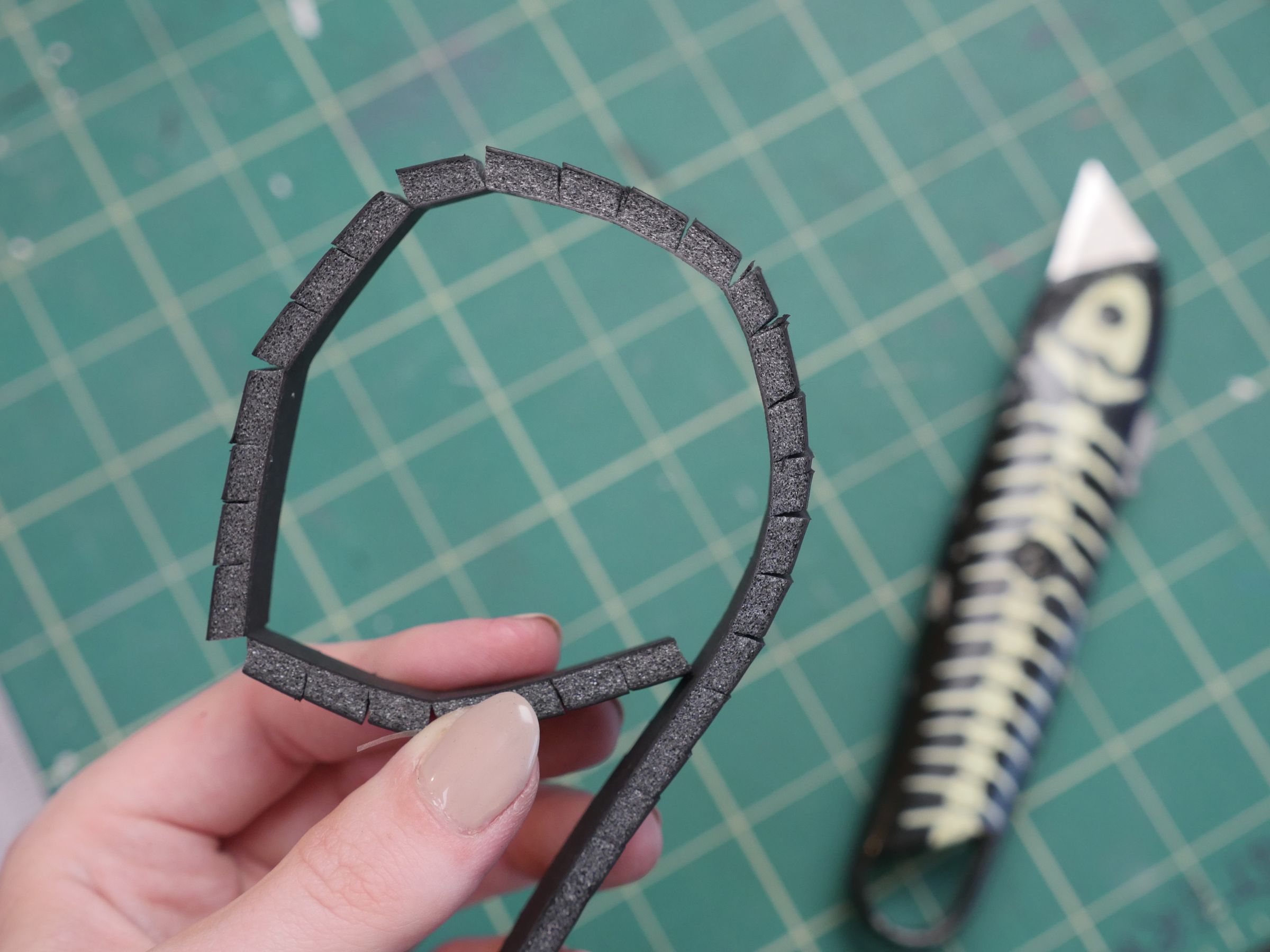

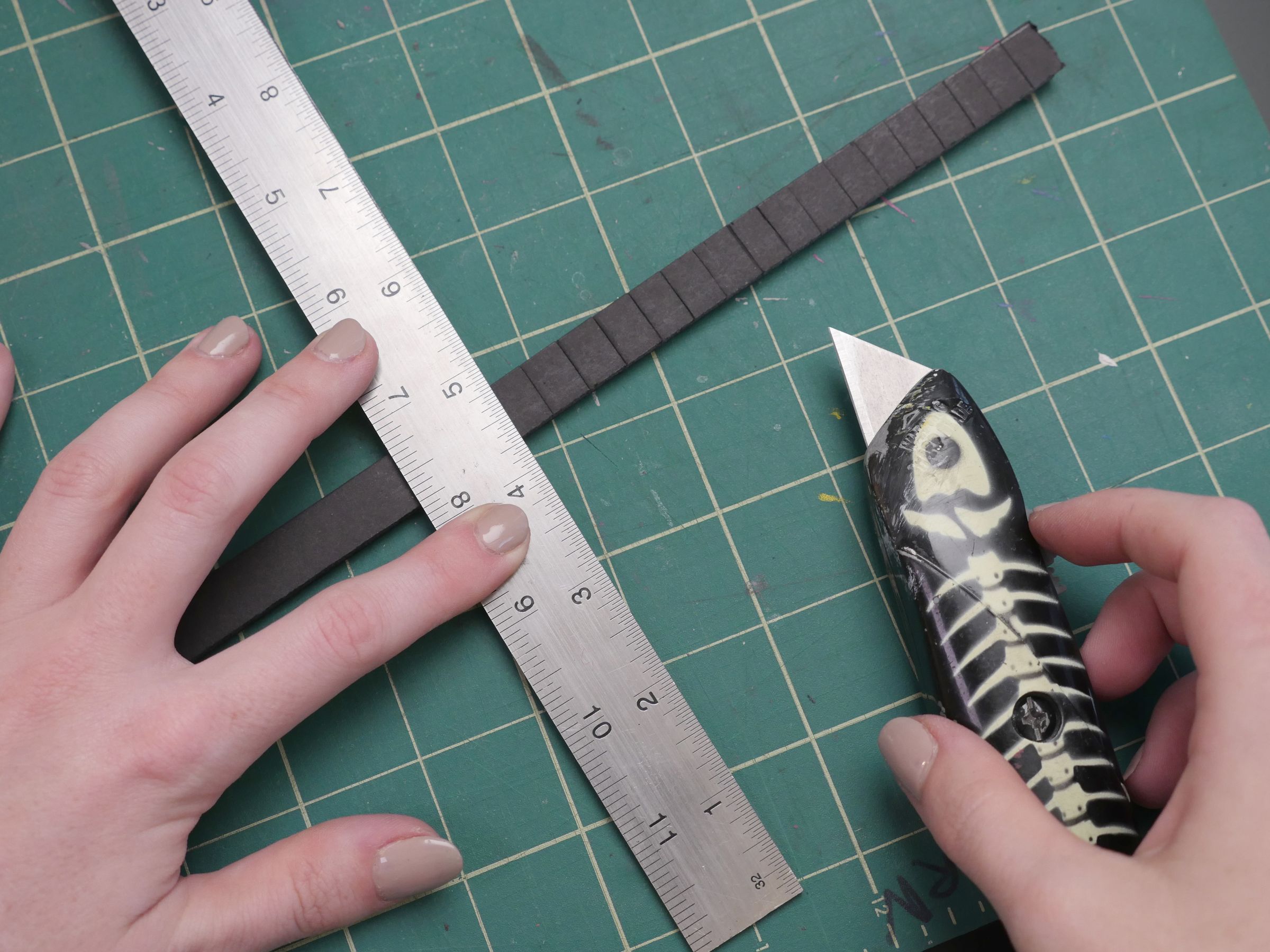

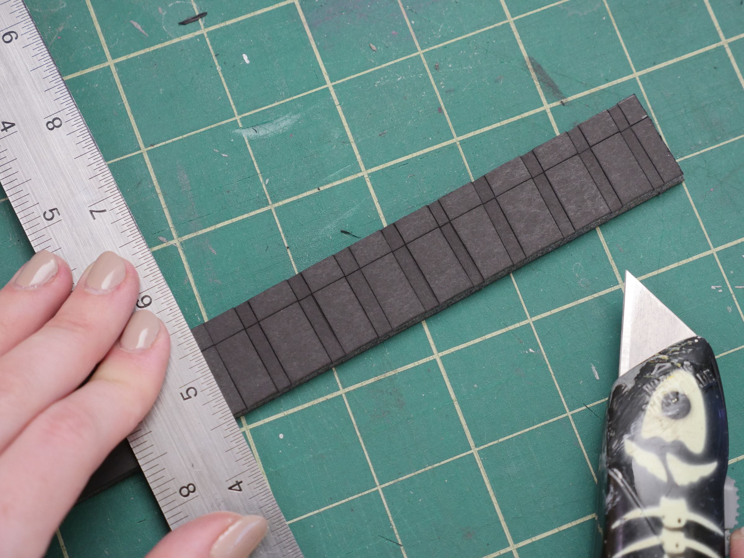

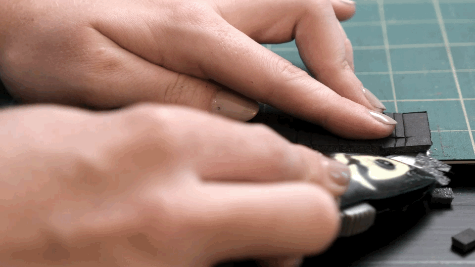

For the curved inner ring, make cross-cuts every 1/4" or so along the thinner foamcore strip, but don't cut all the way through! It's easier than it sounds— just make two light passes and you'll get the hang of it quickly. These cuts allow the piece to curve while providing a smooth interior surface.
The outer frame piece needs to put it's best face outward, so we'll make cross cuts in a slightly different pattern. First prep for the lap joint by scoring a line 3/16" from the edge. Make gentle cross-cuts along the strip, alternating thick and thin sections about 3/8" and 1/8", respectively.
To remove the material where the edge will lap, place the strip along the cutting surface edge and slide your knife horizontally to shed the foam excess, leaving the bottom layer of paper intact.

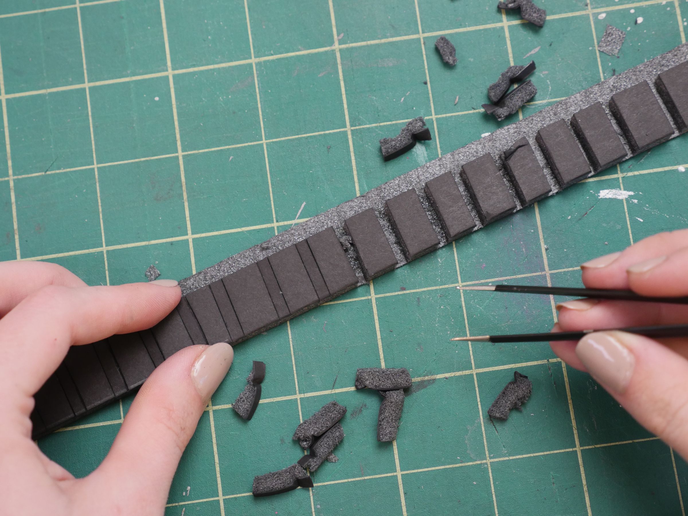

Now remove the thin sections by yanking them out with a pair of tweezers or pliers. They release with a satisfying popping sound. With that extra space, the strip can now curve in on itself and form the clean outer shell of the project!

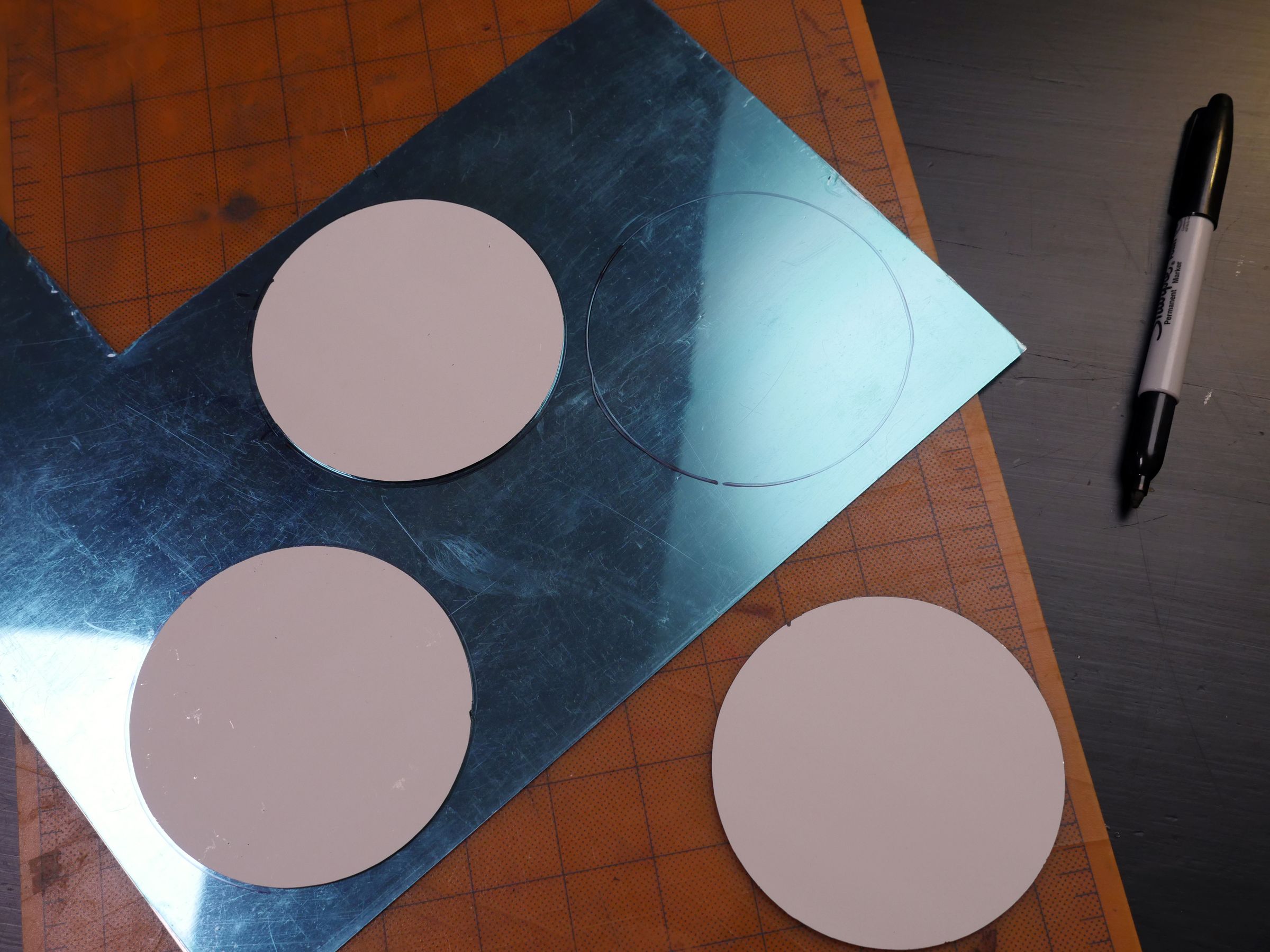

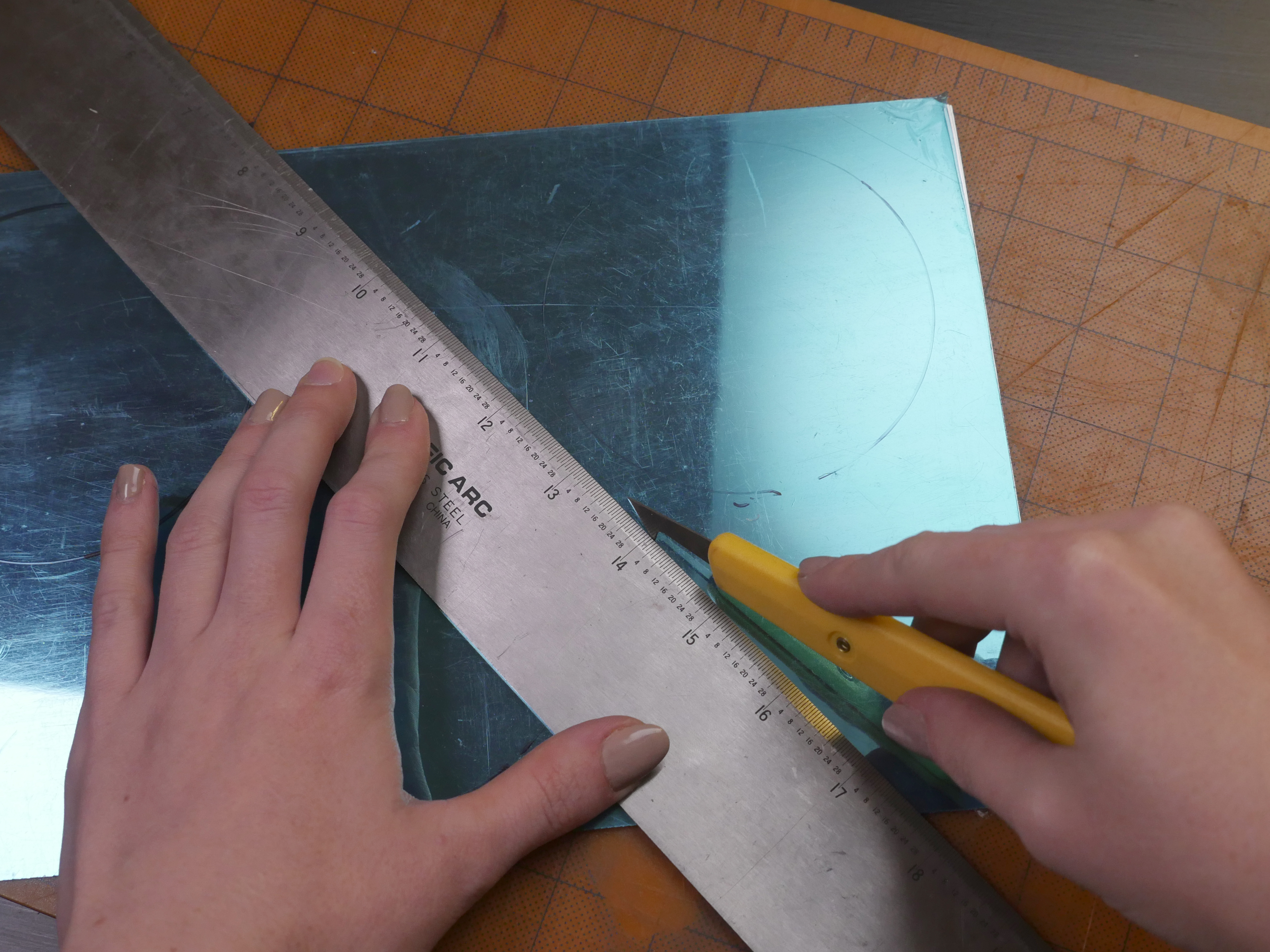

Cut a piece of your see-through mirror plastic to be larger than your mirror, but smaller than the outer frame. Don't bother trying to cut it in a circle. If you have a plastic scoring knife, that's best. Drag the gouge along your ruler a few times, then snap the plastic along the score. However a utility knife easily cuts this thin material as well, albeit with some flaking of the mirror material along the cut edge, which will be hidden inside the frame anyway.

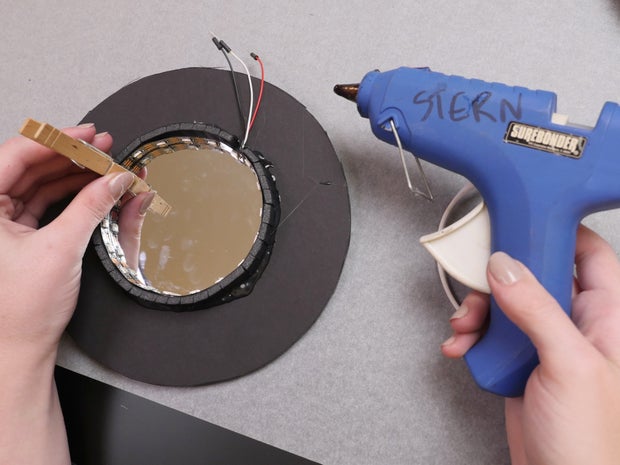

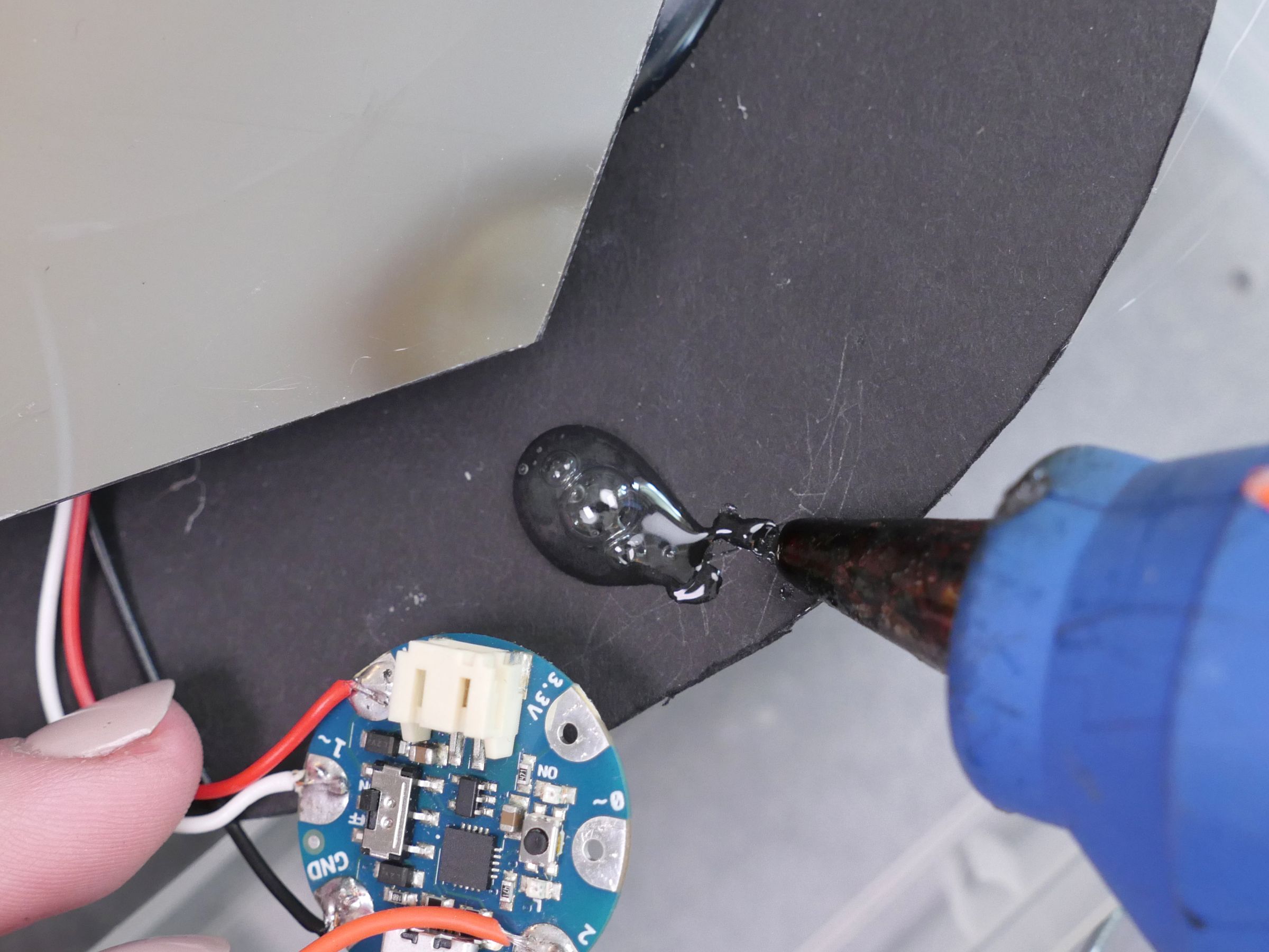

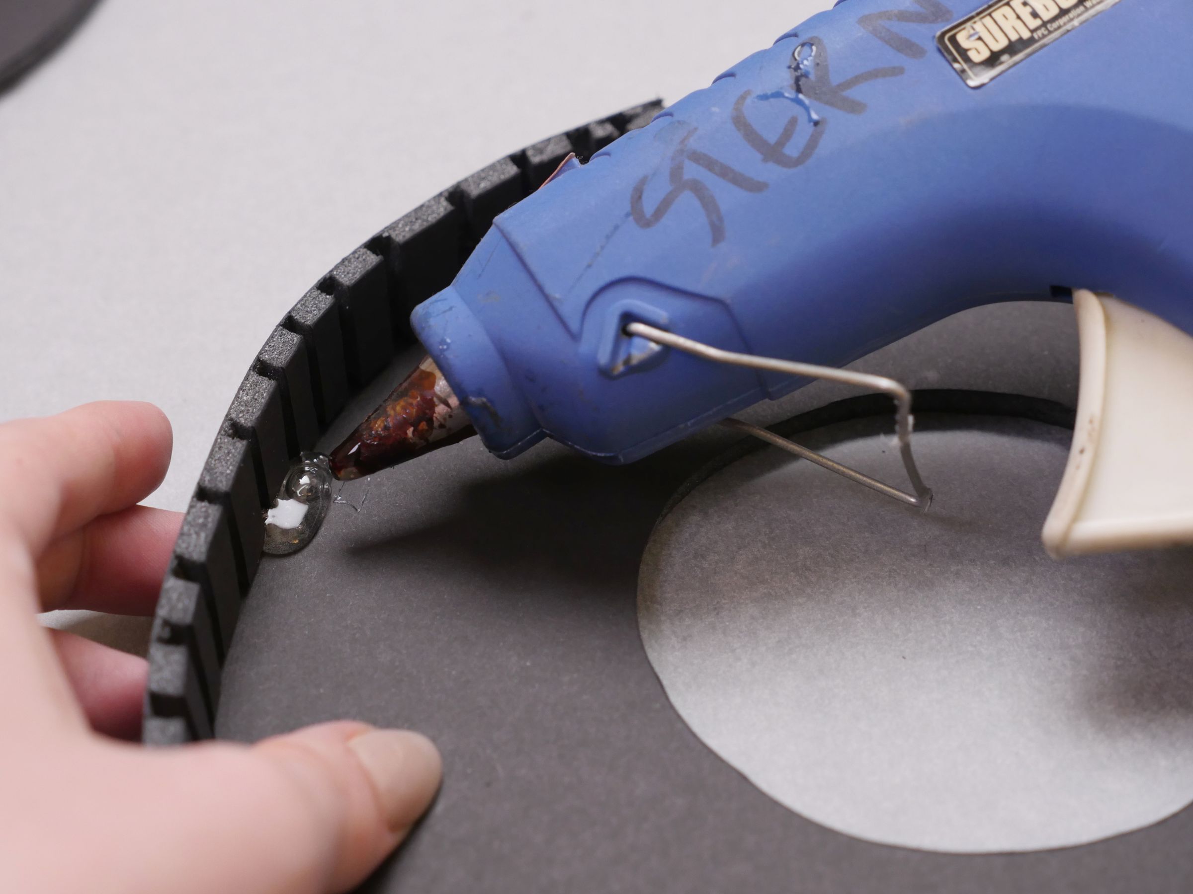

Protect your work surface with some scrap material. Heat up your glue gun and prep a bowl of ice water to keep nearby, in case you burn yourself. You can use different adhesive(s) for this project if you prefer.

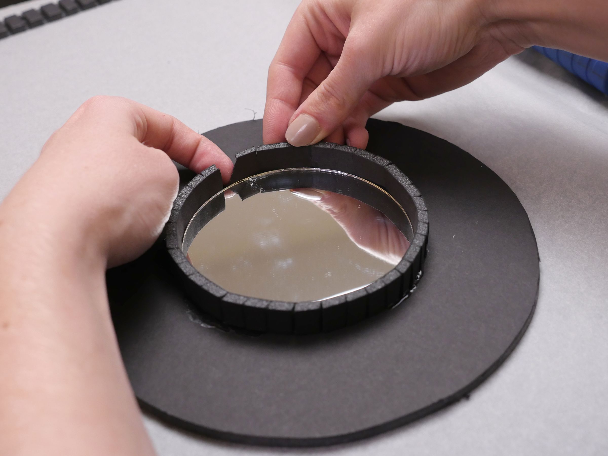

Apply a dollop of glue on the center of the bottom circle and stick your mirror to it. Rotate and squish the mirror against the foamcore gently, aligning it with the marked circle. Then glue your thin strip to the perimeter of the mirror and tear off any excess, leaving a small gap for wires to pass through.

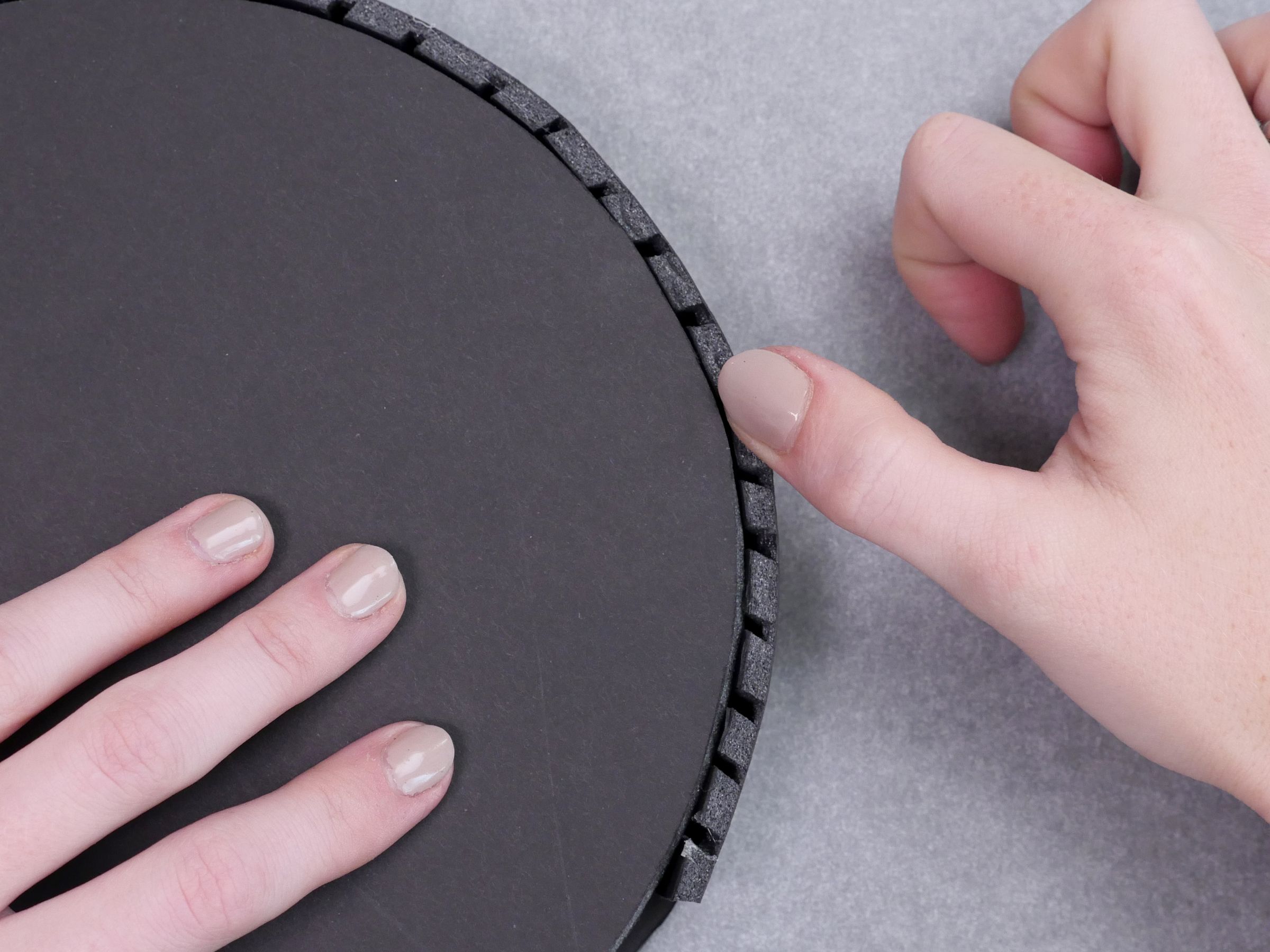

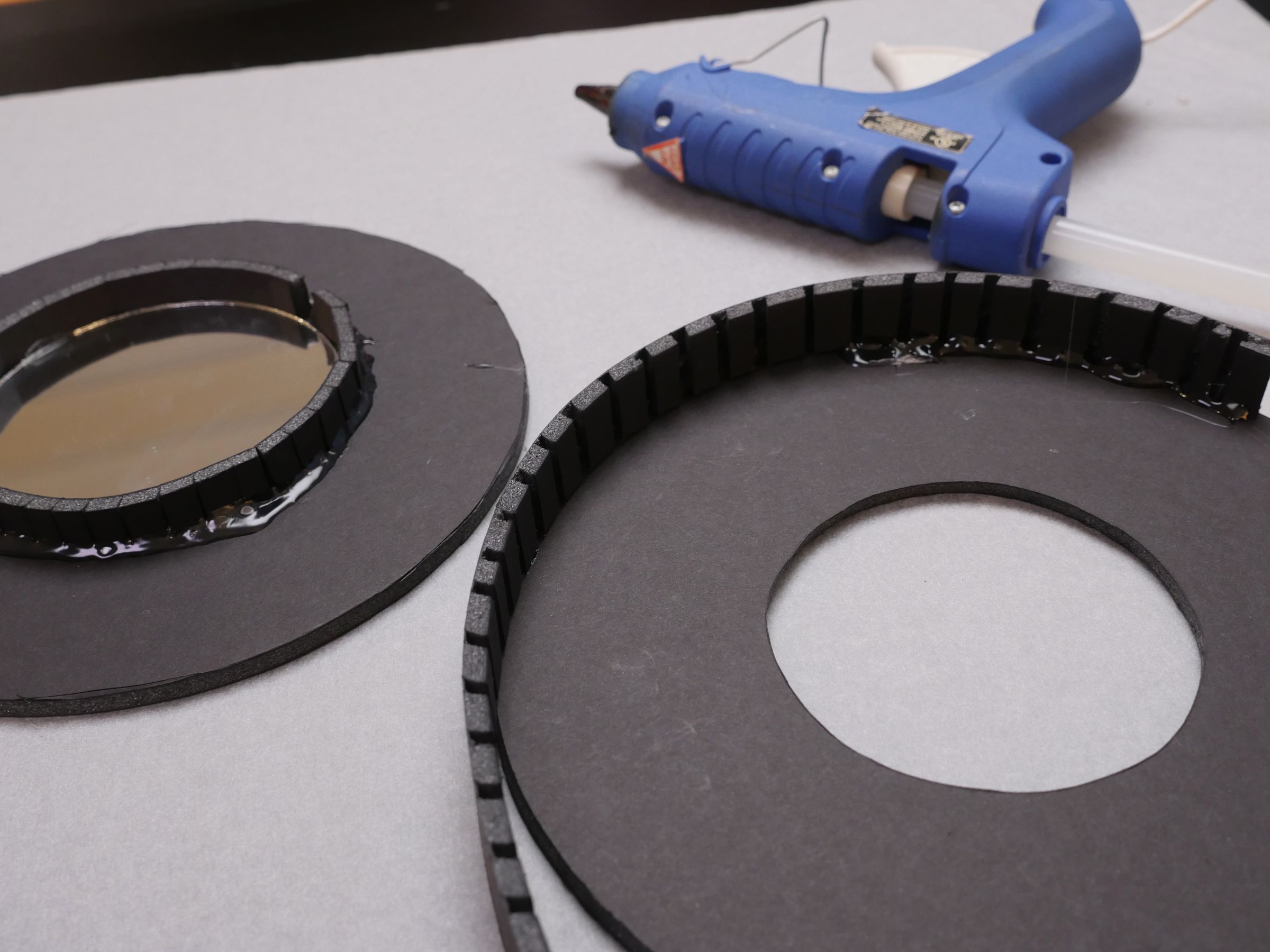

Place your front "donut" piece face down on the work surface and glue on the lapped edge. Repeatedly press these pieces together and down on the work surface as you glue around the go, so the front edge turns out nice and clean. The outer rim won't go all the way around and that's ok— you can choose to close up this gap later if you want.

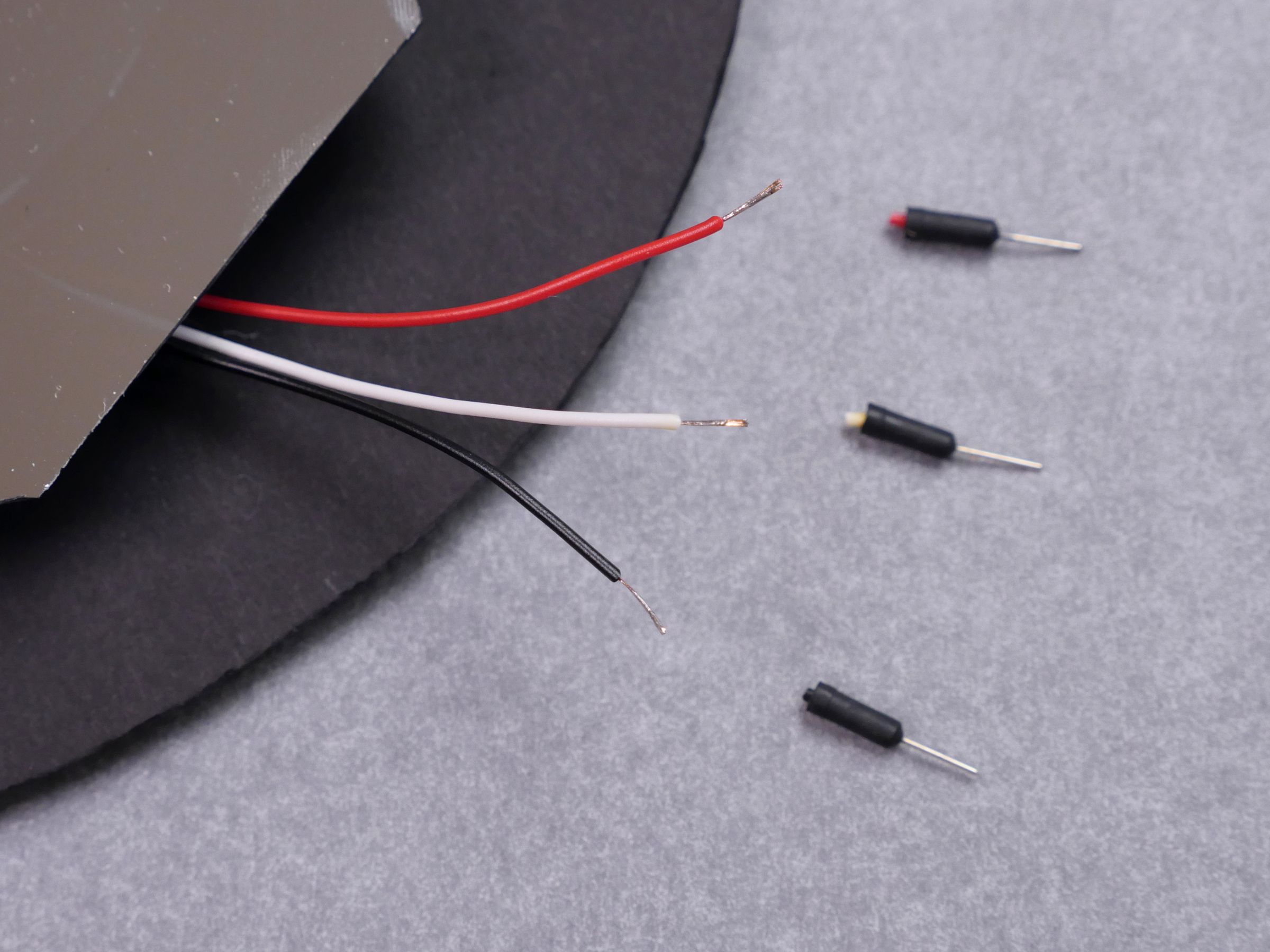

Route the NeoPixel strip's wires through the small gap on the mirror rim, and glue it to the interior. Optionally use a clothespin to clamp the strip while the glue cools. Try to avoid getting hot glue on the mirror, but if you do it's ok! A little rubbing alcohol will release its hold on nonporous surfaces like glass.
Clean your work area to remove dust and bits of foamcore. Use a lint free cloth to wipe the mirror completely clean, then grab your see-through mirror and peel the protective cover from one side. Apply a small amount of glue at four points around the inner wall (keep your glue gun motions from dragging over the mirror to avoid stray strands), and glue the see-through mirror in place. Now your reflective surfaces are sealed and protected from dust.

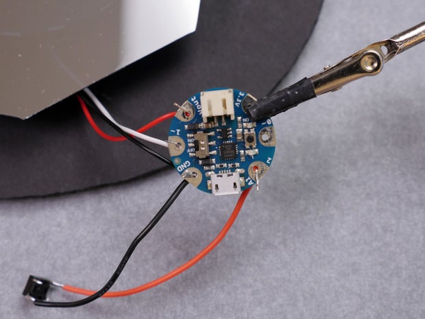

Step 7: Solder Circuit

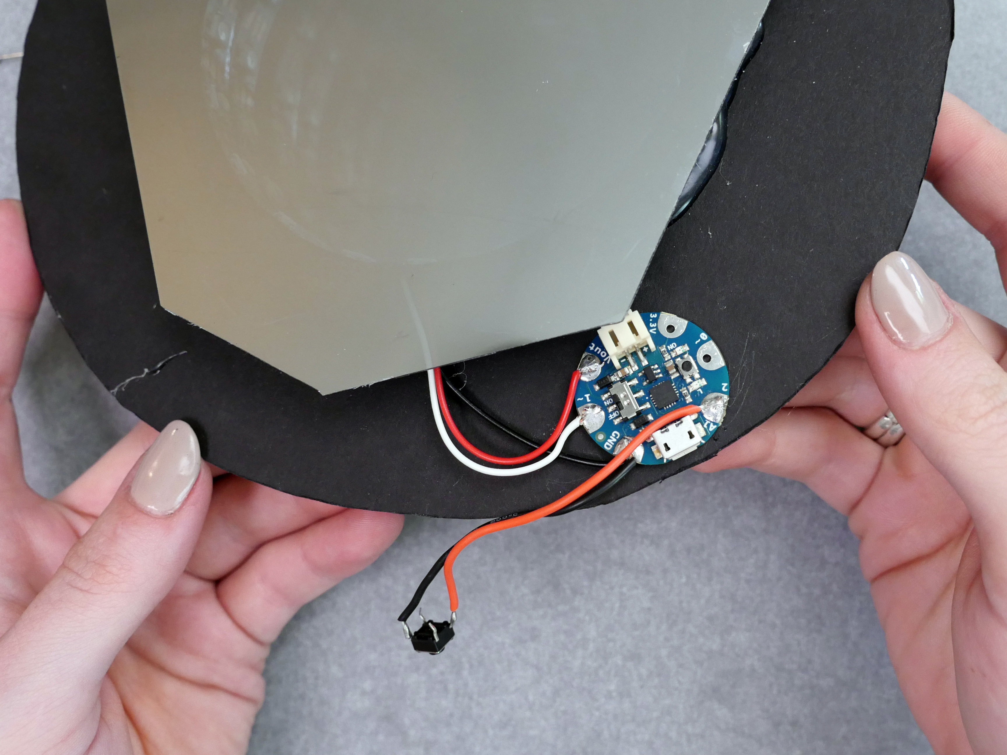

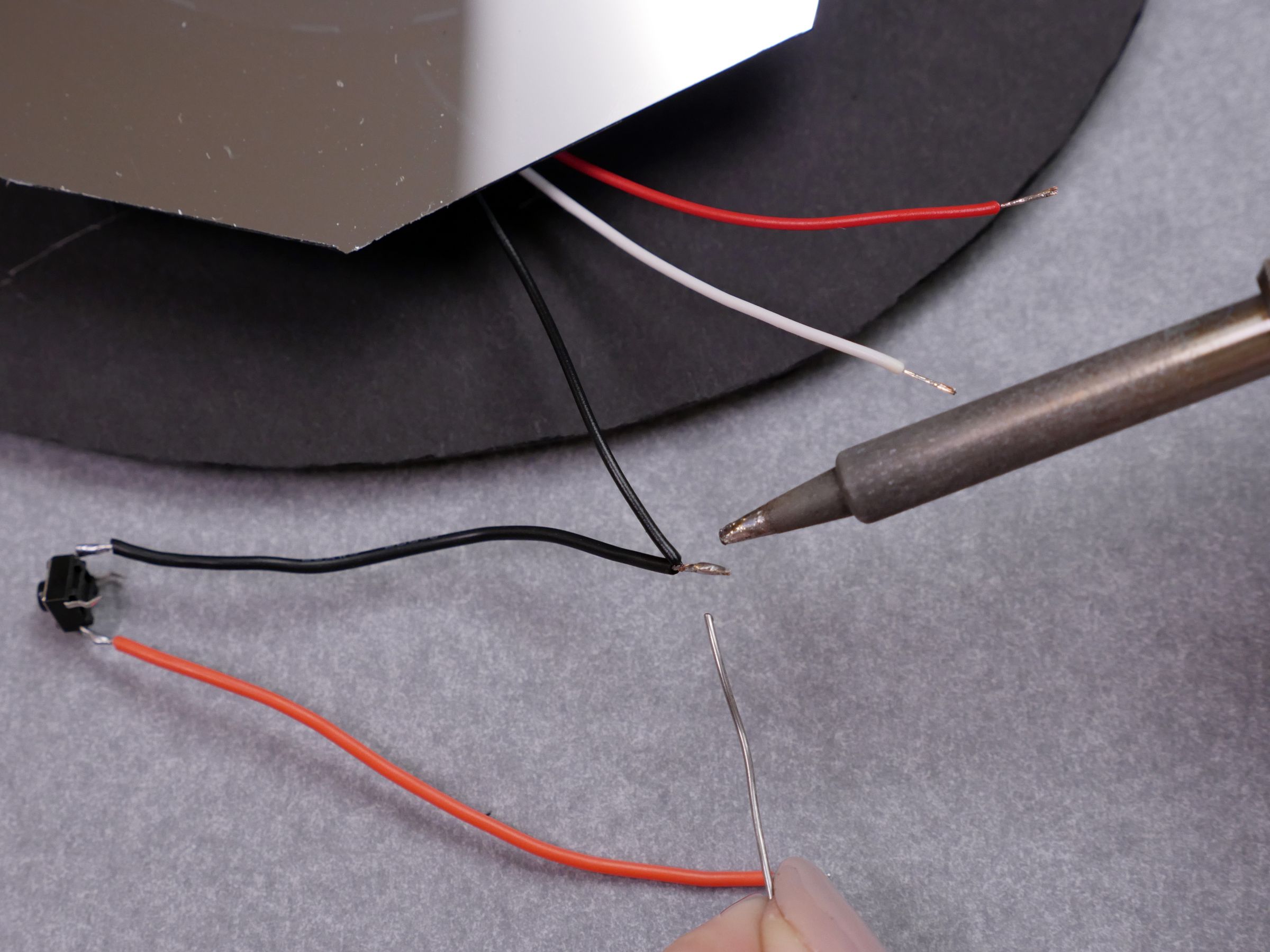

To run the circuit with your Gemma, we'll solder the wires directly to the pads on the board. Snip off the breadboard connector and strip, twist, and tin the leads of the NeoPixel strip wires. Solder wires onto diagonal leads of a pushbutton in the same manner (you can use the button from the soldering lesson). Twist and solder together the two ground wires.
Gemma's large holes make it easy to assemble this circuit with no additional parts— just thread the tinned wires through the holes and wrap the excess around the solder pad. The connections are as follows:
- NeoPixel 5V -> Gemma Vout
- NeoPixel Din -> Gemma 1~ (digital pin 1)
- NeoPixel GND -> one side of pushbutton -> Gemma GND
- other side of pushbutton -> Gemma 2 (digital pin 2)
Set up your circuit board in a third hand tool and heat up the connections with your soldering iron before applying some more solder to engulf the pad and wire. After all the connections cool, trim away excess wire with your flush snips.

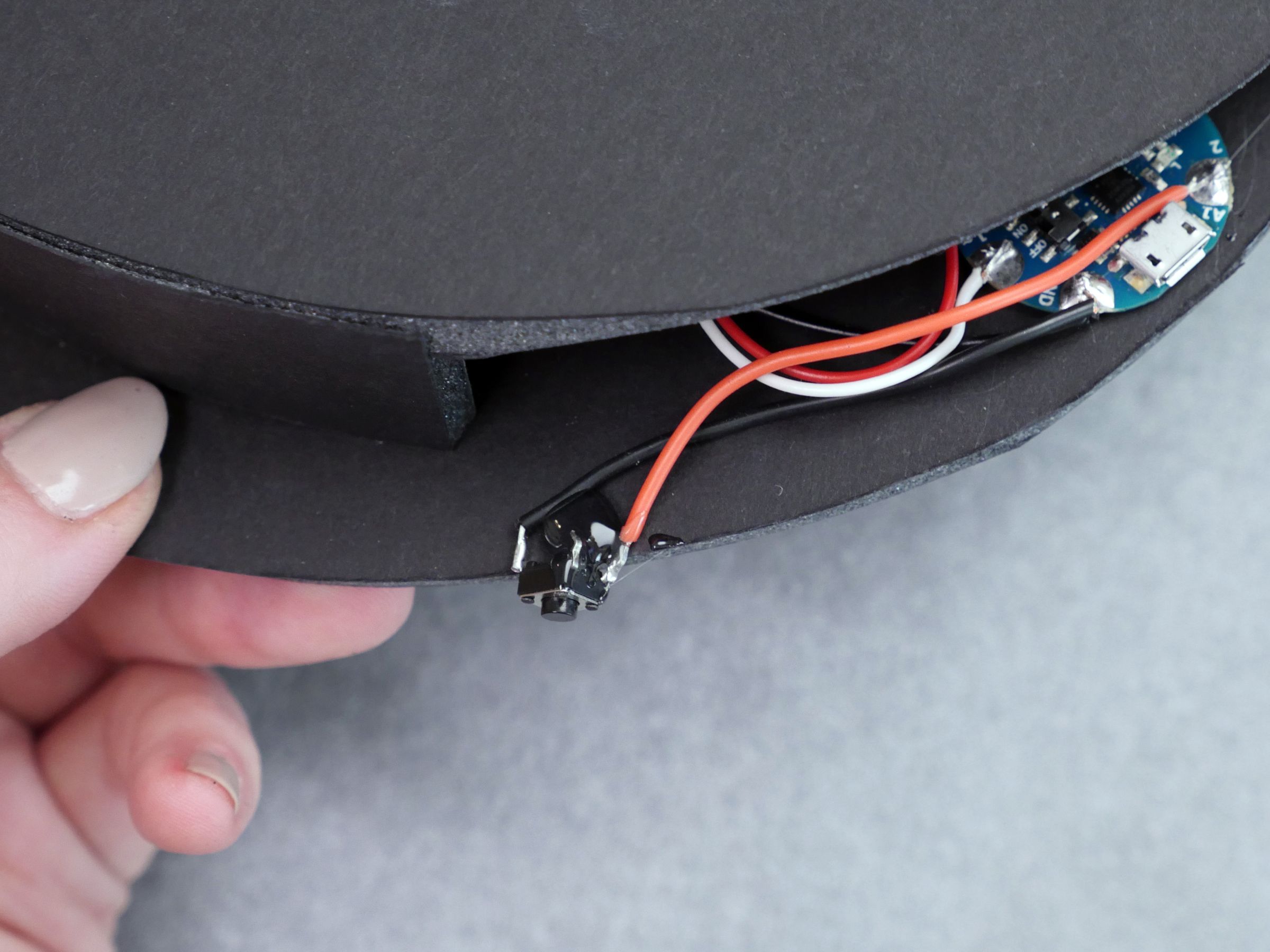

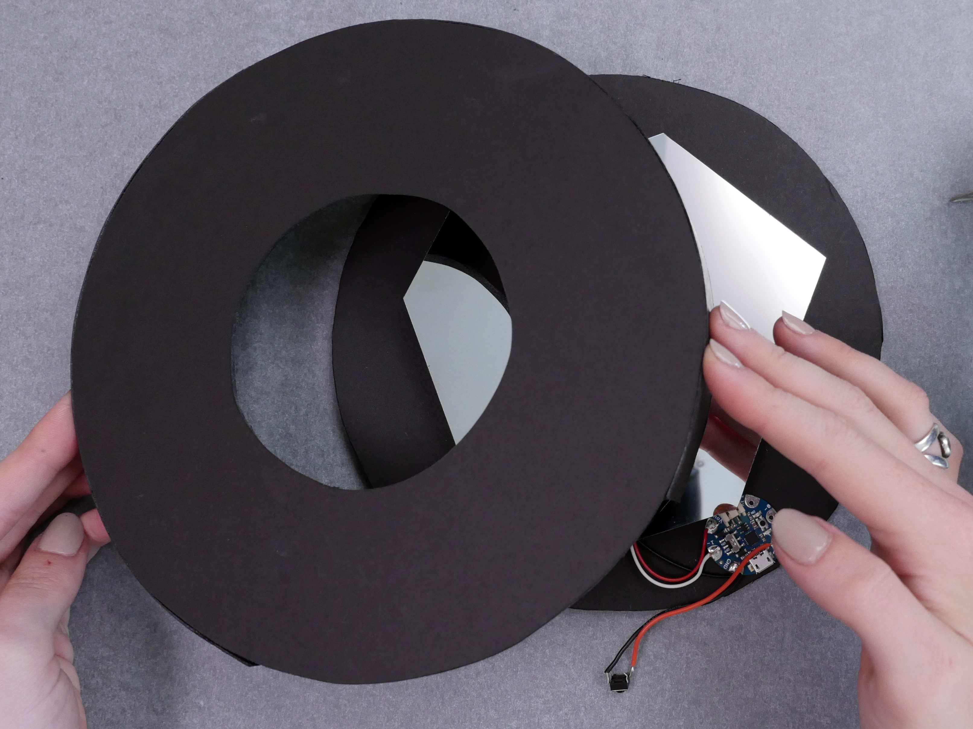

Hot glue your Gemma in place with the USB port facing the edge of the circle.

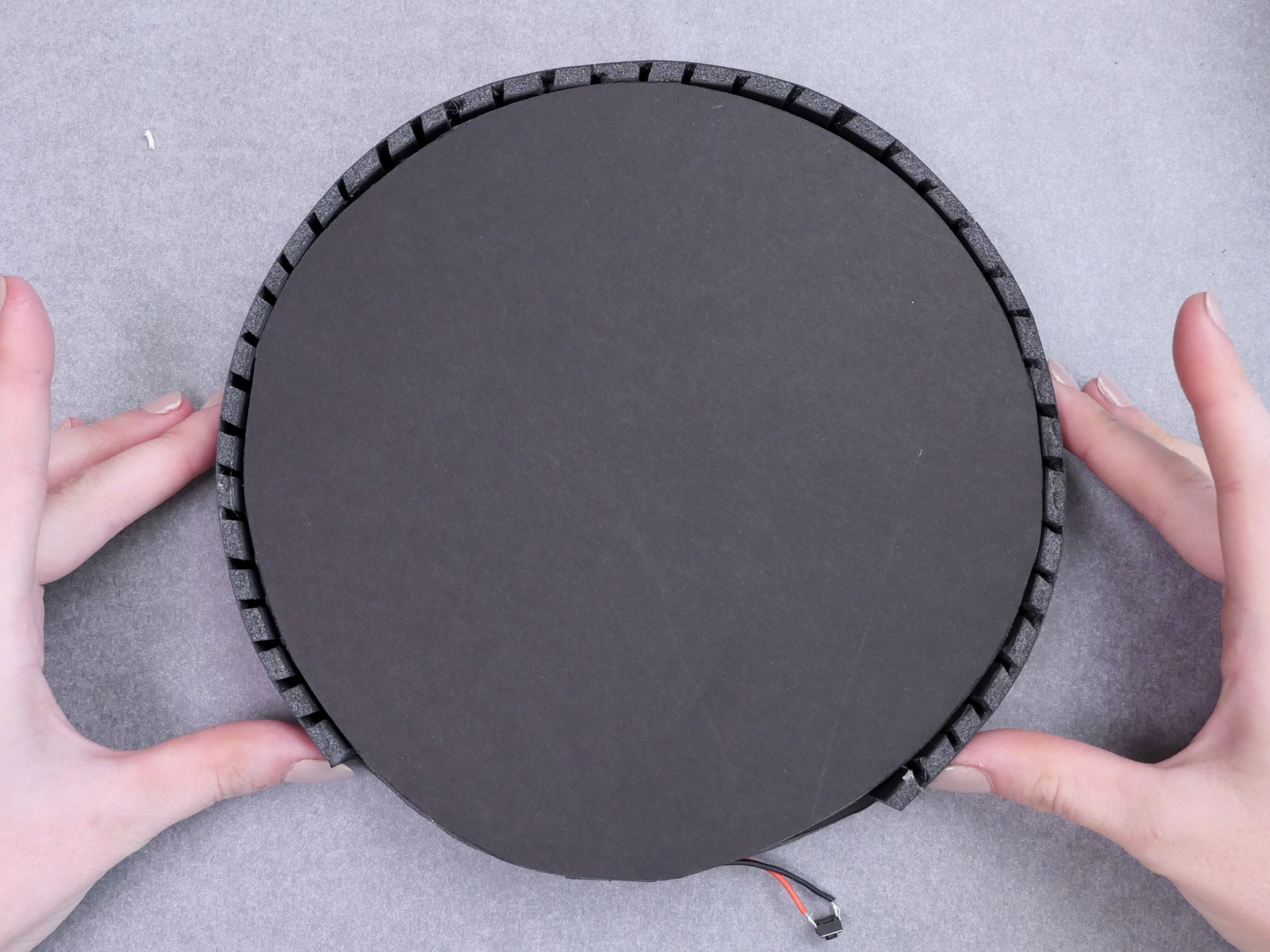

Apply the front/top cover and manipulate the edge to seat the pieces together cleanly. You may have to trim your bottom circle just a bit to make it fit, and likewise pull the edge open to accommodate its mate. Glue the pushbutton in place wherever you like.
Step 8: Use It!
Plug in a USB cable, press the pushbutton, and enjoy! You can switch up the colors and animations by changing the code. Use a USB power adapter if you want to mount it on a wall. At this point you can make another small foamcore edge piece to close up the remaining gap, if you wish. Some suggested uses: hang it on your wall, keep it at your desk, give it to a friend!
You can easily run this project with an internal battery instead of connecting a USB cable. The orientation at which you glue the Gemma will determine the access to the battery port, so you may want to re-glue it at a different angle. 19 RGBW pixels times 80ma max current draw (plus ~10ma for the Gemma) equals 1530ma, which means we technically need a battery with at least that many mAh. However the code for the mirror doesn't come close to using all four pixels' LEDs at full brightness together, so in reality the maximum current draw is far less. A healthy battery compromise is a 1200mAh rechargeable lipoly battery.
