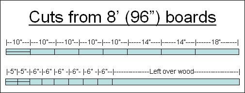

Step 2: Making the Cuts
The first step is to cut the boards to the desired lengths, as shown in the diagram below. All in all, you will need to cut the following board lengths:
(2) 5" long pieces
(4) 6" long pieces
(5) 10" long pieces
(2) 14" long pieces
(1) 18" long piece
For the supports on the back of the clock and sconces, simply rip (2) 5" and (1) 10" pieces (from the list above) down the middle to make (4) 5" x 1.25" and (2) 10" x 1.25" pieces. My boards came in 8' lengths, so I cut mine according to the 2nd image below to minimize scrap wood.
