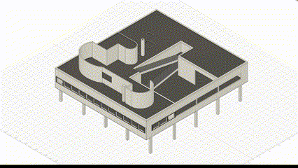

To 3D-Print your building, you need a model of it. Any famous building already has a bunch of models that people already made, so you can download one for free (or for a small fee) from Sketchfab, 3D Warehouse, Free Polygon, etc. I found a model on Free Polygon, but the Villa Savoye has a lot of overhangs, so it's not very 3D-printer friendly. My building for my assignment had to be sized about ten inches by ten inches (thankfully my printer has a large print bed), so that would take forever and waste a bunch of filament with all the supports. Plus, I only had to make the outside, so 3D-printing the interior would be a waste of time as well. For those reasons, I decided to make my own 3D model in Fusion 360 (as opposed to using the mesh from Free Polygon) so I could split it into layers and only print what was necessary.
If you make your own model, remember to minimize overhangs (or if the overhang is quite large/important, just split your model into layers like what I did). Also make sure you split your model into halves or quarters if your print bed isn't big enough.
I easily recreated the Villa Savoye by importing the file I found on Free Polygon into Fusion 360 and just sketching over top it. I wasn't too concerned with making everything super detailed. I've attached my Fusion 360 file to this step in case you want to make the Villa Savoye as well.
