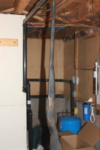

I did some research on stock refinishing and most suggest that you use paint stripper, or Krud Kutter, or Easy Off Oven Cleaner, or other things to take the old finish off. I don't have a garage, and I didn't want to make a huge mess in my basement, so I just sanded the old finish off with 80 grit sandpaper, followed by 100 grit to smooth it out. You can use a palm sander to make this very easy, but be careful not to alter the shape of the stock. When you are done, it should look roughly like the photo attached. If you wish you can use a hairdryer to assist in removing the old finish. I have heard this can help, but I didn't do much for me.

Use your rope/wire/string to hang your stock while you paint it. This allows for easy painting of all sides of the stock without waiting for one side to dry before starting the other.
While spray painting, keep the nozzle about 15 inches or so from the stock and make light passes. This limits runs in the paint. I did about 5 or 6 coats.
