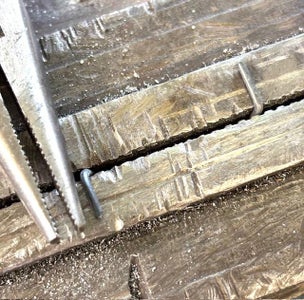

Step 1: Bend the Wire
Mark the center of the wire's length. Bend it over a 1/4 inch rod to make about a 45 degree angle.

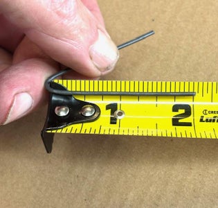

Step 2: Make the Ends Equal in Length
When you bent the wire in the previous step, it may be that one end is slightly longer than the other. Measure and trim the longer end so it is the same length as the shorter end.

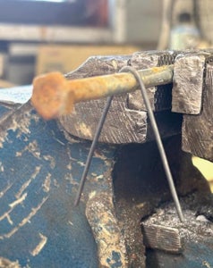

Step 3: Put the Wire in a Vise
Place the bent wire between the jaws of a vise so the ends extend upward beyond the top of the vise jaws about 1/4 to 3/8 inch. It helps a lot if the vise jaws are aligned well and at the same height. Make the vise jaws almost tight, but not quite. You want the amount of wire extending above the jaws to be equal on both ends. I used the solid end of a drill bit as a gauge. I was able either to pull a little wire up with the jaws of a pair of pliers, or to tap a wire end farther down into the vise with a hammer. After adjusting one end of the wire, check the other end to be certain it has not moved. Tighten the vise jaws so the wire cannot move after the ends are aligned.

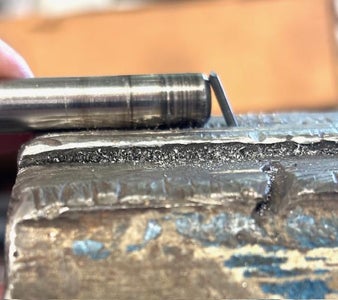

Step 4: Bend the Wire Ends
Bend the wire ends over on the jaws. Make one bend toward the front of the vise and the other toward the back of the vise. This will help to keep the mower blade more stable when balancing it. The needle nose pliers were used to adjust the bends so they are at a right angle to the opening in the jaws.

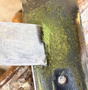

Step 5: Clean the Blade
I prefer to clean build-ups of dried grass from the blade before balancing it. Use a wire brush or a putty knife.

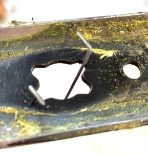

Step 6: Place the Wire in the Blade
The photo shows the shape of the opening for mounting the mower blade on the engine shaft. I place my bent wire balancer into the opening from the bottom so the corner of the bend will be above the top of the blade. Pull the bent wire balancer so the wire balancer is in as far as it can go.

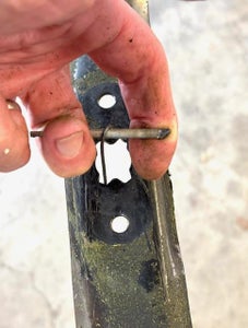

Step 7: Hold With a Nail or Smaller Short Rod
Place a nail through the bent peak of the wire balancer. Hook two fingers to cradle the nail. Pick the blade and balancer up. Take note to see if the blade is level, or if one end dips appreciably. I watched some videos of people using the new ball bearing balancers. I was surprised how much dipping was allowed and the mower blade was still considered as balanced. I like my blades to be as close to level as possible. If you want to check your work, give the wire balancer tool a half turn and see if the blade rests in the same place when suspended.
