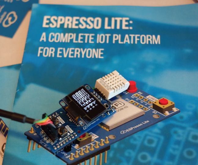

As the designer of the Espresso Lite V2 board, we are happy to introduce some user-friendly features that takes the headache out of novice learners. In this instance, we make it easy for anyone who are relatively new to working with the individually-addressable RGB NeoPixel (WS2812) RGB LED strips (or rings).
There are only three connections that require our attention: 5V, GND & input PIN. For this example, we will assign pin 12 of the Espresso Lite V2 as the input pin to the LED strip.
